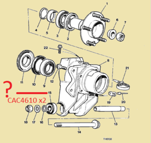

A quick check to rule out is the hub nut, (#7 1st image) it's a special thing and shouldn't budge but I've seen them back off once or twice on XJR's, and create what feels like diff play - remove the wheel and you can see a plated nut in the centre of the hub, check it with a torque wrench.

I've been going off those diagrams already, I checked the highlighted roller bearings and didn't see any play when moving the wheel by hand.
