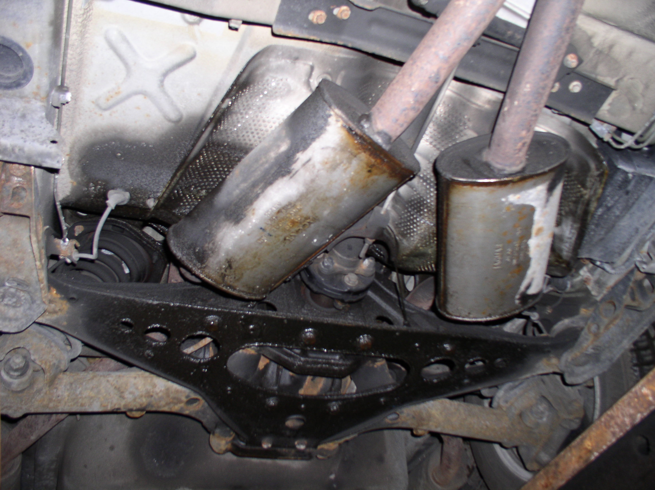

I agree that the quality of Jaguar stainless steel is abysmal. Here are the intermediates on my 2001 X308 photographed at five years old:
Factory Parts Contact/Warranty?-05-suspension-rear.jpg
The results of a combination of our wet climate and road salt in Winter but that corrosion was unacceptable to me on a five year old vehicle.
These were subsequently replaced with heavily discounted items from Jaguar and the work was completed without any other disassembly. The leaking diff that can also be seen in the photo was a different and considerably more expensive matter!
