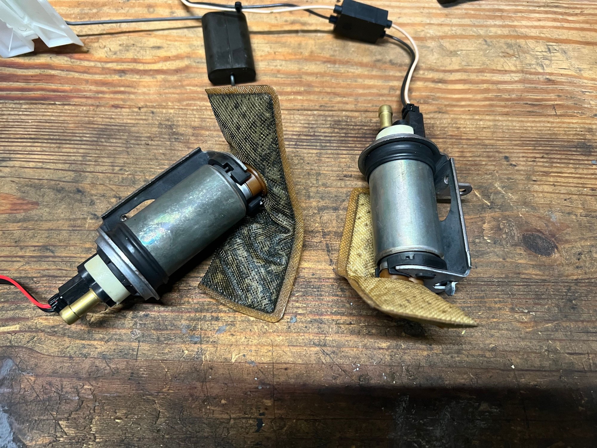

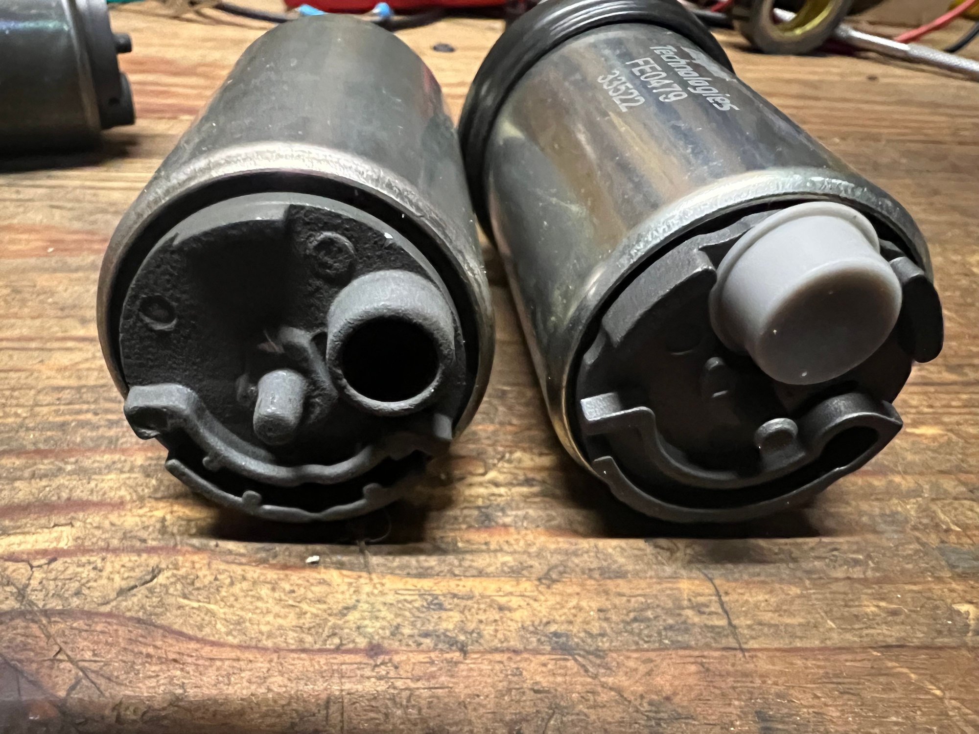

[img alt="Old URO right, new Delphi left
Bottoms different "]https://cimg4.ibsrv.net/gimg/www.jaguarforums.com-vbulletin/2000x1504/img_2166_33943b07f26271e3a7743b224fe0c3138203b2bf. jpeg[/img]
Old URO right, new Delphi left Bottoms different

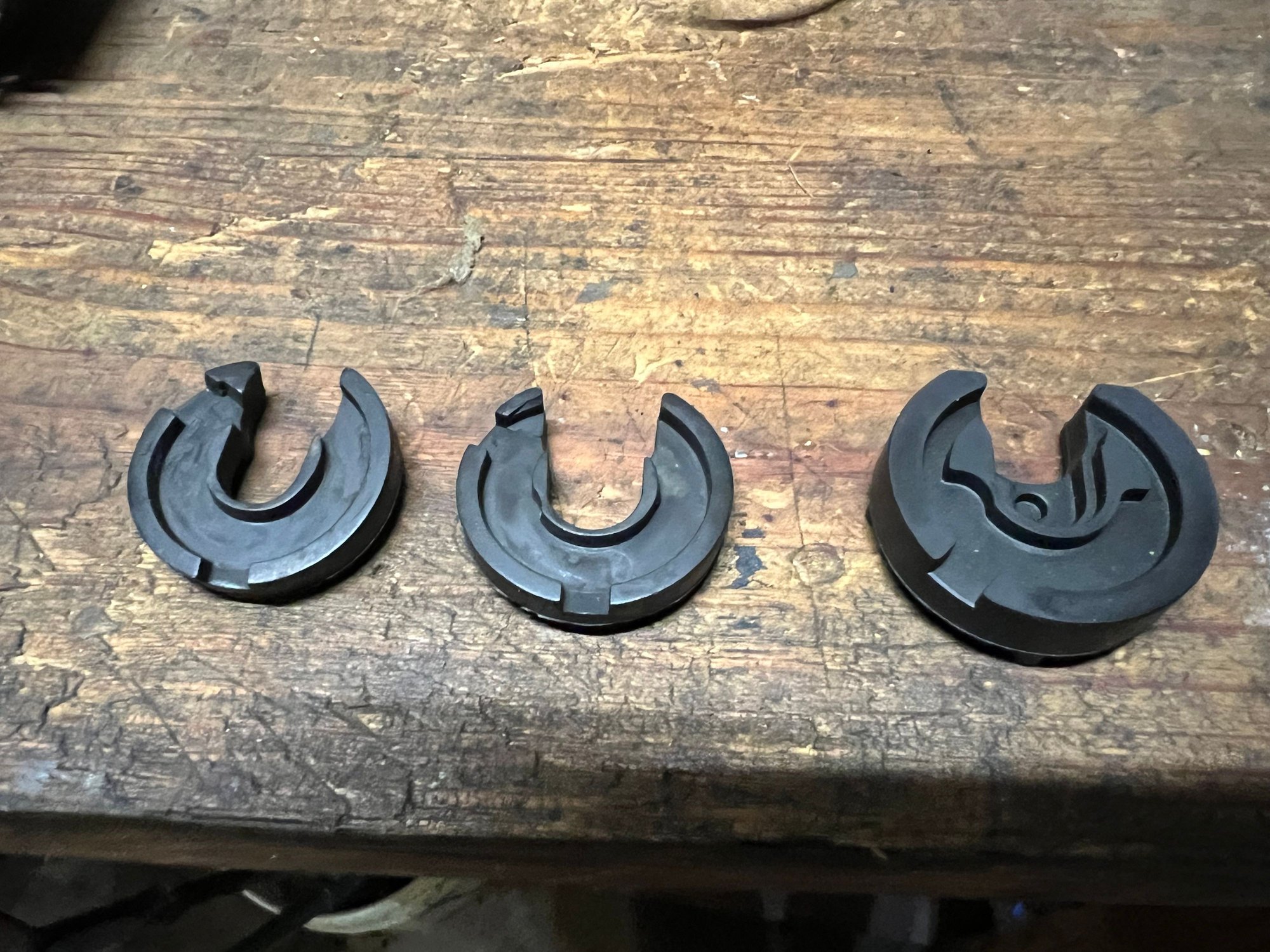

[img alt="Bottom pads
Right - original that exactly fits URO
Center - original with trimmed rubber to fit Delphi
Left - Delpi supplied, way to thick to fit in holder and too big"]https://cimg5.ibsrv.net/gimg/www.jaguarforums.com-vbulletin/2000x1504/img_2163_9c05856f3ec9f0e6ef8b782d16d44b741a343592. jpeg[/img]
Bottom pads Right - original that exactly fits URO Center - original with trimmed rubber to fit Delphi Left - Delpi supplied, way to thick to fit in holder and too big

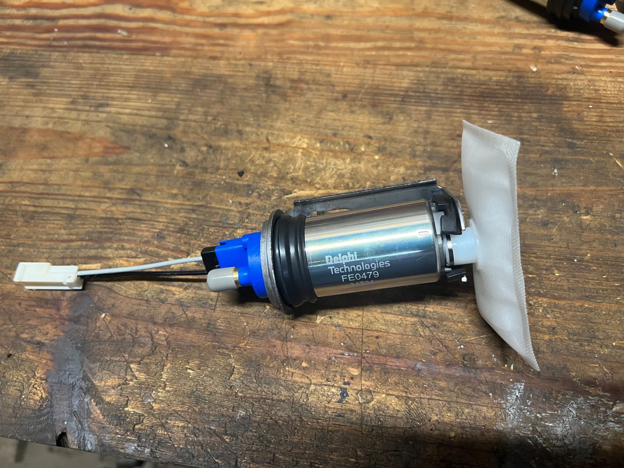

Additional connector to mate with Jag wiring

Pics did not load in last post.

that pump doesn’t have a barb, it’s gonna blow off on you been there done that. the only barbless fuel pumps you can use are ones with plastic nipples
Big thanks for catching that. Don’t want to have to drop tank again. Looked at pics of pumps on RockAuto. Only URO has barb. Either sending pumps back or going to use some gasoline resistant glue in addition to clamp.
