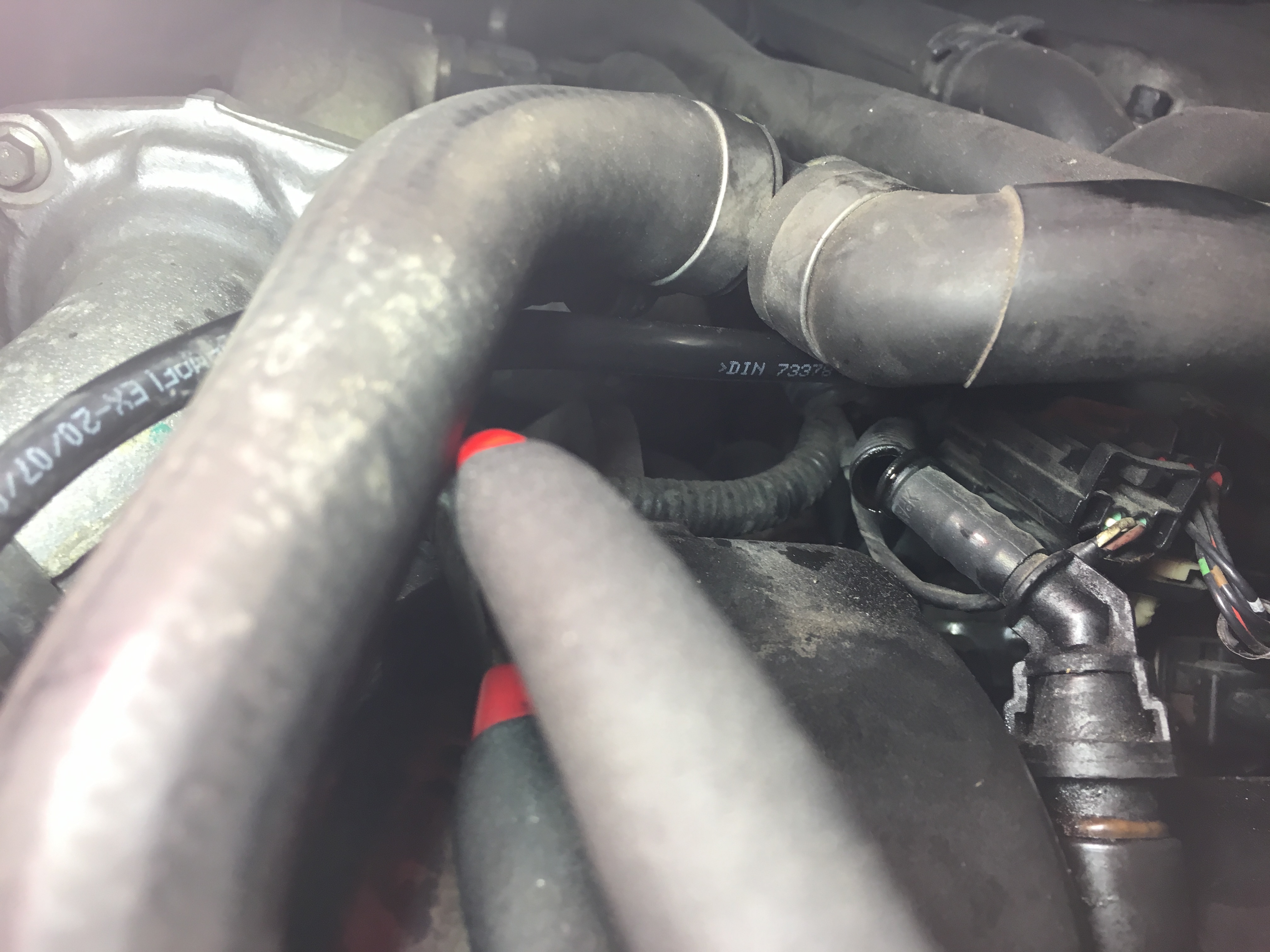

I was replacing my valve cover gasket and trying to take off this hose and twisted it then broke it. Is this a breather hose? can i just tape it over and drive the car while I go to the Jag dealer and look for a part? Please help. Where is this connected to?

I have used a short rubber hose with some silicone sealer around the edges until I got it replaced.

Rescue tape (a specific brand of self adhesive, stretchy and strong high-temp tape you can get at hardware stores) can work. I have not used it for more than 5kmiles on this breather tube, so I don't know how permNent it is in practice, but it does work if you can keep the tube fully connected w/o blockagre when doing it - this is not easy as the tape requires a lot of tension to stick, but it is possible.

That is your part load breather on the "camshaft cover," not "valve cover."
After you fix it, you should remove it and clean the orifice with an appropriate size drill bit whenever you change the oil.
To remove it without breaking you need a special tool shown on page 3 in the PDF below or you can use small needle nose pliers.

You're looking for the Part Load Breather Hose part number AJ84880.
I purchased mine thorugh SNG Barratt.
