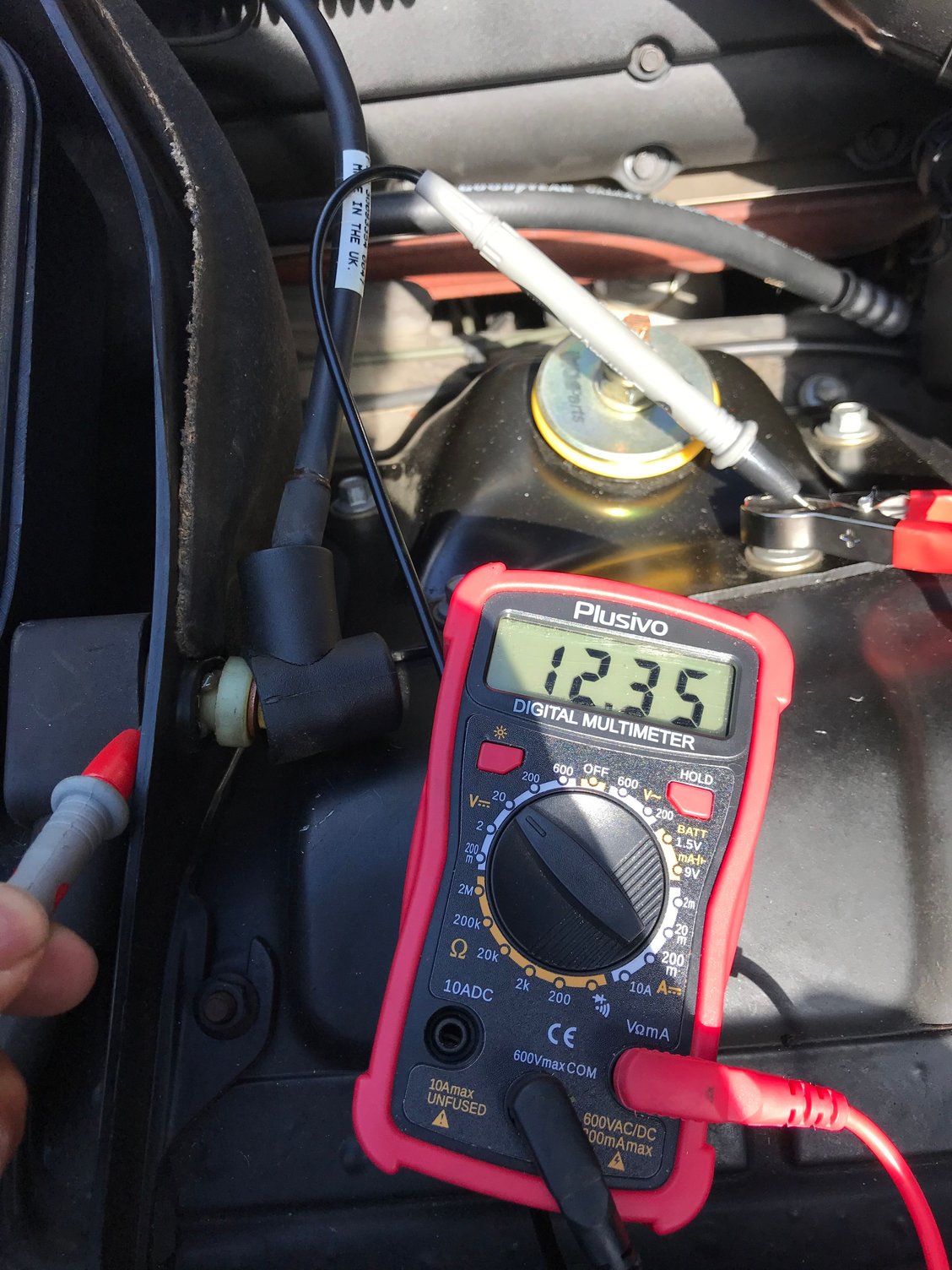

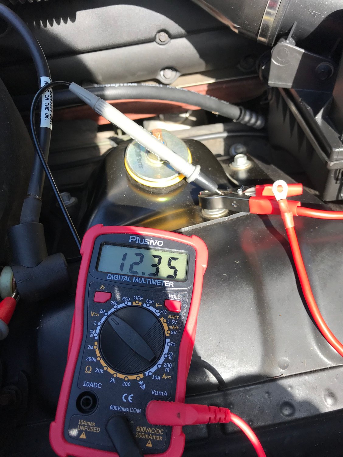

I hope I did the light test right. It was the same brightness at all studs. Even the starter stud.

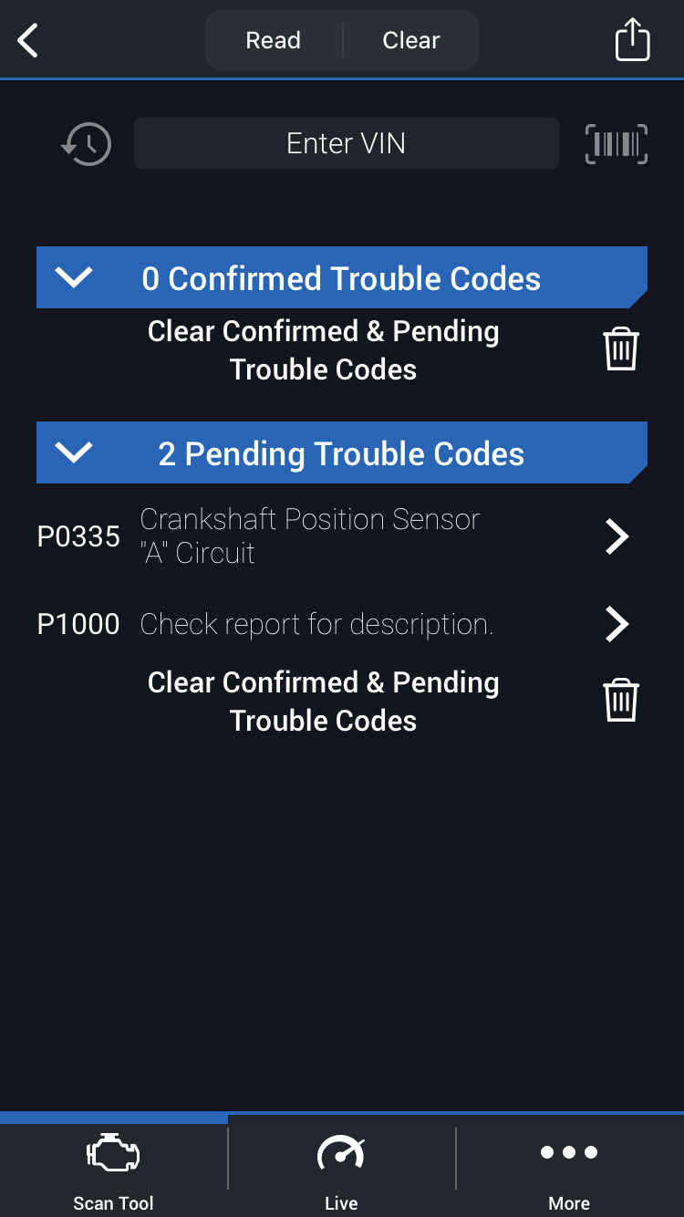

The p0335 code was present when I first pulled the codes when problems started. It was cleared but came back later. Will keep updated.
Here are some other codes which came and went. At the moment no codes present.

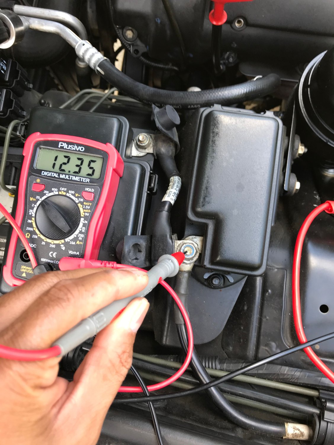

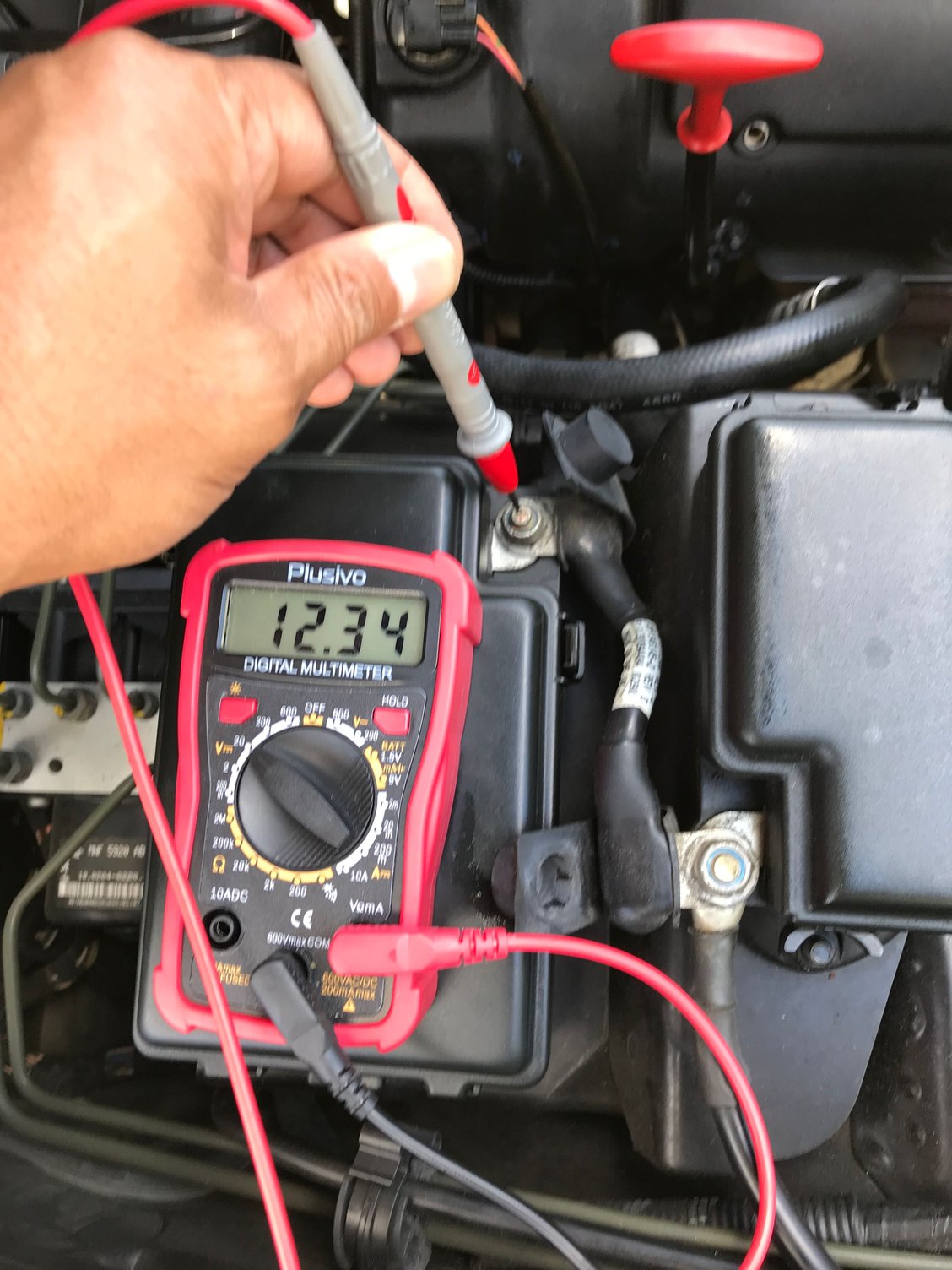

Some updates. The car ran for couple days beautifully. Yesterday restricted performance light came on.
Did not start today. Checked battery and it’s 11.5 volts.
That was the issue to start with and that’s why I pulled alternator and tested at auto zone. Brand new battery as well.
it seems all other issues are not related.
please let me know what you think. Only code p0335 showing again.

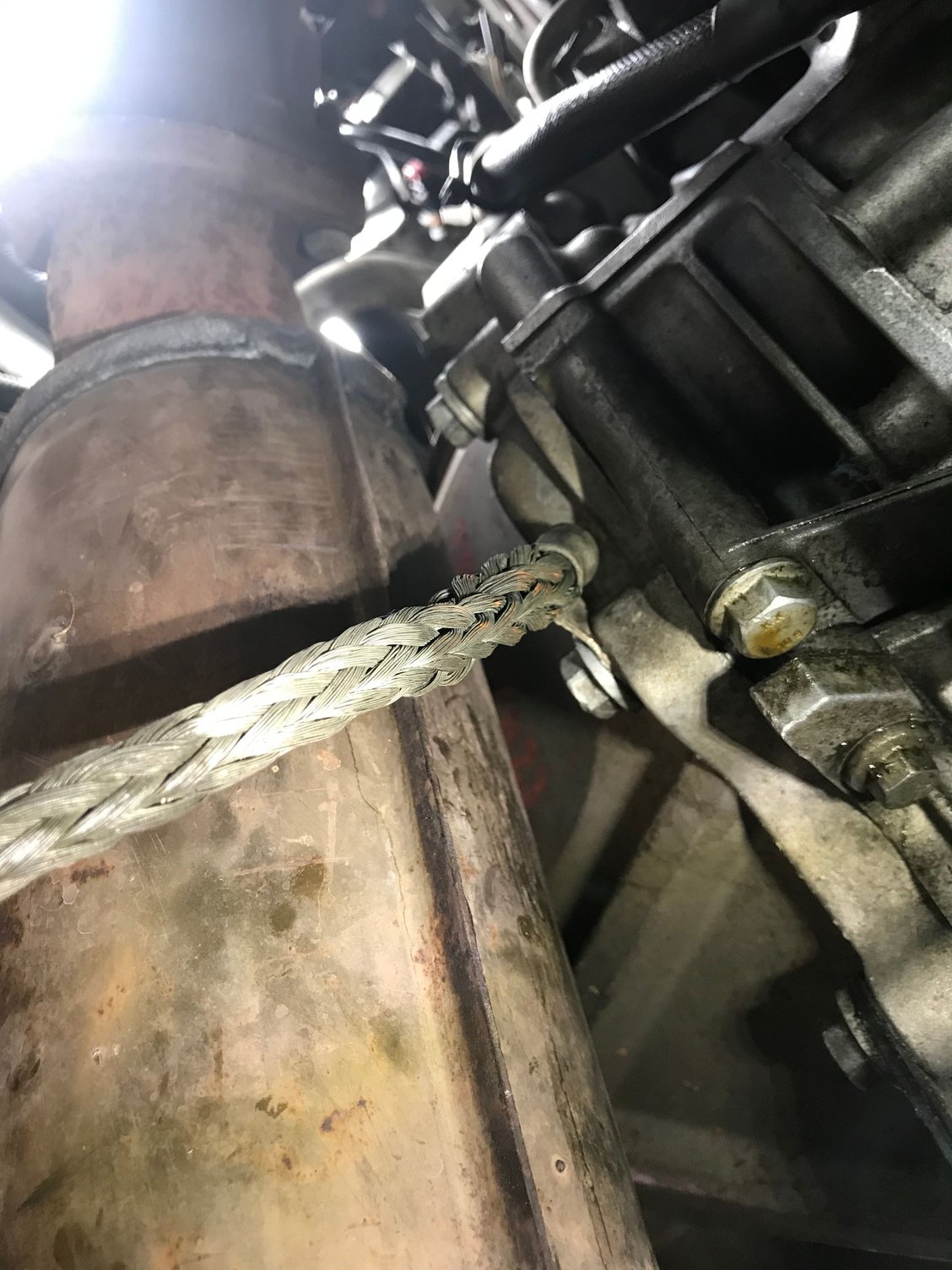

Ground cable. Seems good to me

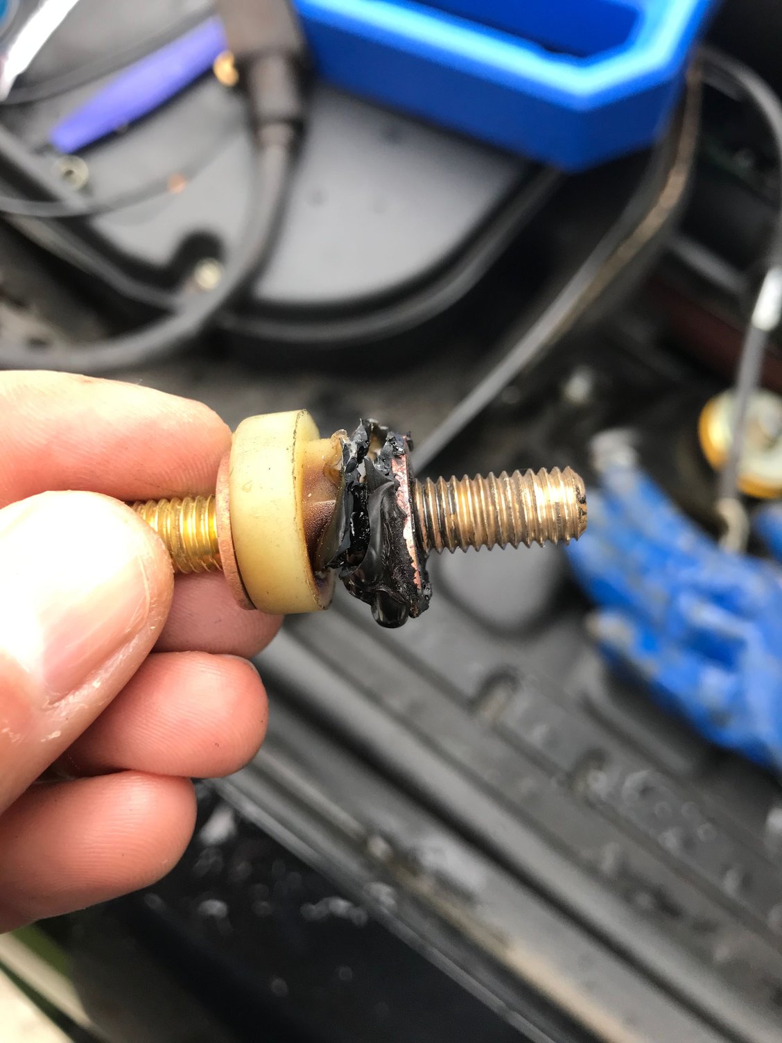

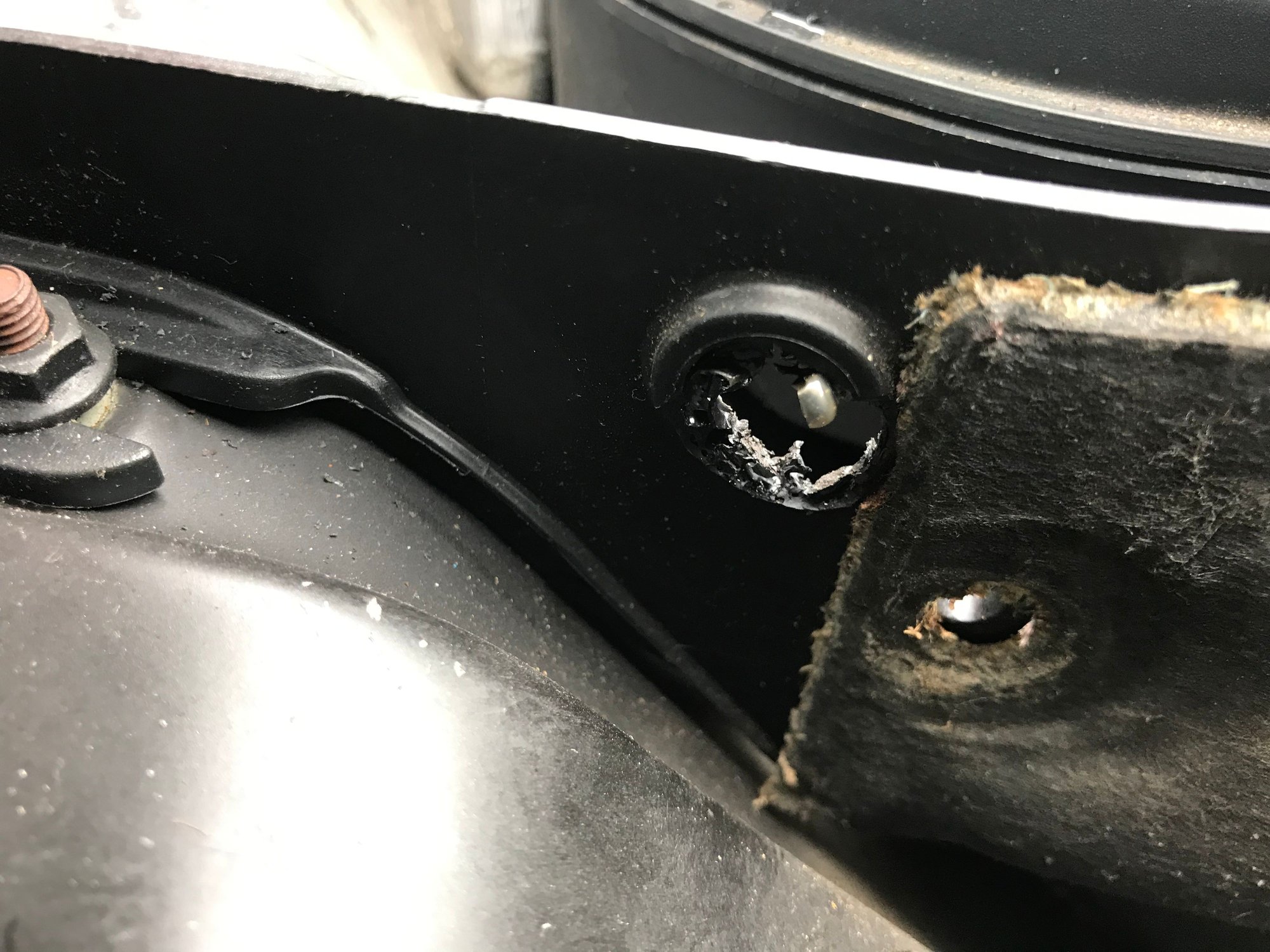

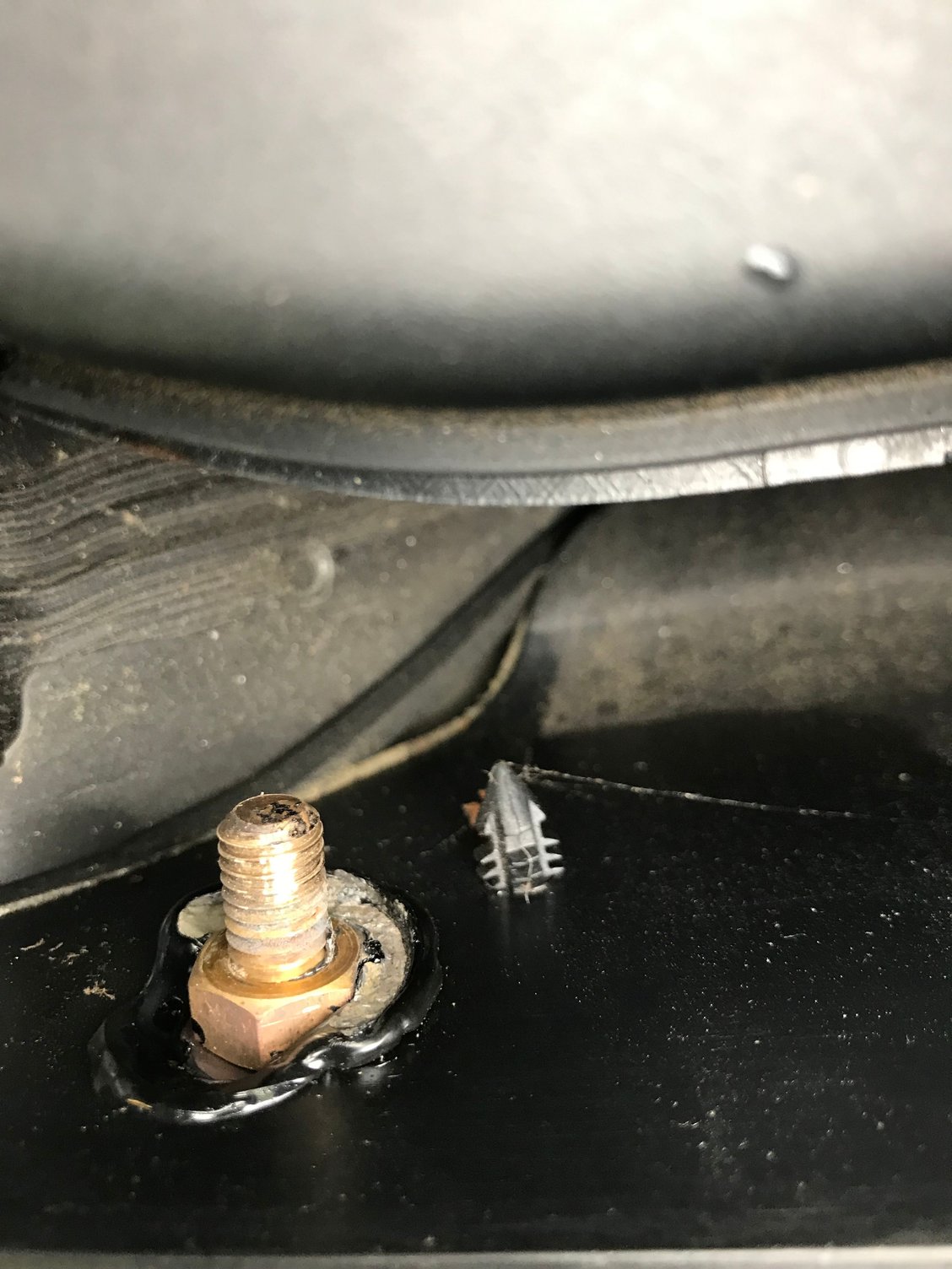

Quick update. It’s a little embarrassing but I hope will help somebody in future.
the fact that brand new battery was under 12 volts and suggestions that ground might be at fault I started tracing all the main wires. Starting in the trunk and removing big fuses. They were fine.
Next I decided to completely disassemble the bulkhead stud connector.
I will let pictures tell the story. Visual inspection and voltmeter did not reveal things hiding behind the bolts. Car started and working at the moment. Battery is getting around 14.4 volts. Before I was getting anywhere between 12.2 to 13 volts.
Thanks for all the help
