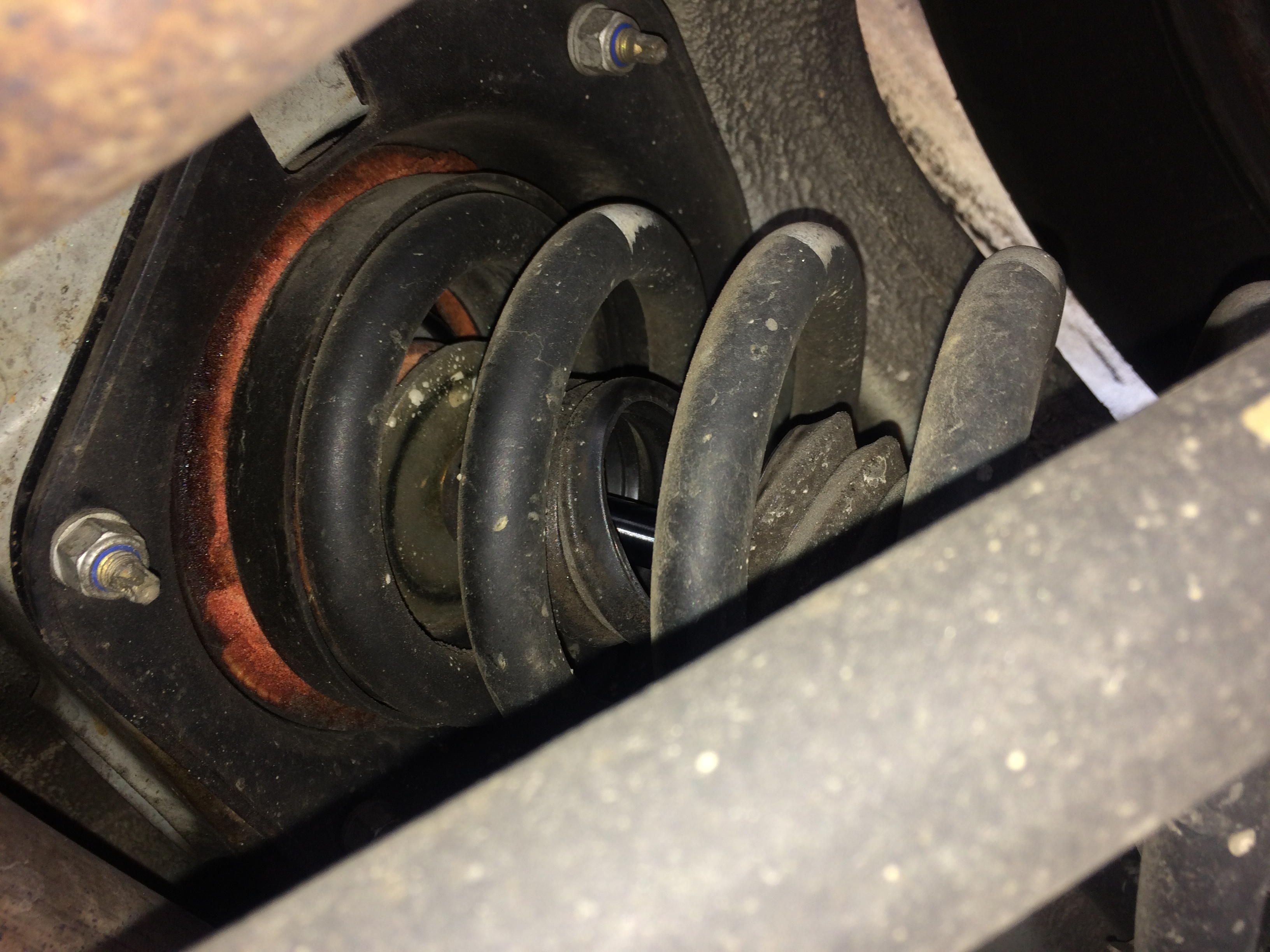

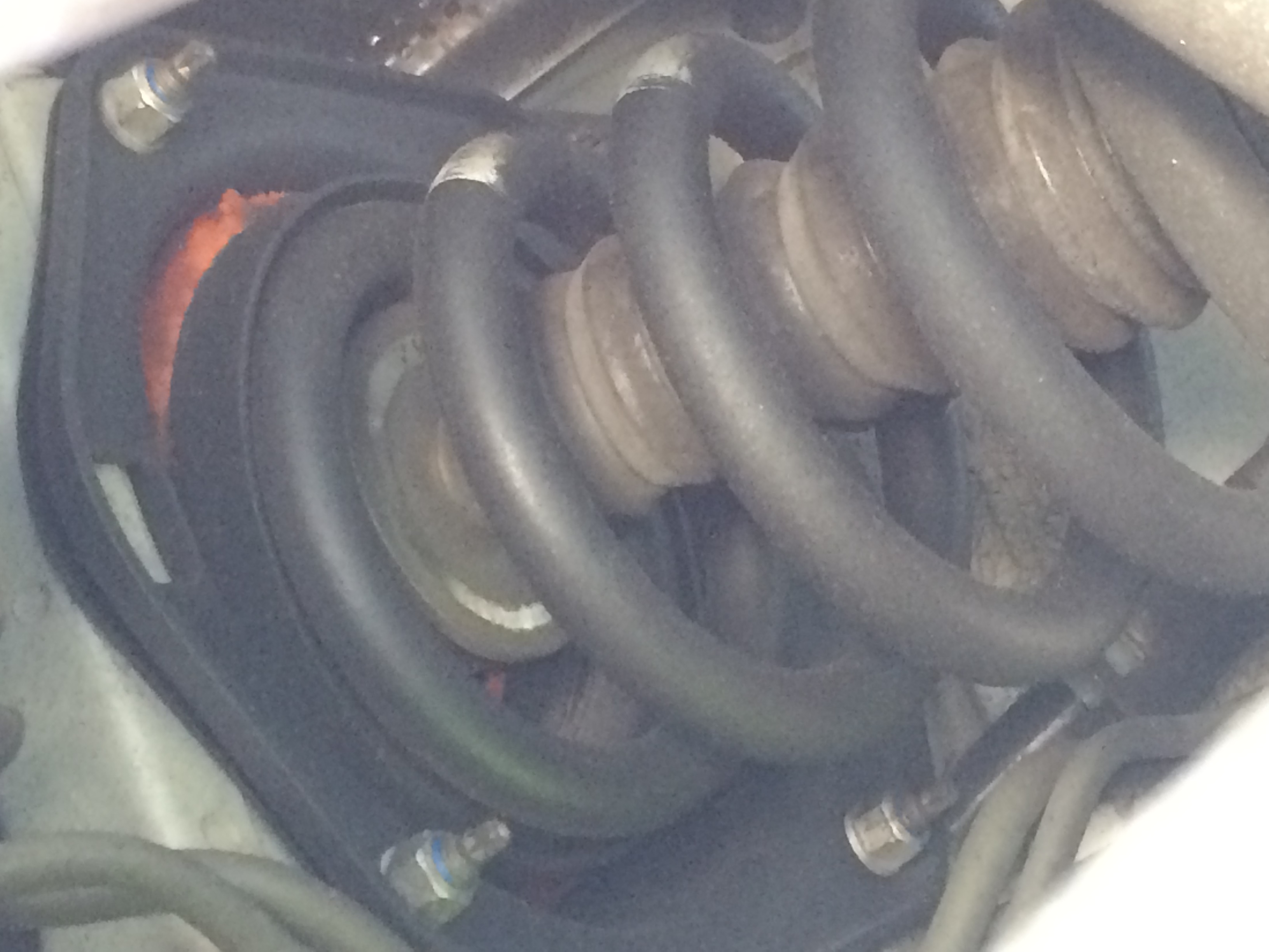

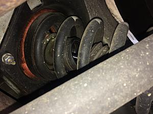

I think those upper mounts are about gone

Certainly looks like a viable culprit!

hmmmm, so i would need to replace the shocks and upper shock mount bushings?
Old Jun 8, 2018 | 11:13 AM
M. Stojanovic's Avatar
Joined: May 2017
Posts: 1,699
Likes: 897
Your shocks may still be good (mileage?) but you certainly need to replace the three foam "doughnuts" (small, medium and large) at the top. Another source of knocks can be the shock lower bushings which you can inspect when you have everything out.

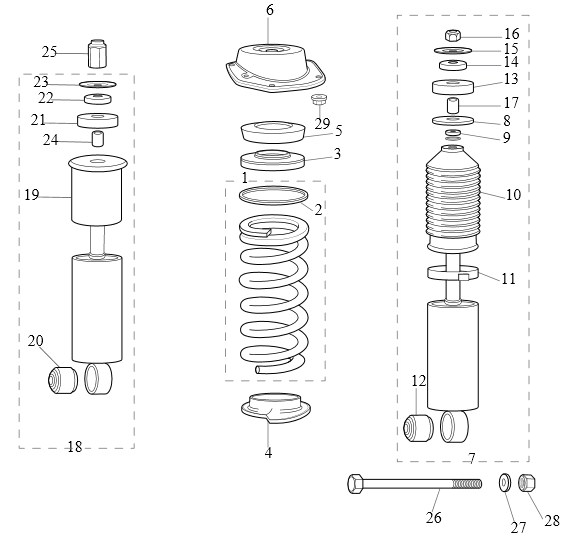

If you buy new shock absorbers (#7, you can choose comfort or sport), they will come complete with two smaller foams at the top so you will only need to add the items 4 and 5 shown on the diagram.
