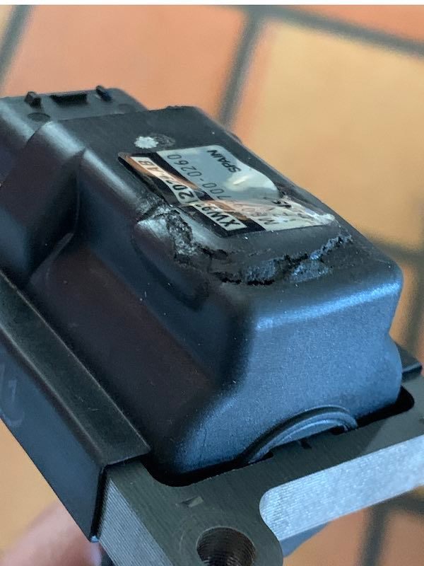

Old Nov 4, 2024 | 04:28 PM
xjeightist's Avatar
Joined: Oct 2014
Posts: 17
Likes: 9
From: southern california
Default Fried Ignition Coil Cylinders 1
Researching causes (wiring, bad plug)... the wiring seems okay, looks brand new. But the OBD didn't flash this until recently, after the car had been driven a half dozen times and about 200 miles. I replaced all the plugs (NGK). I did find oil - on the plugs on the passenger side. Which is making me wonder about a cracked gasket, given the age (22 years since build) of the car.
