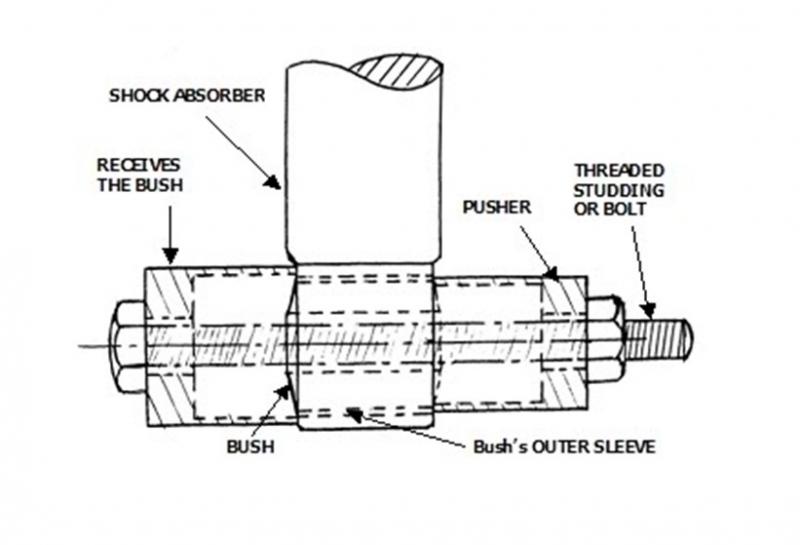

Anyone managed to change the bushes at the lower end of the shockers without the help of a workshop press?
I seem to remember replacing bushes in a vice before now, but these seem a little more 'stubborn'....?

Rich,
Guys on the XK8 section make an extractor with a bolt and tube:
Same principle should work on your X308.
Attached Thumbnails Rear shock absorber bush replacement-rear-bush-tool.jpg   Rear shock absorber bush replacement-shock-bush.jpg

Thanks Graham, I'll have a look at that.
I was kind of applying the same principle with my vice and 2 sockets, but the bushes seem extremely difficuly to shift - maybe I need to swing harder.

A workshop vice with sufficiently wide jaws will achieve the same result.
I've had to 'encourage' really tight ones out with a torch - and I don't mean a Maglite.

Excellent schematics....and performs the task admirably ;o))
When you disconect the bottom of the shock, you will need a pair of 'mole' grips to lock bottom of shock in place, otherwise it retacts up into the spring.
Give the bushing area a liberable dosing of release agent.
Assembly of new bush is reversal of removal....making sure that bush is central.

Got them! Sockets and a vice in the end.....

Its not necessary to remove the shock, which requires a lot of work. Simply remove the bolts that goes through the shock, raise the suspension and the shock will come out the bottom enough to remove the bushing. If you do not have the tool, use a ball joint removal tool to gut the bushing ( remove rubber and Teflon parts) leaving the outside sleeve. if you have a bushing that fits small enough to in the shock hole but large enough to catch the sleeve, you can use the ball joint tool to remove it. If nit, use a hacksaw and cut the sleeve then drive out with a chisel. Using a socket and ball joint tool press in the new bushing.
I have done both my rear shocks this way. Took me about 1.5 hours a side with all the messing around to find the right size socket to push in the new bushing.
