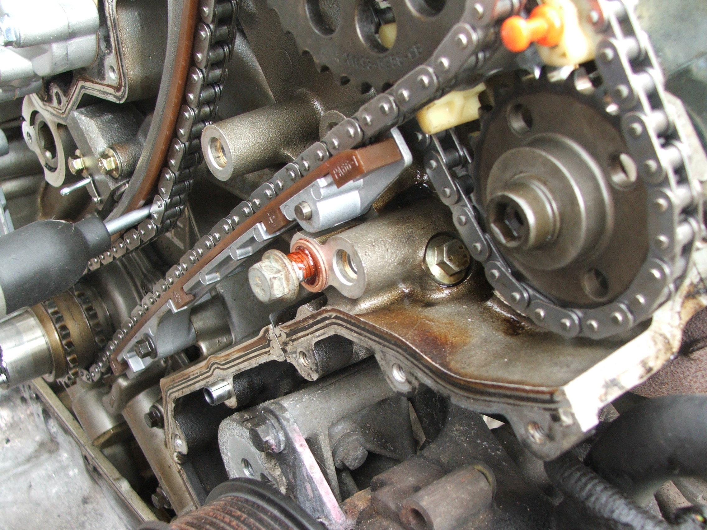

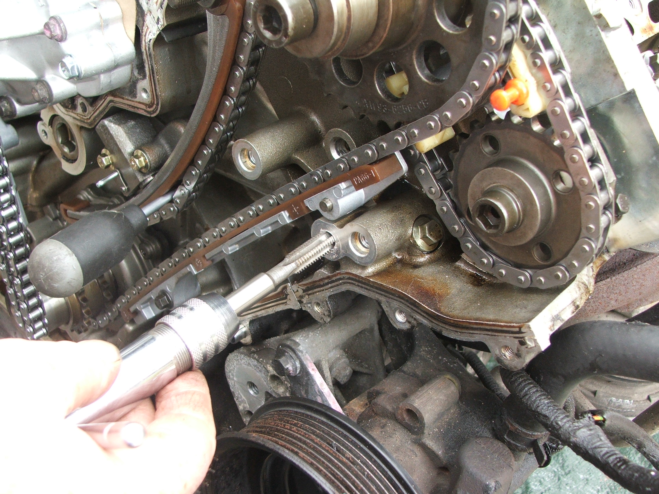

Originally Posted by BobRoy
All I need to do is remove the VVT from the intake cam and install the sprocket from the S/C head.
Yep. I carry out what Bob's TSB says...
Tap the gallery
Insert bolt, copper washer and a dab of threadloc
Done
Attached Thumbnails sc heads on na block-dscf5561.jpg   sc heads on na block-dscf5562.jpg
