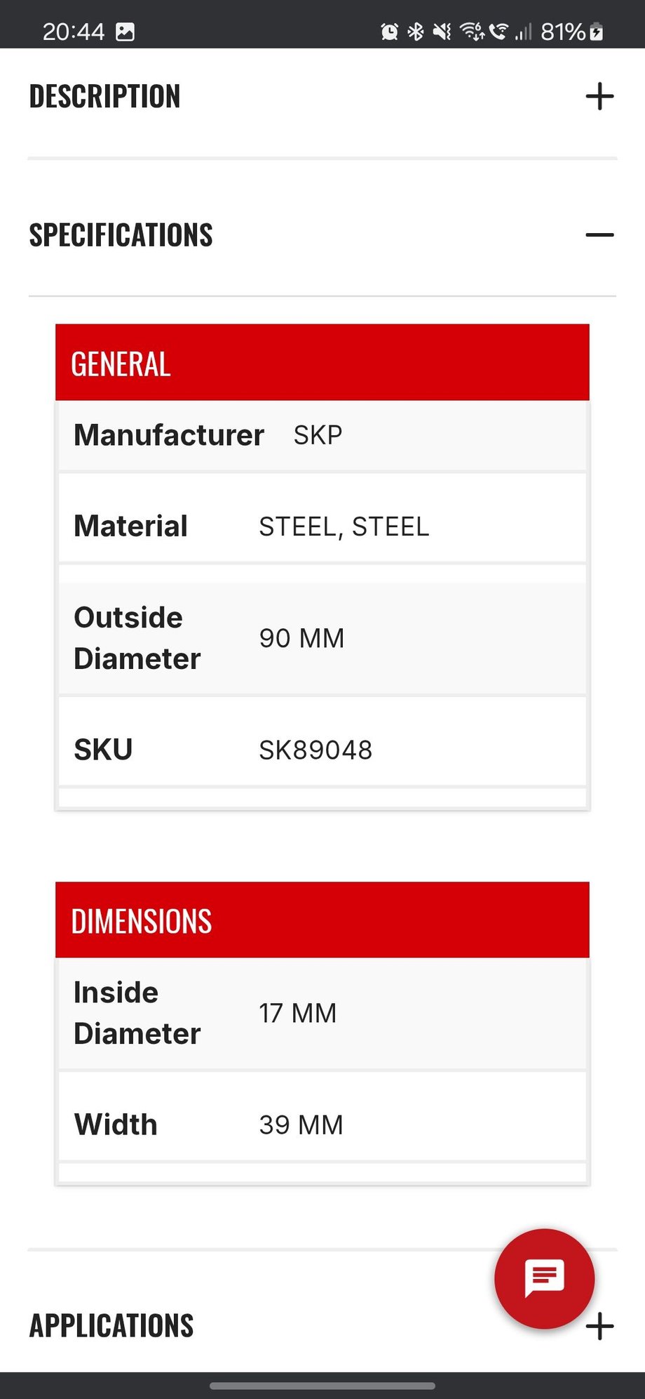

Hey everyone, new to this forum but have found myself in a spot of bother after the bearing in my SC idler pulley decided to seize up and fall apart.
The outer race ended spinning inside the pulley enlarging the hole meaning that after attempting to just replace the bearing (the suggested fix) the fit is too loose.
So I've had the same struggle with trying to find a good replacement pulley and after some digging found this pulley SK89048 for a Jeep grand cherokee seems to be identical and readily available (all be it from the US).
Pictures below, same 17mm ID, 90mm OD and 38mm width, I've yet to fit mine but hoping it ends up working.
Let me know your thoughts/experience!
Old May 10, 2025 | 02:13 AM
Vauxi's Avatar
Joined: Jul 2019
Posts: 817
Likes: 178
From: Finland
Idler pulleys do need to be jaguar branded. They actually never are. As long as every dimensions are correct then go ahead. Outer diameter can be slightly smaller. It will then cause tension arm to move more.
