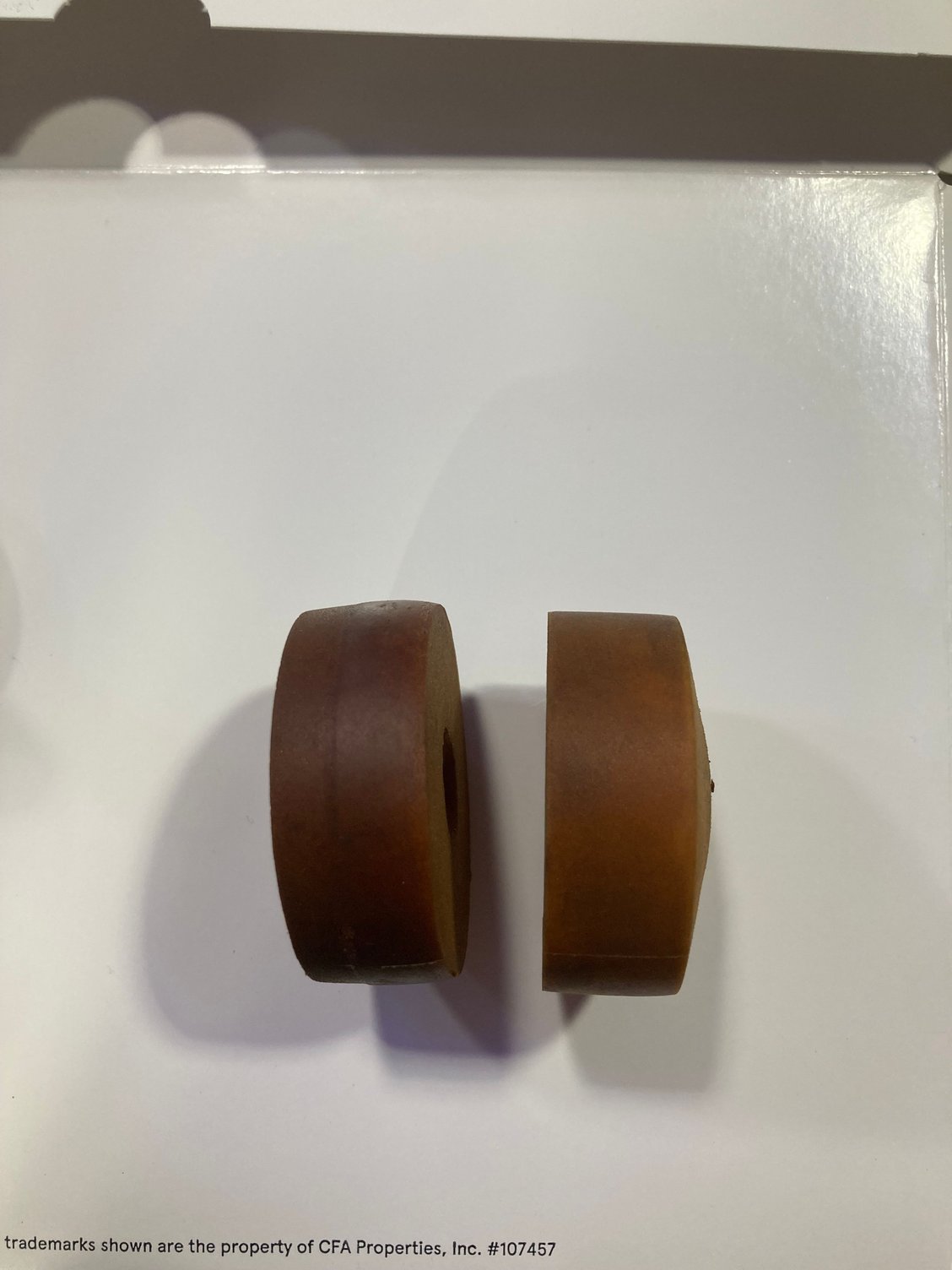

Stock on the left. Very similar and work great but, you need to carefully press out the center pin and during reassembly. Yes, 2 needed on each side.

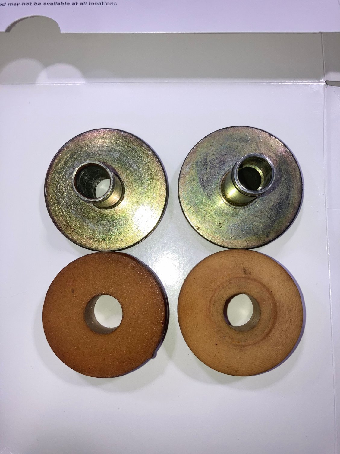

Stock on the left. Slight concave with the previously mentioned part number on the right.

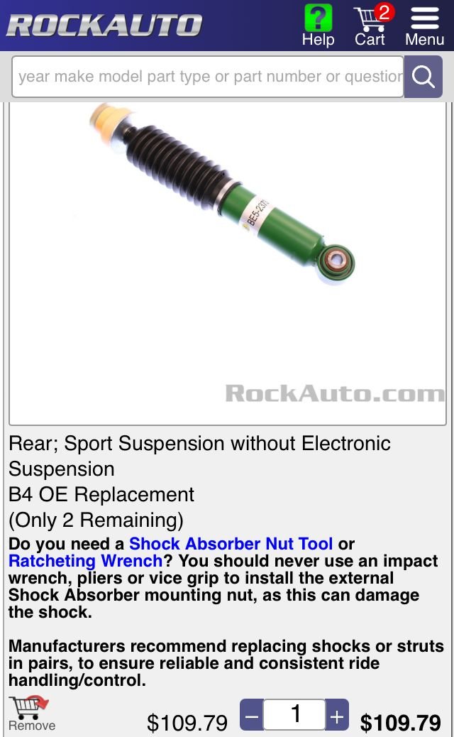

Go to Rockauto and a cats sports shock is $110 each. Only the rears have 2 out of 3 rear upper bushings.

Originally Posted by Addicted2boost
RockAuto is my default parts source. The above are without electronic suspension. I have a “notify when available” request in.
Old May 10, 2025 | 10:05 AM
Addicted2boost's Avatar
Posts: 3,125
Likes: 1,279
My bad! I think when I saw the green, it meant cats to me. Oops!
