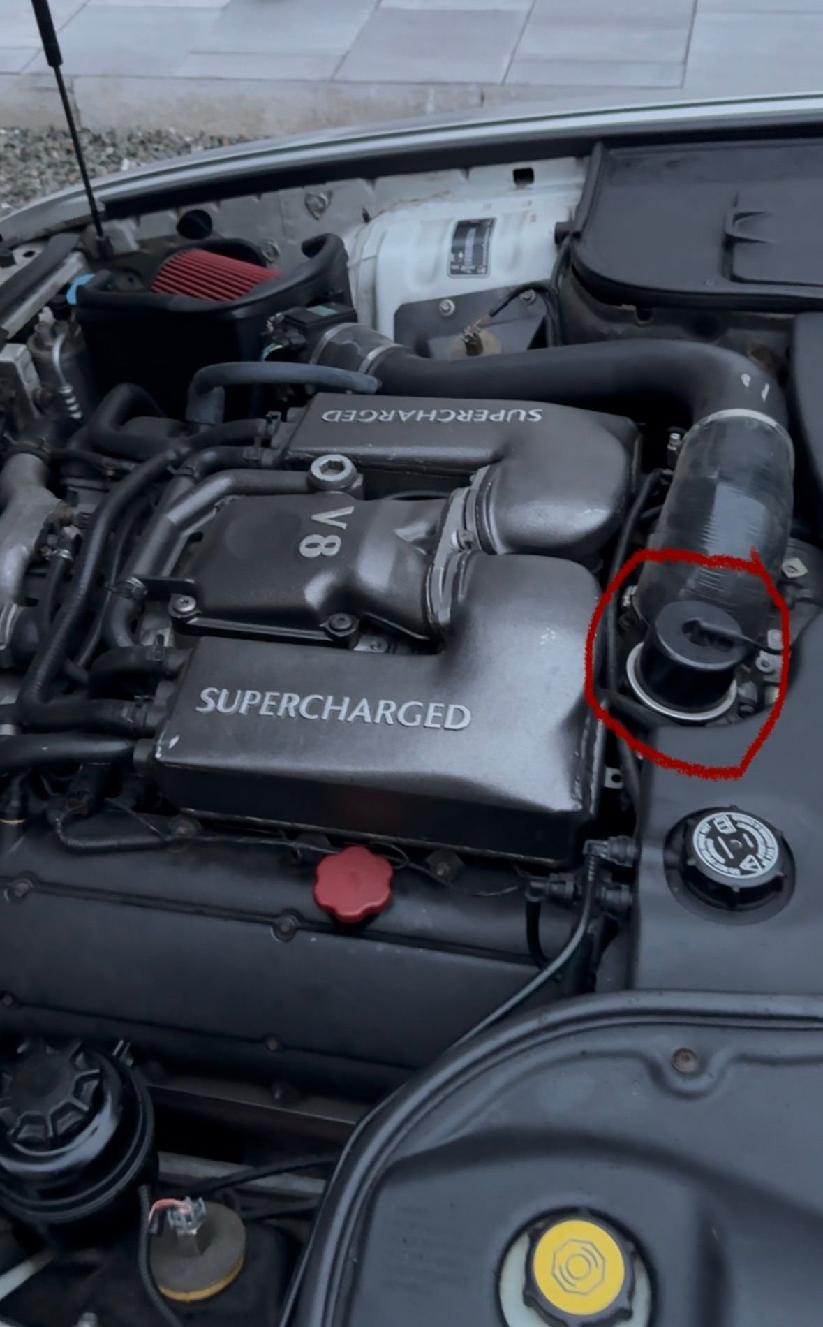

Hi guys,
as the title says, are these coolant hoses to the pressure tank plugged in correctly or do I need to replace them?
The issue that happened to me is when driving more aggressively the coolant seems to be leaking from header tank and I had to refill about 0.5L. By reading this forum and checking other diagrams I think someone routed the lines wrong.
Just need confirmation that if I change it, if it will solve the leaking coolant from unpressurised header tank problem? Or can something go wrong?
Thanks

Okay, thanks everyone.
I changed the hoses position and drove around 50km, didn't notice anything much different than before. We will see if it solved the shooting coolant from header tank when driving more aggressively.
I suppose that previous owner did some work on it and then made those "modifications". Was it intentional or not, I can't really say.
As far as I'm now dealing with it I noticed those lines were connected wrong, the cable for coolant level sensor was unplugged and bricked. Plugged it back in and it's working (when low coolant level it sent the message to dashboard). Why was it like that I don't know.
Also the small vacuum pipe from top of the throttle body was unplugged and hidden. I connected it as well, no changes in driving. What does that exactly do?
