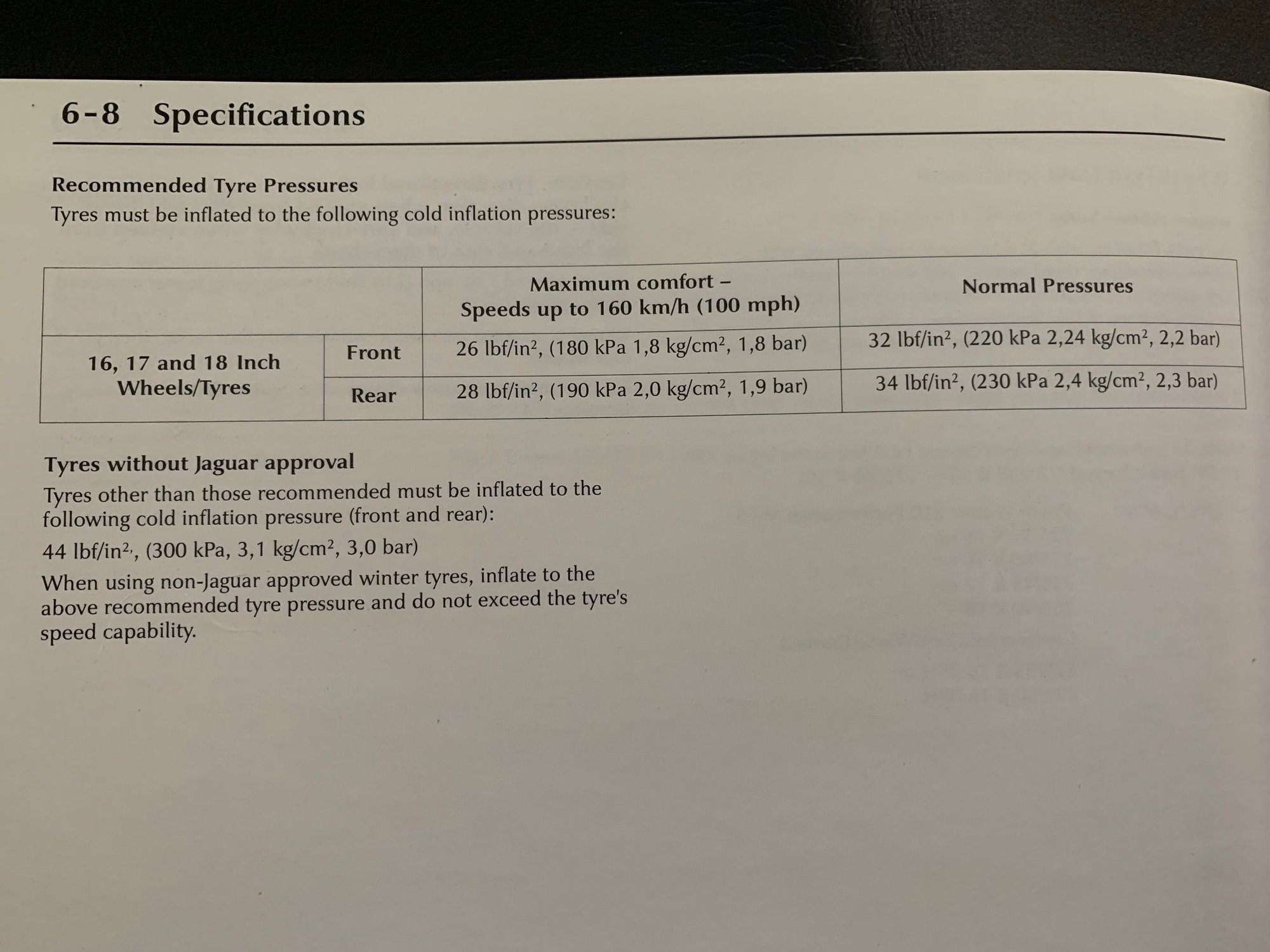

Why does Jag recommend 2 psi less in front than in back for the Pirelli P Zero tires? For all other tires, they recommend 44 psi all around. If I go with the P Zero’s, would it be best to run them with 2 psi less in front? Just wondering what the difference is.
I usually go with the manufacturer’s recommendation, but I admit that I run 32 psi all around in the Firehawk tires, mostly so I don’t forget to adjust the pressure when I rotate. And because 44 psi rode like a lumber wagon when I tried it!
Thoughts on why the 2 psi front/rear difference for the P Zero tires? What pressure would you run with my 3 options?
44 psi is for winter application...standard is 32fr/34r...higher speeds to 100 mph 26f/28r

There have been many advancements in the automobile tire industry, and these were the recommendations for 2005 or so.
Unless something has drastically changed in tire construction, I tend toward keeping the factory approved pressures.
Those with supercharged engines may opt for specific tires with more traction, however for most drivers these pressures
would seem to be the most desirable for comfort and noise levels.
Notice the slight difference between maximum comfort and normal.
It is premised on seeing most of the responders apparently discussing tires for supercharged cars while mine is not supercharged.
