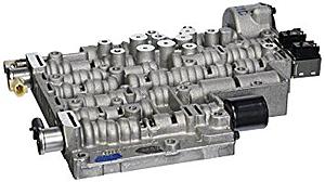

Hi
We only replaced the valvebody. (that is what it said on my invoice - and I got the broken valvebody with me)
Attached Thumbnails transmission noise when shifting.-91zxjh941bl._sx355_.jpg
Old Feb 7, 2018 | 09:37 AM
Daim's Avatar
Joined: May 2014
Posts: 5,906
Likes: 2,183
From: Bremen, Germany
That was quoted from Holybananas. A new valvebody is a good base. But if he has had his 5hp24 rebuilt twice, then it sounds to me like they aren't replacing the problem but only the broken parts. Kind of like taking a painkiller after breaking your leg but not getting the broken leg seen to...
