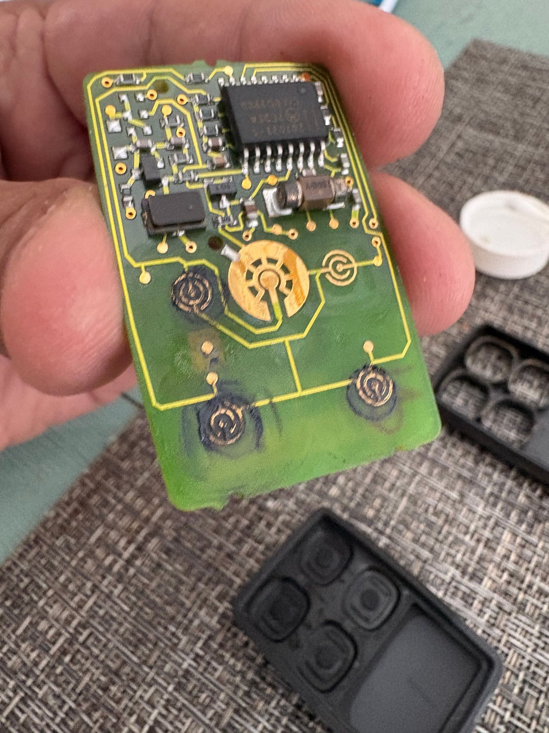

New to me 2000 XJ8. FOBS weren’t working as they should. Cleaned the circuit board (see BEFORE pic) and replaced the ONE 2032 battery with TWO 2016 batteries, in both FOBS.

I bought a small container of liquid keypad repair.
Amazon Amazon
Worked on a keyfob transmitter that had failing buttons on a few pads.
I repaired 6 or more transmitters and the container is still full.

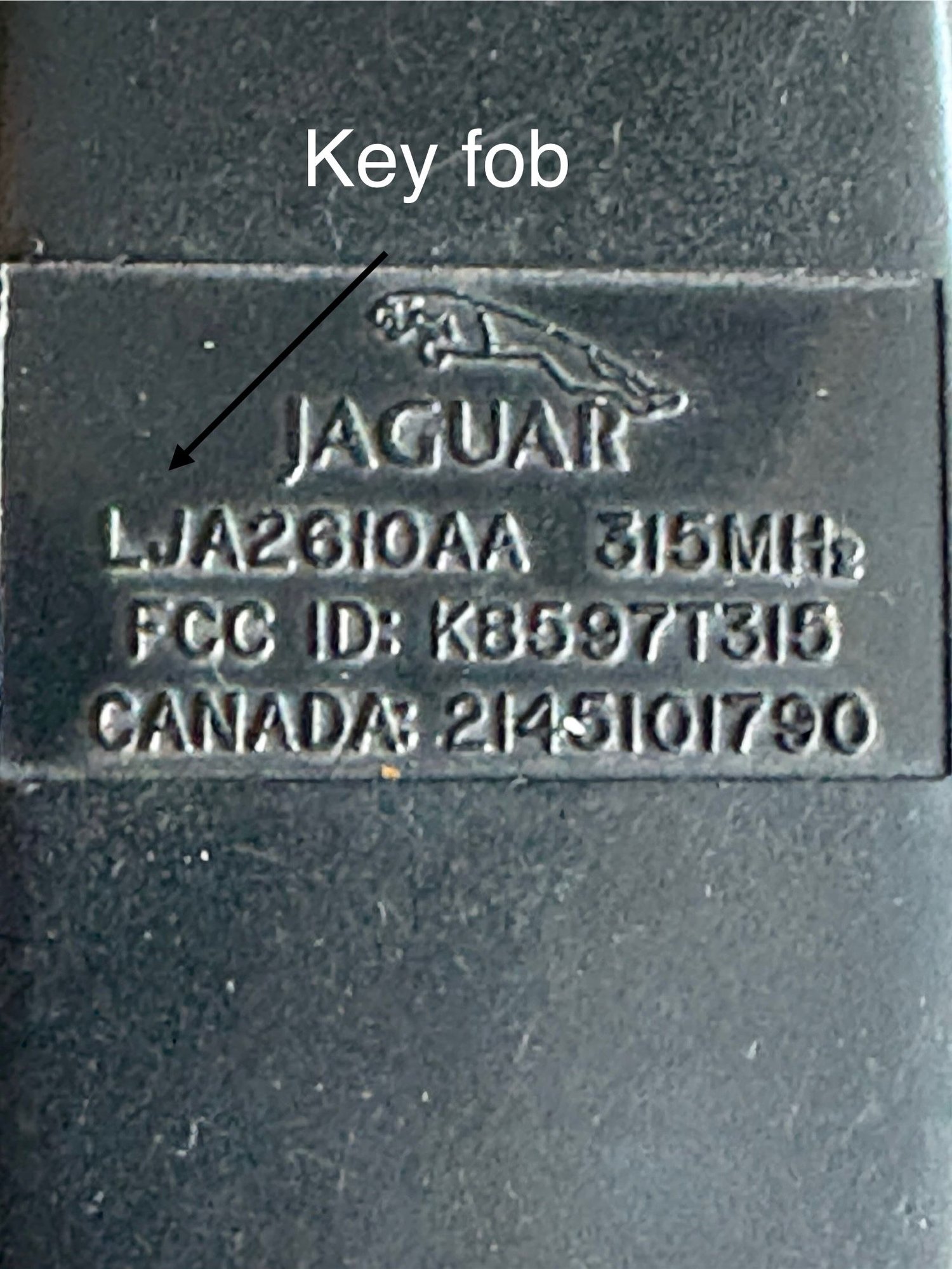

My FOB is LJA2610AA and the processor is 201033-1, perhaps yours is another model that only works with (2) 2016's?
Here's an old thread of mine (2) 2016 v (1) 2032 and the discussion Stojanovic and I had regarding it. Maybe it will help with perspective and yes I'm still using the same battery today.
https://www.jaguarforums.com/forum/x...pgrade-210090/

Check the numbers on your processor...it appears to be 2010**-* It may mean nothing, but I'm curious. My 2nd one is also 201033-1 and I got them as replacements separately and I wonder if they are all the same chips.
Bob's process to clean the board is probably better, but I used my girlfriends nail polish remover (non-acetone) and a Q-tip. She wasn't overly thrilled I used her stuff on an automotive fix. Be sure to clean the black pad as well, I think I used just soap and water on that to prevent any more chance of breakdown of the rubber.

The conductive paste is used on the rubber button pad to get the conductivity back on the pads.
The conductive carbon gets rubbed off and this gets it working again.
Wait? What? Are you saying that the black buildup on the circuit board is the conductive paste abs I should have left it on?

The conductive material is a DRY hard substance impregnated into the rubber pads.
Cleaning the film from the circuit board is fine but if the buttons cease to operate normally, then the repair paste will get the buttons working again.

I've tried the conductive paint but it didn't work for me. The only thing that works is opening everything up, cleaning the board and the rubber pads with electrical contact cleaner and reassembling. My rubber buttons are just about falling apart now from all the cleaning and disassembling. I wish these remotes were still sold for non-ridiculous prices. I just picked up some old Ford remotes from China that look like they have the same housing as well as some microswitches so I'm gonna use my spare fob to do some experiments soon. I'm so tired of always having issues with the fobs. I wouldn't really mind if the alarm didn't go all paranoid and require a key in the ignition within 15 seconds when you use the key to unlock the car.
