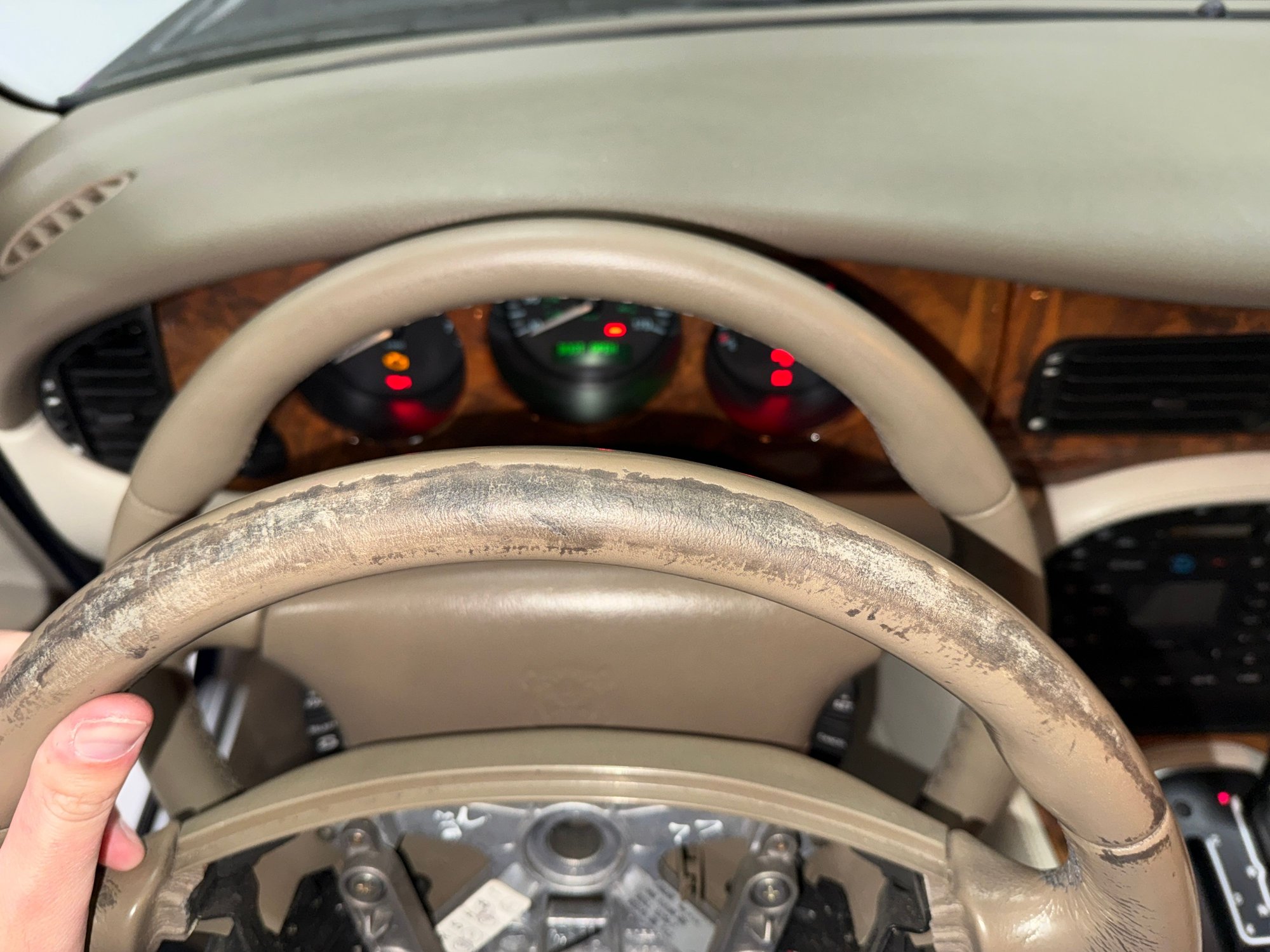

Hello XJ8 crew!
I have a 2001 XJ8 L with the Ivory interior (NED). I am struggling to figure out which steering wheel color I have (I want to replace mine as it is torn/worn). I see the most common steering wheel colors are
Antelope AGE
Sable AEK
I have looked at a few color charts in the forums but keep getting confused on which mine should be. It has always looked dark tan/grey to me. Would anyone have a definitive answer? Really appreciate the help!

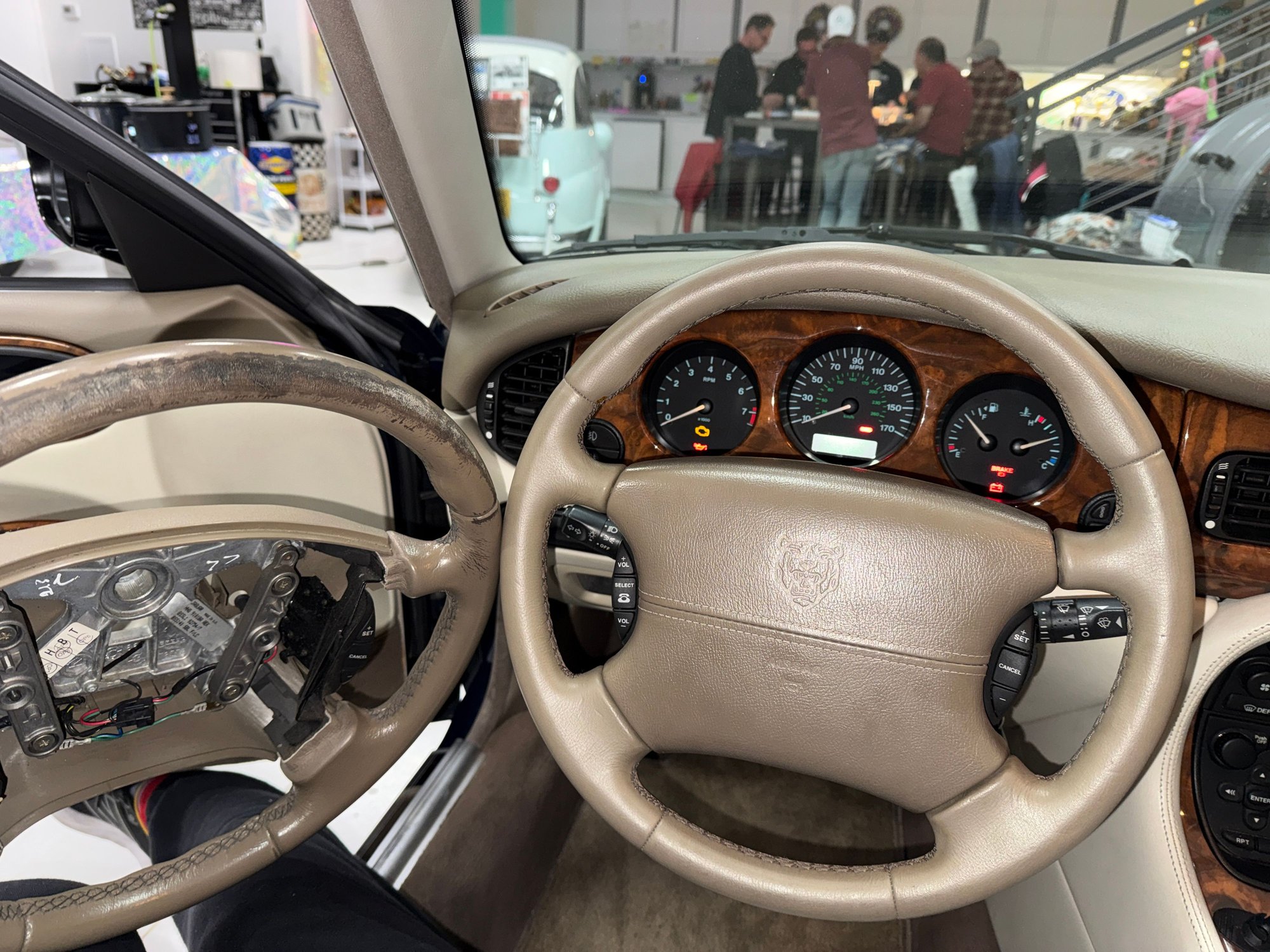

Hi all!
That Matrix is awesome thank you for sending. I finally gave in and took the center off of the original wheel and saw it was AEK. So I’ll be returning the first one I bought and I just installed my ‘new old stock’ AEK wheel. Very happy with the result. Also pretty easy to replace. A little goes a long way!
