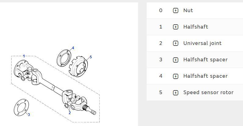

If I recall correctly, on the '93-'94 cars, the vehicle speed signal comes from the ABS wheel speed sensors via the ABS module. But on the earlier cars, the vehicle speed signal comes from a separate sensor on the left differential output shaft/halfshaft/axle. The sensor may be mounted on the subframe or the side of the diff:
The reluctor wheel is on the left halfshaft, Part 5 in the diagram below:
Cheers,
Don
