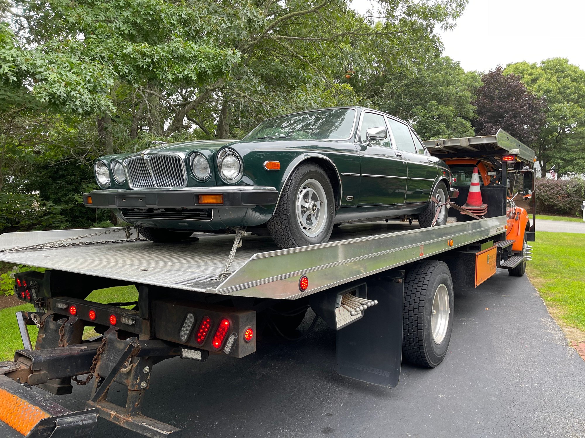

Hello All,
I just acquired this car from the same owner since 1992. It has been sitting in his climate garage for 2 years not running because he simply aged out of it. Before I throw a battery in it (old one left connected) and turn the key, is there a suggested process to start this after its been sitting? I plan on putting 5 gallons of fresh gas in each tank, as its not fresh smelling. All feedback is welcome.
I am used to old cars with carbs!

More pix and details!! She looks like a nice one!!

Hello, Tom,
What a Lovely example of a very Dignified old Classic.
After you get it running well enough, take it out and Drive it! It will thank you.
Will add pictures once she is cleaned up. This was a summer car on Cape Cod from 1992 until last week.
