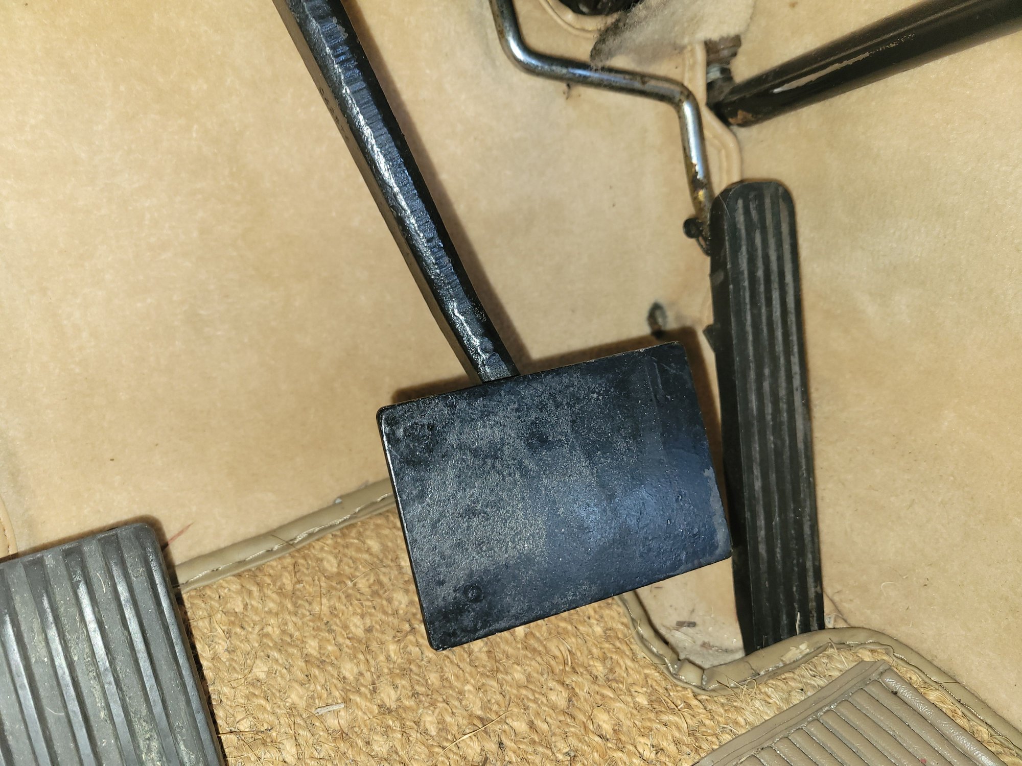

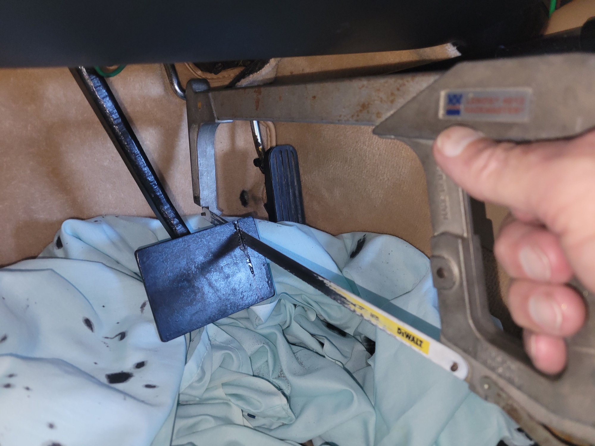

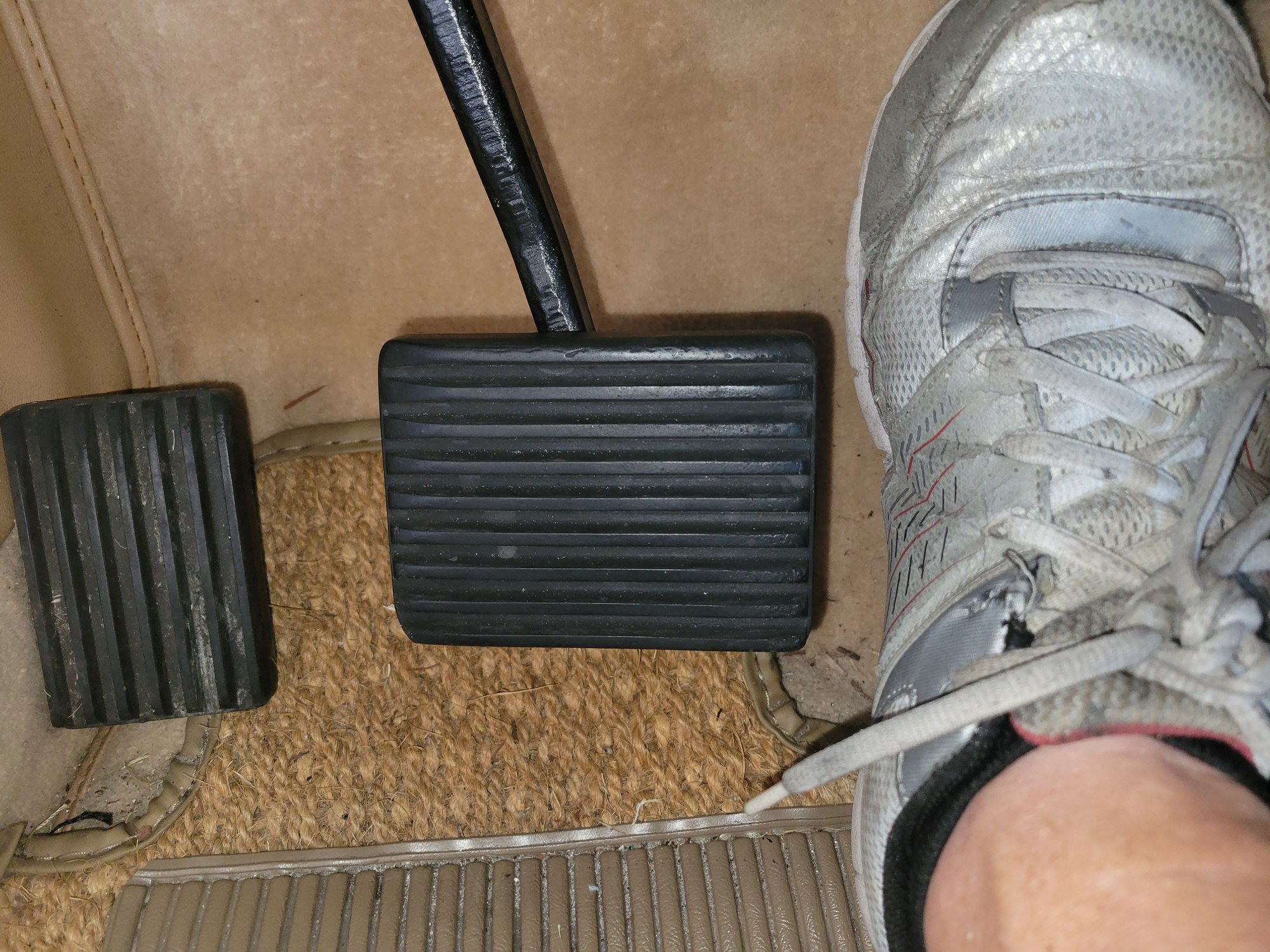

Oh Brother! Now there's a real change of pace for a Forum Title! Does anyone else have this problem? In my left hand drive Series II, my right foot just doesn't seem to have enough room width-wise, and it keeps getting caught under the brake pedal. Especially my boat shoes which have a sole that sticks out just a bit all the way around. But other shoes and sneakers also. So... my solution was to hacksaw 3/4" off the right side of the brake pedal. It is 4 3/4" wide, so that reduced it to 4" which is still plenty of brake pedal. I'm a left foot brake pedal kinda guy anyway, so that does not prove to be any sort of negative situation. Had to cut down the rubber pad by 3/4" and hot glue it together. I now have enough room for my right foot. And I only wear a size 10. So I can't believe that if I have this problem that no one else does? Thoughts?

Very interesting, Bill,
I have Series 2, and there's 2-1/2 inches between those pedals.
Parallax error makes it look like only 2-1/4.
There's Plenty of room for my wide soul sneakers, not unlike those you're wearing, but mine are only 8-1/2.
I like your straightforward solution though. Sort of like something a Farmer might do. Hot Glue Gun included.

Bill,
I have had this same project on my to-do list for some time now. My approach was to be the same as yours, except I hadn't worked out the issue of cutting down the rubber pad. How is the hot glue holding out for you? I think I've seen rubber epoxy or glue somewhere. Like you, I have always been a left foot braker, but many times I have gotten the edge of my right shoe caught on the brake pedal while taking off at a green light, not as smooth as I would like. You have inspired me to move this project to the top of the list. Thanks

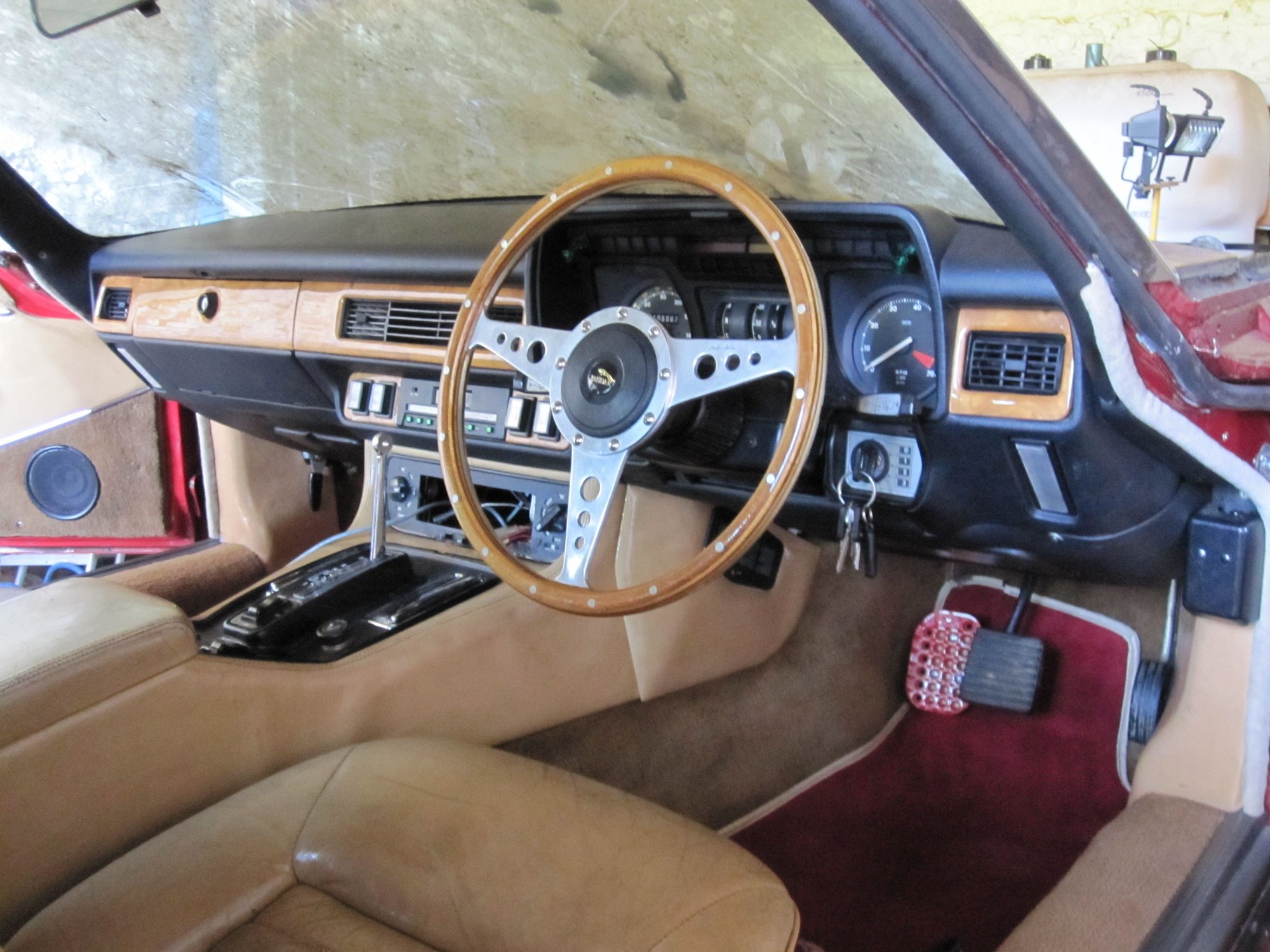

Very good fix. On my RHD XJS I did the same, but on the LHS of the pedal, as there was no rrom to get my left foot onto the (also home made) dead pedal.

LnrB - My size 10 sneaker is 4 6/8 inches wide. So 2 3/8" confirms you would have the same problem if you wore a men's size 10 or above. Size does matter!

UPDATE - No the hot glue didn't work. I resorted to smearing RTV on the junction of the two halves and let it dry. Then smearing the back of the pad and installing it on the metal brake. All is well now.

Should be good. I use windscreen sealant or an architectural sealant rated to hold windows in for this kind of stuff. The later sounds fancy but its off the shelf in big hardware stores.
