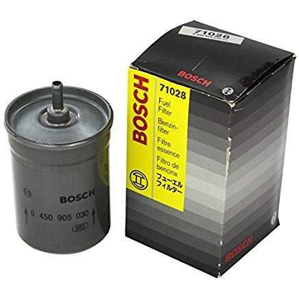

FWIW: my notes tell me I used a Bosch 71028 filter, replacing the PO’s Wix 33161.

Andrew, Thanks for the info, but the Bosch website does not list this as being compatible with the SIII XJ6. Lots of BMw's and Mercedes.

The OEM part number for the in-trunk fuel filter for 83-87 XJ6 is 0450905030. Dimensions are 4.25" long x 3.00" diameter.
Bosh has the filter listed as F 5030. Hope this helps.

Well, that’s odd. That filter has been in my 87 for more than four years with no problems, so I can at least tell you it does work well in the Series III. Amazon still says it is the right filter, although this Bosch site (https://www.boschautoparts.com/en/auto) offers no fuel filter number at all!
Oh well, consider it another option for you...

The filter goes by both numbers:

looks very similar to the Bosch F 5030.
Check the following listing on eBay UK, enter your car's details.
The Bosch F 5030 is used in many European cars, from Alfa Romeo to Maserati.
https://www.ebay.co.uk/itm/Genuine-B...-/371709534939

It *is* the 5030. Look at the part number printed on the filter.
