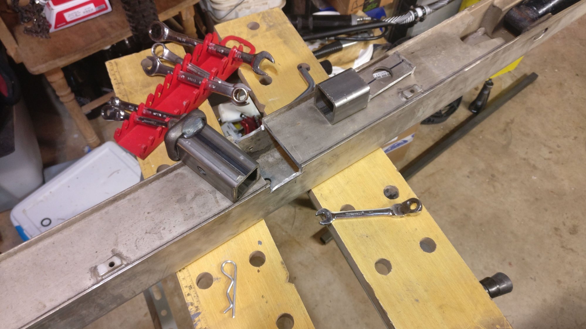

Took me a while to get around to it but I finally got that hitch put together. The bumper on the Series III is beefy enough for my purposes (bike rack) - so all I needed was a way to securely mount a receiver out of the way and here's how I did it:
Started with a notch in the back of the bumper so I could recess the receiver a little:
Added some thick steel plate to mount the receiver.
The square tubing and channel have nuts welded in them so that there's something there to back up the mounting bolts:
Here's the bumper back together with everything bolted up:

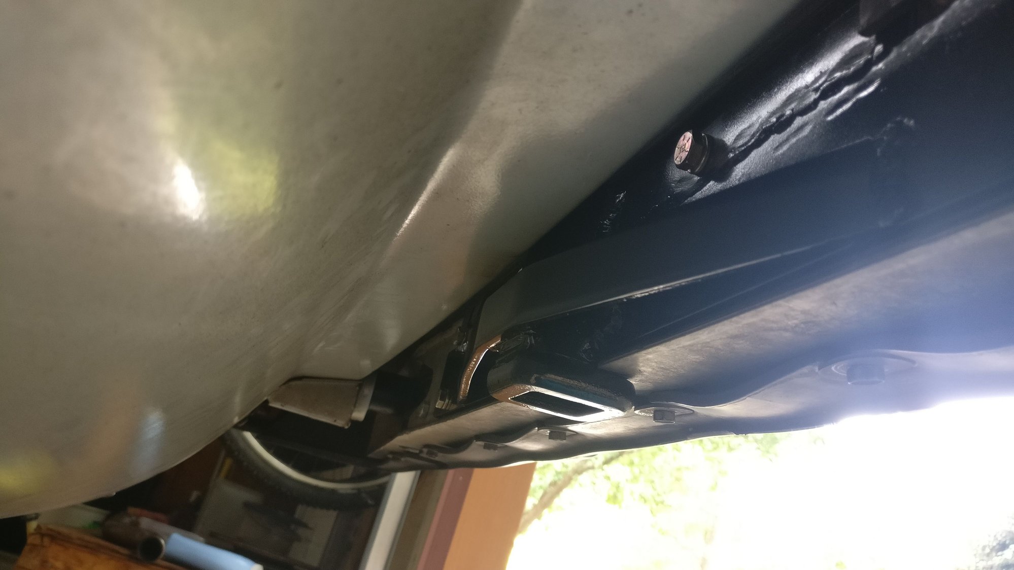

View from under the bumper once it's on the car:
