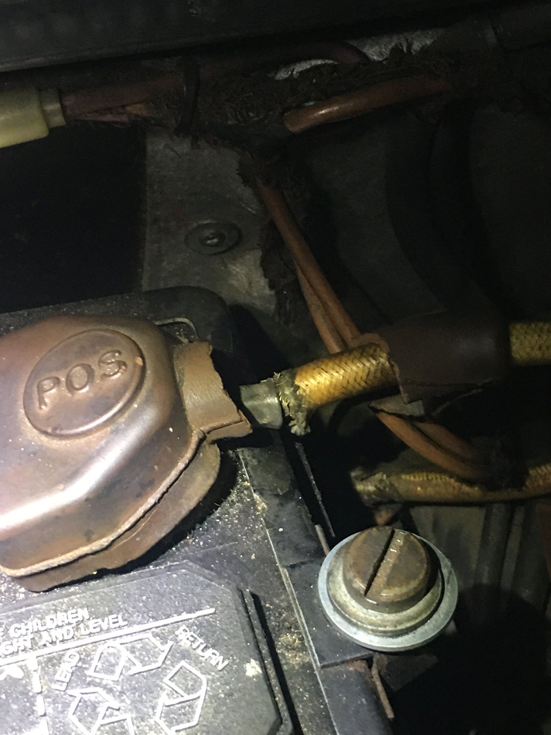

I agree. I cleaned the battery terminals and clamps, I cleaned the ground at the battery and fender. Replaced the transmission to body strap with an insulated cable and cleaned the contact points with a small wire wheel. I noticed a bit of improvement. But I made a bigger discovery just a few moments ago. The positive cable looks weak and frayed at the clamp. Im sure my problem is there. Will have to replace the entire cable but Im going to try replacing the clamp first. Heres what I saw once the brittle rubber cracked right off. The brittle wires have cracked near the crimp and the clamp is probably hanging by a few threads.

I think you are on the right path, with the wiring and poor connections.

Thanks for the input fellas! I managed to get a set of custom cables for Etype and XJ6, at my local indy shop. Its made a considerable difference, once I installed them, still have to go through the Earth points and clean them all up for peace of mind
