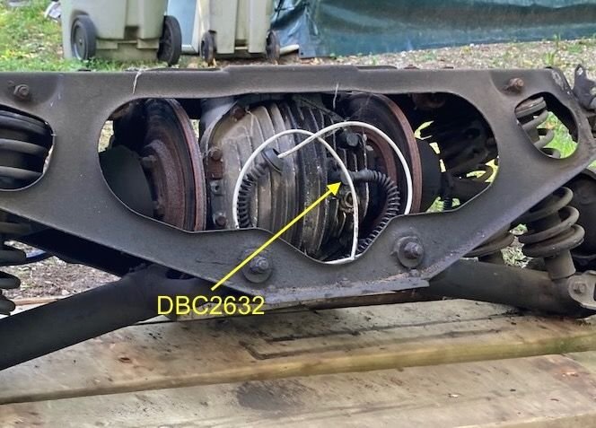

Matt, my 4.0 manual XJS (VIN 180034 built 6/91) has the DBC2632 speed sensor on the back of the diff. I suspect your parts supplier “thinks” that the changeover was around VIN 179737 when the facelift model appeared. Others make that mistake too, eg. Rock Auto with brake parts.
Moss Motors, for eg shows that the transducer fits up to 144262 https://mossmotors.com/catalogsearch/result/?q=DAC4569 and that DBC2632 carries on from there up to a certain point https://mossmotors.com/dbc2632-speed...fault_products (see the Fitment tab).
When the Coventry Foundation gives you info, you can take it to the bank.

You have to unplug the speed sensor’s cable (the white one shown coiled up here) in the trunk/boot if you’re dropping the cage out of the car.
