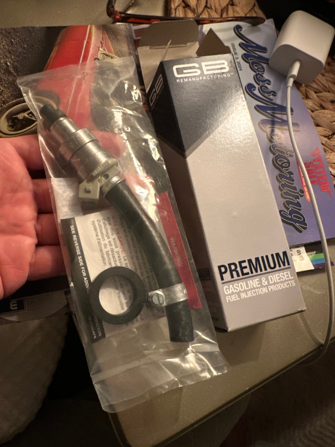

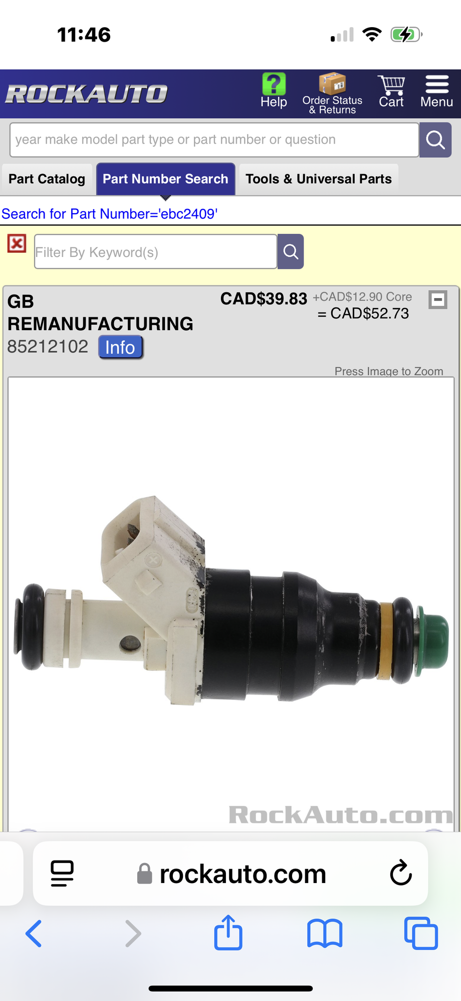

I have 12 refurbs going in this weekend, Rockauto sells them pretty cheap.

EBC2409 on rockauto? can you please give me link, i cant find it

They have 2 part numbers, long and short hose hut both have the same length hose(product was identical)
note** the pic above was for my lucas car, your 92 doesnt have the hoses so disregard that comment.

The upper picture in my post was indeed the ones he needs, and available through rockauto.
you can search Rockauto using the Jaguar part number(thats how I got that picture).

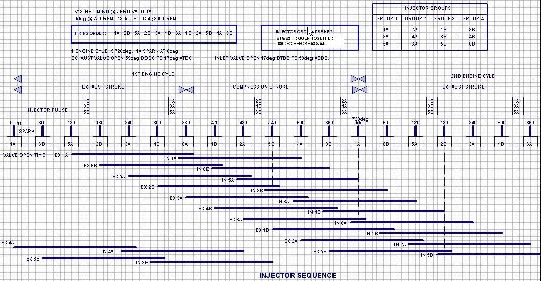

Not sure I get what is going on here.
The information below shows the injector sequence. I made this a long time ago to check something when fitting an aftermarket EFI system.
There is a note that group 1 and group 2 fire together, and 3 and 4 also together.
1) How do you know any particular injector is spraying too much fuel ?
What is the test method ?
The only one I can think of is to check the energisation time with an oscilloscope compared with the average of most "good" injectors with engine running.
You can by a basic 2 channel oscilloscope to check this for peanuts nowadays. Quick before the tariffs hike the price.
2) If 5A, 6A, 4B, 5B are truly spraying too much fuel that is a strange combination.
It does not line up with the wiring of the injector groups.
3) If statement 2) is correct it indicates:
a) The wiring of injectors is not correct, or there is a mechanical fault in those 4 injectors.
b) Or both the wiring is not correct and the ECU is driving those 4 injectors for too long.
4) If the injector harness has been rewired as mentioned earlier, good idea to double check it.
5) The fact that the fault only happens after the engine warms up is another puzzle.
Injectors will tolerate a fair bit of heat. I would suspect the ECU warming up to be more likely to explain this.
SOP to check this is apply an ice pack to the ECU to see if that cures the problem.
On the other hand the ECU was swapped with another, but I would still ice pack it to eliminate the possibility.
On the off chance something is screwed up in the resistor pack give that an ice pack treatment.
6) First thing to solve the puzzle is to find what item warming up creates the apparent over fuelling.
The chances of it being the 4 injectors is remote. If they are faulty they are 99.9% sure to be faulty hot or cold.
Good luck with tracking down the problem, it is one of the more unusual ones to come across.
