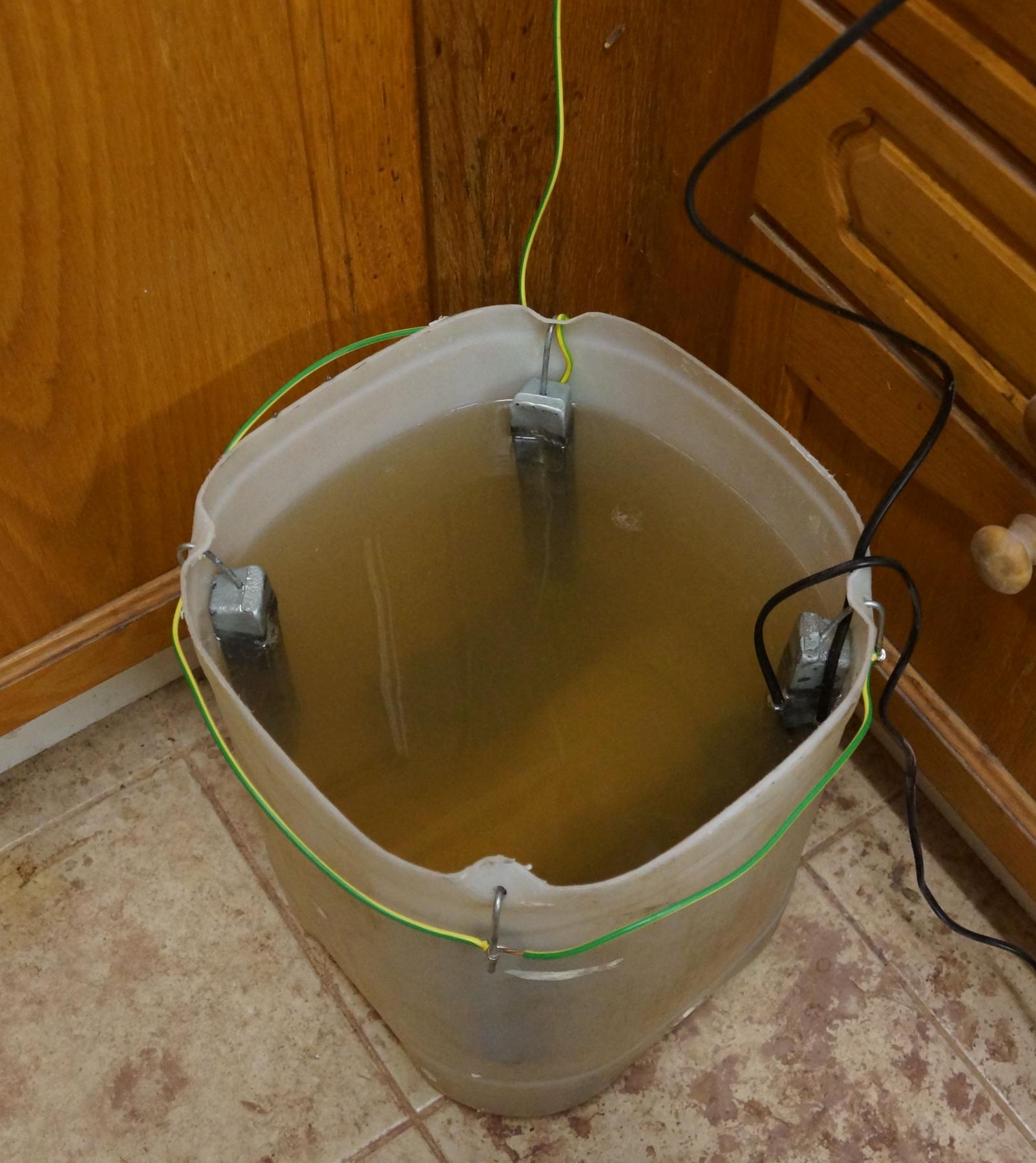

There is not all that much more work required to home plate than to paint and the original look and protection is retained.
