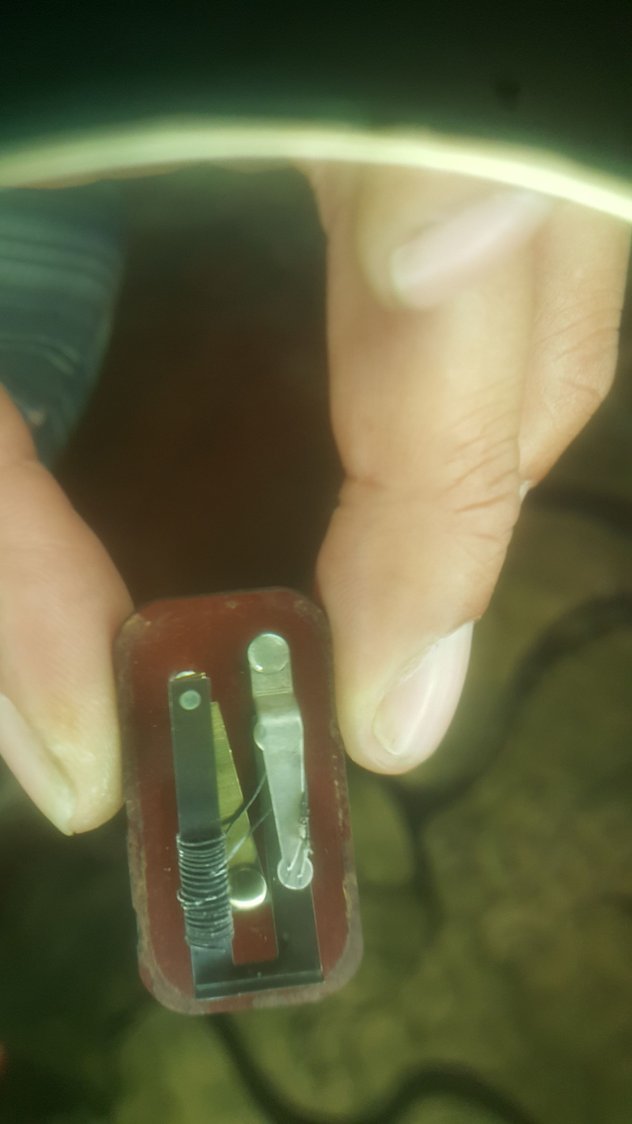

I have a confession to make. I completely deleted (after the second round of sensor failure) the rear lights out warming system. When I first started on this car one was dead. I dissected it then and saw that after 30yrs these things must be on their last legs. The big metal strip/tang wrapped in naked copper wire that heats up for function - seems a bad lucas design in the first place, new...
I tried doing some soldering - actually I think the wire might be made of tungsten or something - the wires fought the solder.
I made up some double ended male spade wires, I simply jumped the plug and ran the striped 12v wire, thru the 2-3amp inline, right to the RED light lead. To my surprise it worked - knock on wood. I still get the 30 - 40 sec yellow illuminated check period, I guess for the front lights, then it switches off.
I have heard that the Jaguar bulb is a unique bulb for rear running lights. Could it be that the wrong new bulb was installed and the brakes draw enough current to decrease the amount of current in the sensor,,, thus tripping it?
After the second failure I had had enough. I'll just give the car a walk around checking for lights out, once in a while, like back in the ol days.
Well, if nothing else, it's certainly very old school. But let's not be too hard on old Joe Lucas. Lifespan of these BFUs is usually measured in decades. If something on a car lives that long the design couldn't have been all that terrible.
I'm not entirely clear on what you're saying.
Each branch of the bulb failure system for the running lights depends on xxx-amount current draw to work properly. So, yes, incorrect bulbs can cause a problem.
However, the brake light failure circuit works independently. Incorrect bulbs in the running lights wouldn't affect the brake light failure circuit.
DD

Understood on both points Doug. Understood...
I guess what I was thinking was that if there was a dip in current overall due to the brake lights being activated, with slower running engine due to braking, the amount of current that it takes to bend that bi- metal may drop allowing the contact to close momentarily, lighting up at the dash...? Maybe? What does early signs of failure of these units show up as, anyway? It only takes one to set off the light I think
