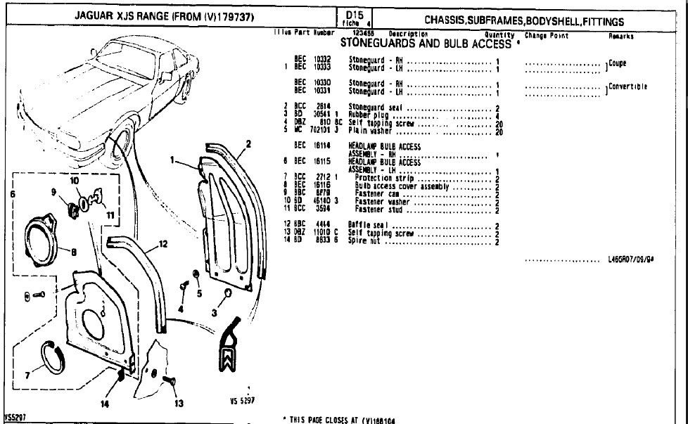

The facelift trap doors are not round. They are a rectangular-ish shape?

Default It's "Round"
Item #8 is the "door" used to access your 1992 XJS headlight.

Thanks for the input. This door in your illustration is exactly what I have. I am going to replace both bulbs and plan to remove road wheels to facilitate accessibility.
