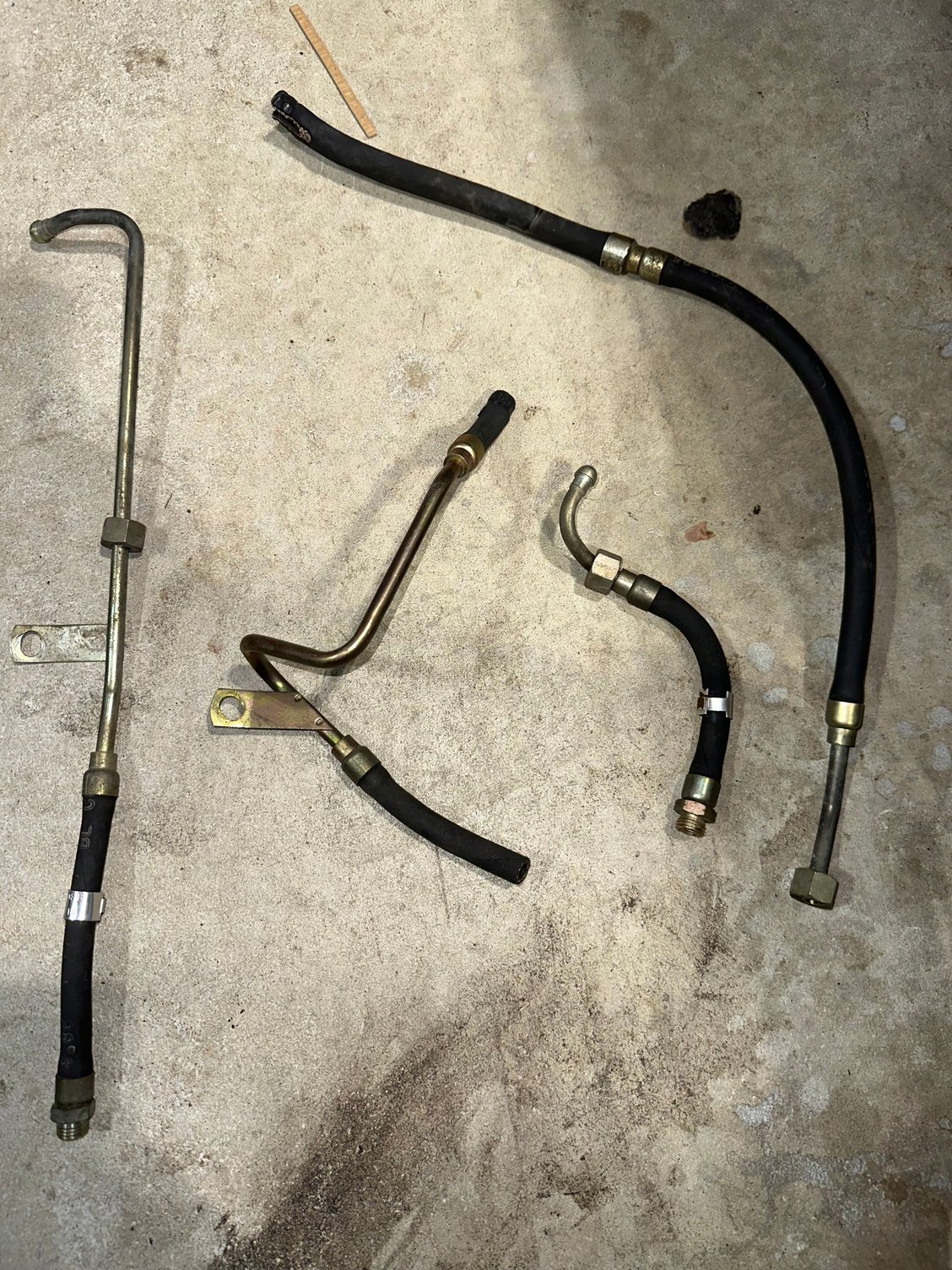

1986 v12 Canadian spec
Have removed the fuel lines under hood, there are 4 combination rubber/steel lines and a rubber return line going from fuel cooler to firewall.
can someone confirm actual size? As per my search on here these are said to be 5/16” and 3/8”, this is not the case.
5/16” is slightly large as is 3/8”
measured with calliper, compared factory hose to new, even went to hydraulic shop to see if they could rebuild(local shop wouldn't do it as they don't have a supplier for this hose). The barbs are not 5/16 and 3/8, seem to be slightly smaller.
Due to fire risk, i dont want to mess around with close fit, needs to be exact.

I figured it out, factory uses 7mm and 8.5mm hose.
3/8 and 5/16 is not correct. Dont know why these sizes keep getting referenced

Those sizes are too large for my 86, could probably make it work with clamps but I’m not risking it. Factory barbs are designed for 7mm and 8.5mm ID hose.

problem still remains though, nobody makes 7 and 8.5mm ID sizing
Cohline lists a 7mm ID option that should match original but the closest they have to 8.5 is a 9mm option.

I have found a source for 7mm ID fuel injection hose.
i have a potential source for 8.5mm ID fuel injection hose.
Problem may be solved.

8.5mm ID hose - Cohline 2134.0209
available via many vendors online(mercedes spec hose)
7mm ID hose - i dont know the manufacturer or part number yet, will know when it arrives. This is a common size for classic VW, the VW vendors sell this modern(non braided) hose.
both are safe for injection and modern fuels.
no excuse to use different sizes as these are available.
