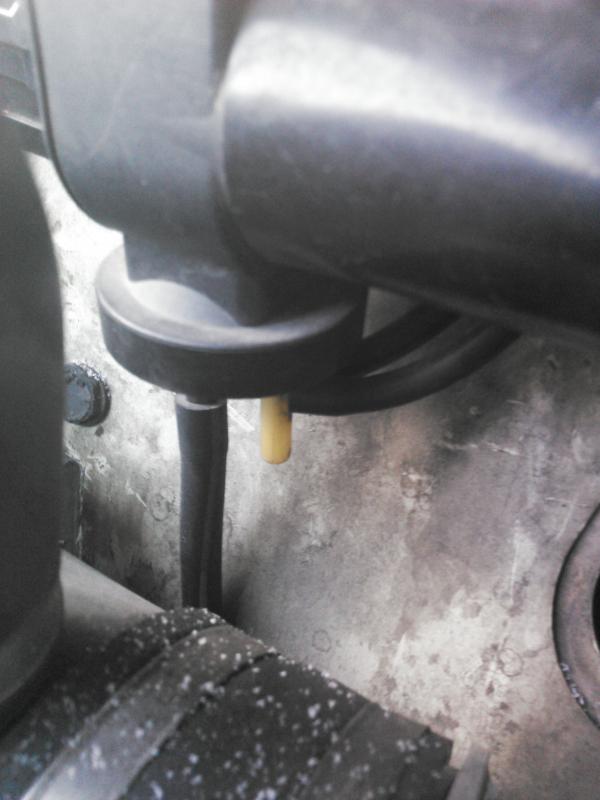

the cruse control is not working so far i have tested the switches and they appear to be good and the fueses are good. but the cruse control will not set. looking over everything under the hood everything apears to be in tact and nothing obviously wrong. there is one spot on the vacuum control on the bottom side that does not have a hose connected to it i am unsure if this is suppose to be a place for the modual to vent or if there is suppose to be a hose there. if there is suppose to be a hose there where is it suppose to be routed to.

3. Im assuming the facelift cars use a similar system to the older ones. It is vacuum operated and if you are missing a hose it needs to be connected to work. More worryingly if there is a disconnected hose, that hose is sucking unfiltered air into the engine and causing wear.

#3 i will try to take some pictures, there is no vacuum leaks on the motor.

on the cruise control module here is the pic
