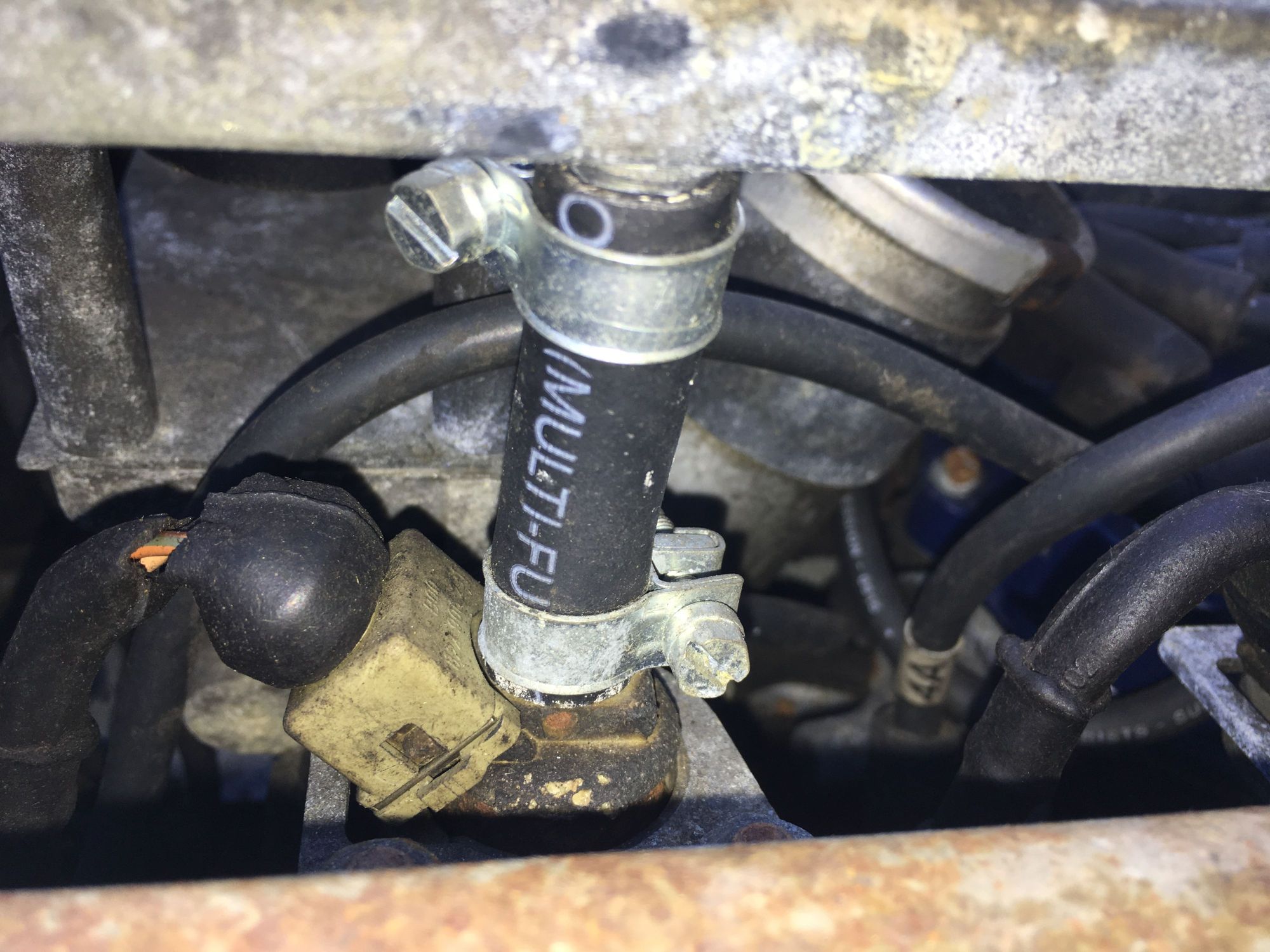

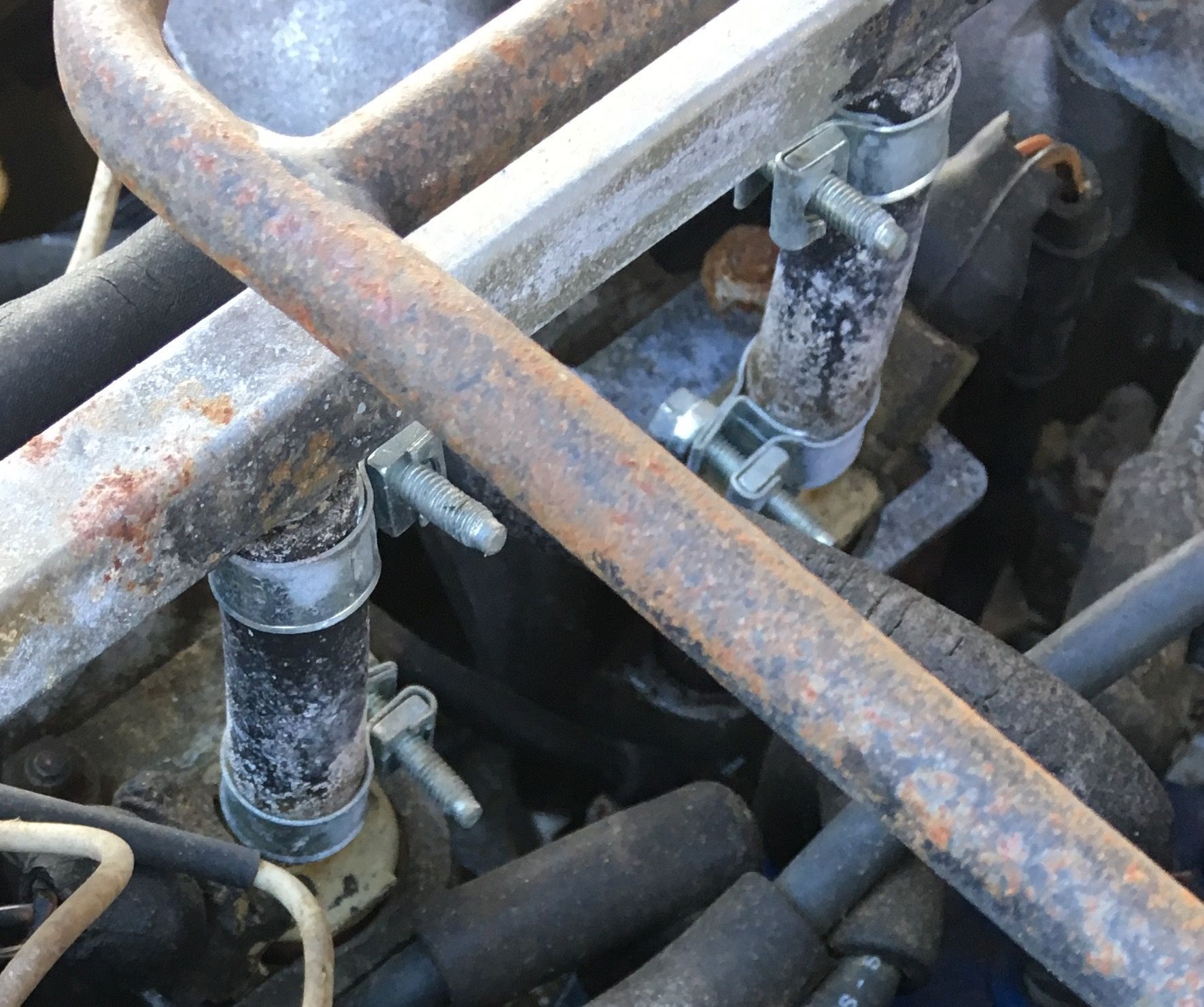

I have used NGK BP6EF forever, BUT, in their wisdom NGK has stopped making them, so now I am forced to use BPR6EF.
The fuel hoses in the engine bay will need to be renewed, and I mean ALL of them, and that is MORE important than showing up for your wedding, trust me.
I have rebuilt way too many over the years due to fuel hose engine fires. All the owners knew of the risk, and it was on their to do list, they just failed to inform the car of that list. Each of them paid for a nice trip to Vegas for us both, so I have little sympathy.
You do have some very serious work ahead of you, but the basics are there, and yes, it runs. Forget the smoothness and whatnot for now, that will be sorted when all that stuff is cleaned up and renewed. Then, if its still having a female moment, the seek and find/fix will be soooooo simple.
One wire at a time, and you are finished when you are finished.

I'm going to take the fuelrail and injectors out today I think and get new hoses on and paint the rail as it's looking a little worn... I noticed looking at pics that my jag seems to have no ferrules and atleast one injector wire already looks like it's been on fire. Ha
are the ferrules necessary?
