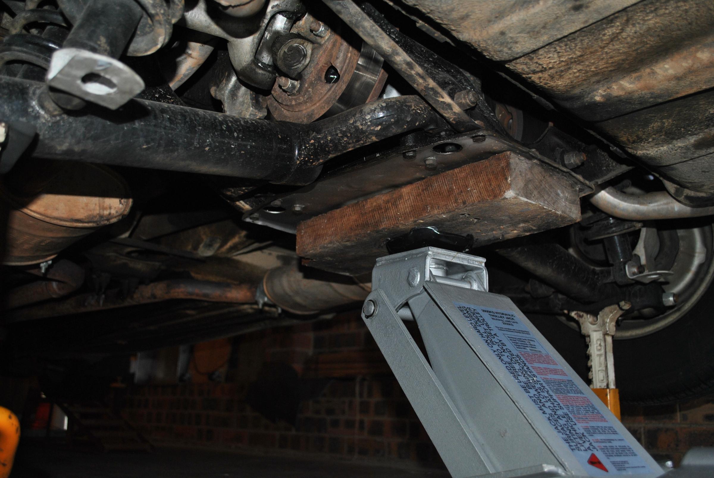

This is what you need 'Bro' a 3 Ton Trolly Jack, anything less will be a waste of time, also with this particular Jack, you can remove the 'Round Cup' where the 'Jacking Point Peg' will locate in the hole that it leaves, making it 'almost impossible' for the Jack to slip.

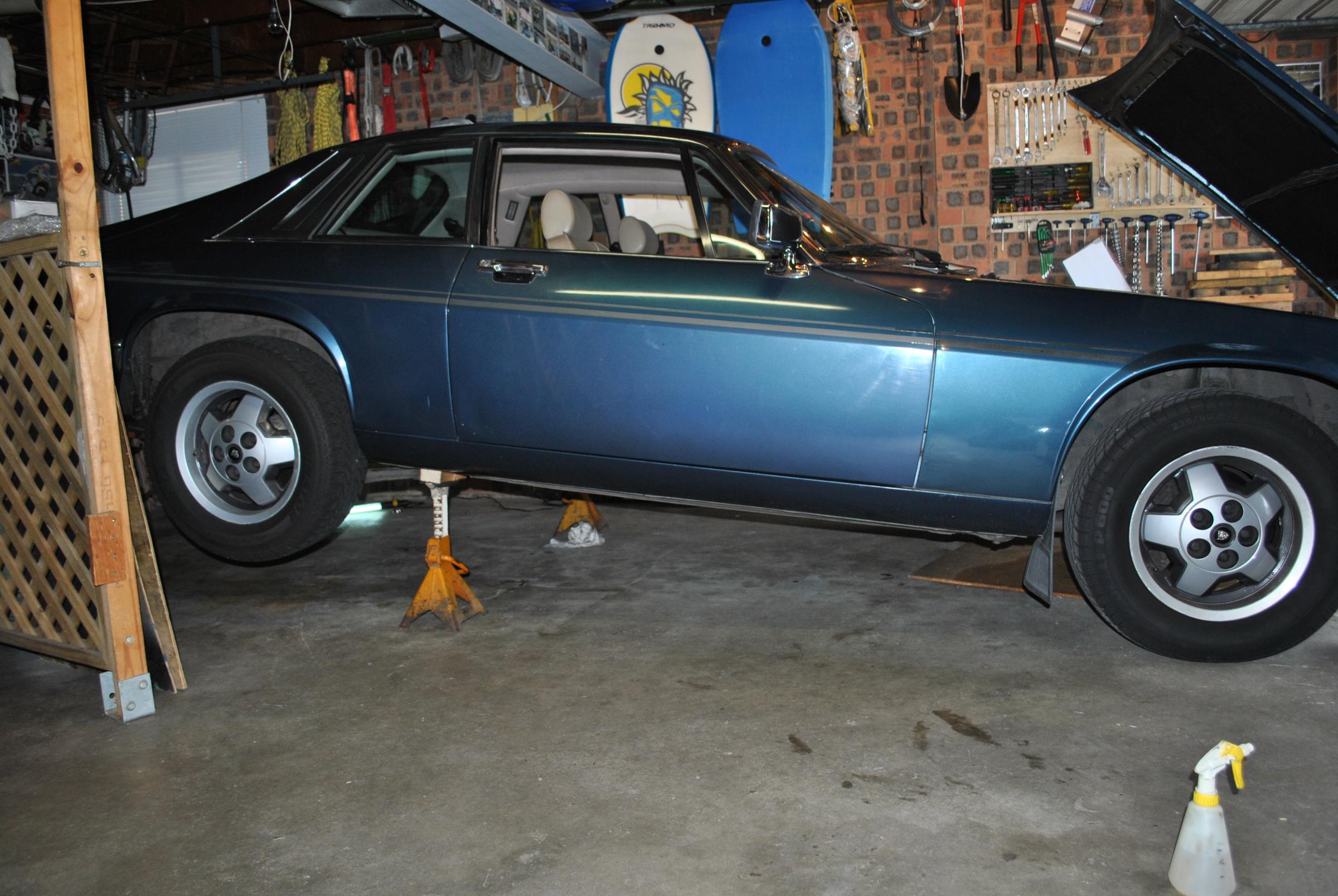

Paul I bought the el cheapo 3T SCA jack from supercrap, works fine when accessing the side jack points.
If I need to jack in the centre so I can put stands under I run josephine up on two home made ramps (made out of railway sleepers cut with a chainsaw) to get the clearence needed to get the jack under the front chin spoiler.

I use a 1850kg, same physical size as OB's, to get some clearance for the "Big Boy" SCA 2400kg, to get under the subframe to raise the whole front, thus leaving the jacking points clear for the "Grants special" jackstands to keep the beast up where it belongs.

While a 1.5 Ton Jack maybe Ok for something like changing a Wheel, what you have to factor in, is that this is Not a straight lift.
As once you start to jack up a Car on one corner, that will be the moment that Torsional Forces start to come into play, as the higher you go the more that the body will do its best to twist.
Where as such if you were able to 'Theoretically keep on Jacking it up' it would eventually try and lift all 3 wheels off the ground, which would increase the load on the Jack by an unknown factor (at least to you)
Which could then exceed its Safe Working Load.
While small Jacks are Ok for things like changing Wheels and other small jobs, where for instance access may be difficult.
If you want a Jack to do Maintenance work on an XJS, then bigger is always better, so you can lift the Front of the Car, under the Front Beam, in order to get both Front Wheels off the ground at once.
But put some wood the length of the Beam, under the Beam before you Jack it up, or you may find that your Front Beam gets dented.
So bear that in mind if you call in a Garage/Shop to have a puncture repaired or new Tyres put on.

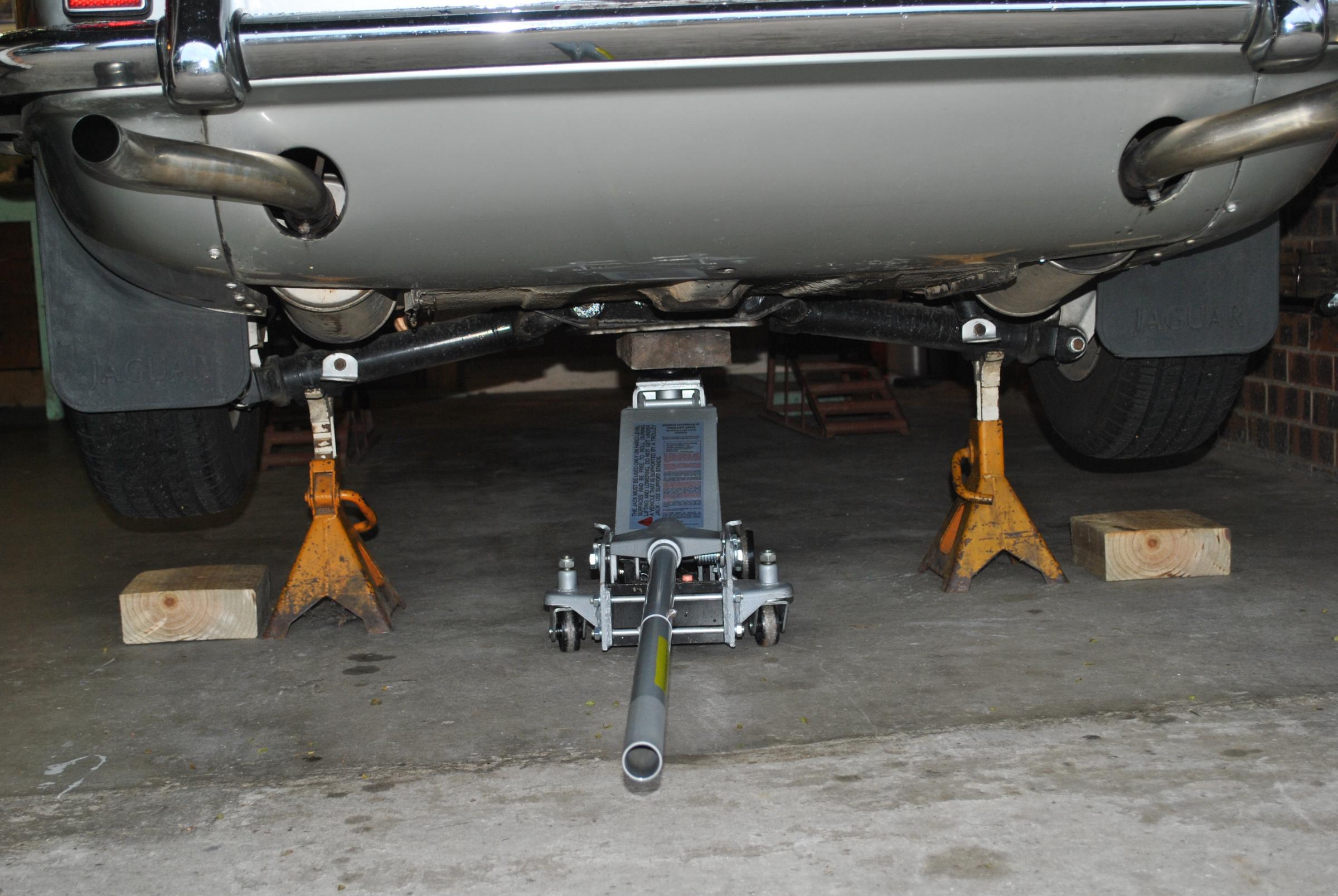

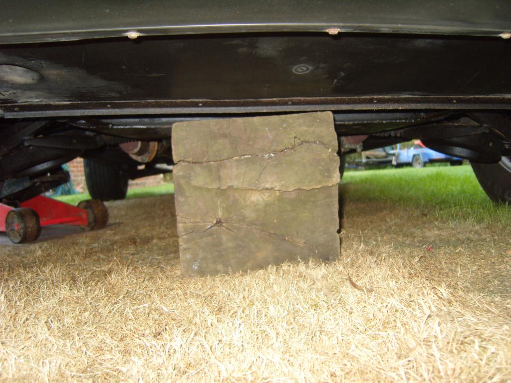

I really hate using Axle Stands 'Bro'
I much prefer a Great Big Block of Wood put under the Front Cross member, then I know for sure the Car cannot fall on me.
Old May 29, 2015 | 04:24 AM
texasscot's Avatar
Posts: 124
Likes: 49
From: Houston, TX
Yes, I wouldn't use axle stands on grass either!

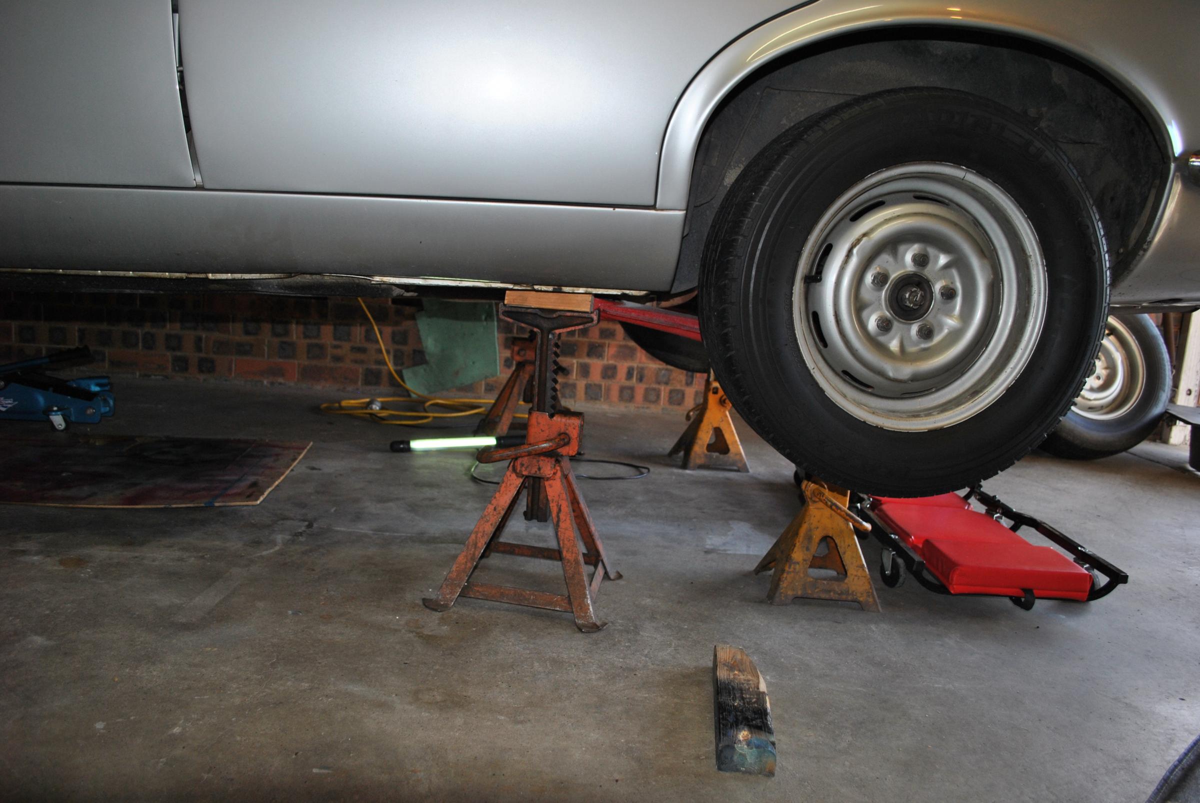

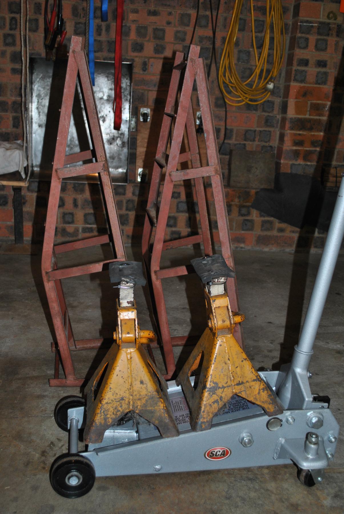

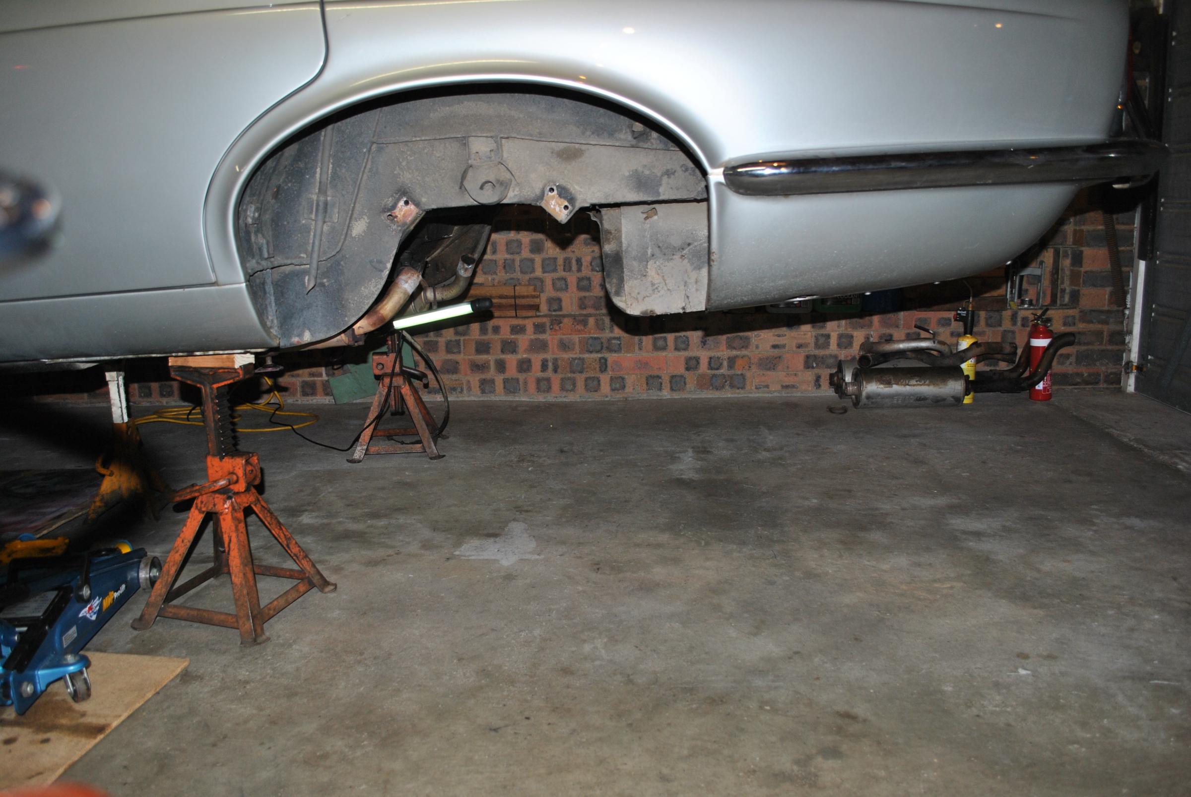

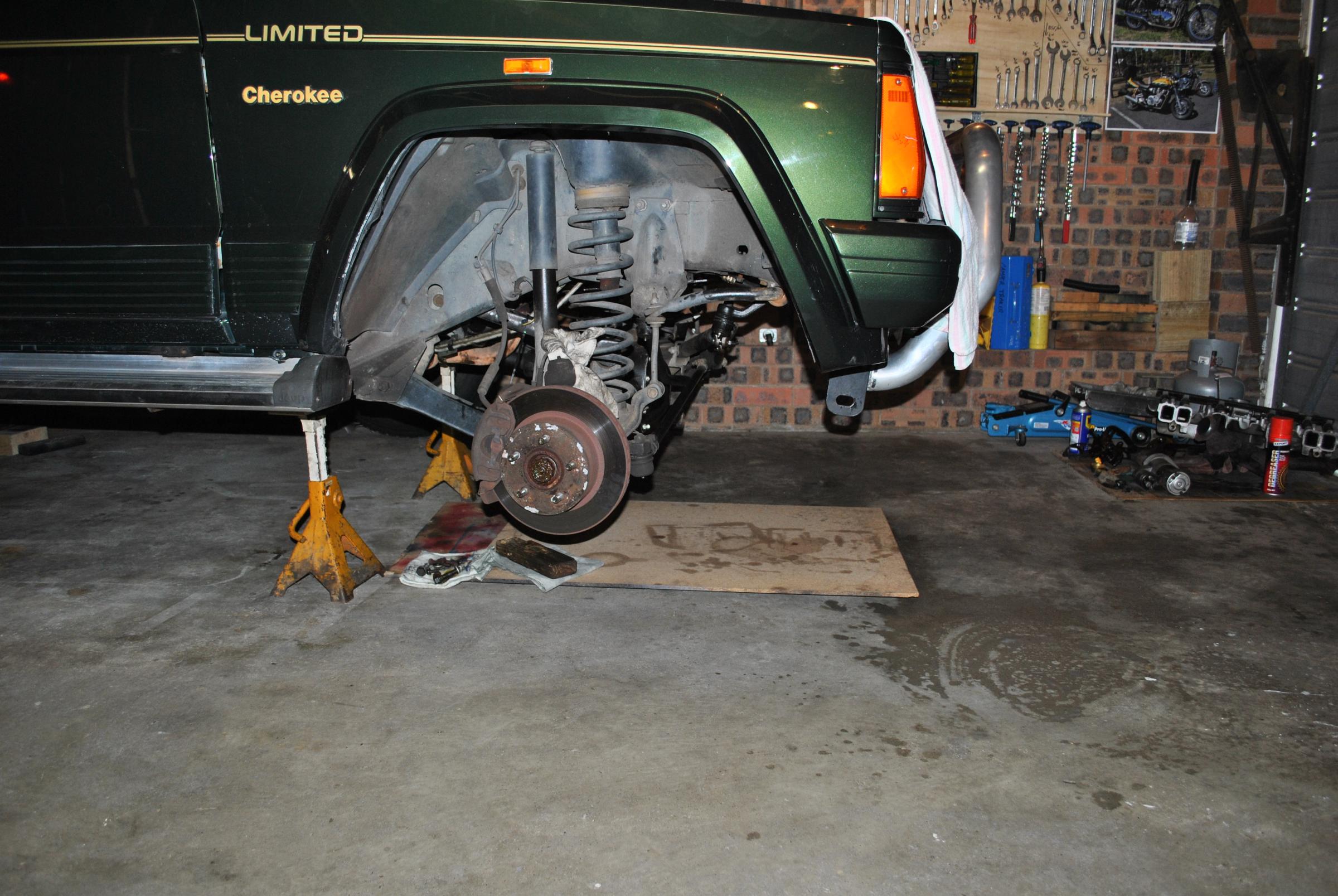

The small blue jack in some of the pics is a 1600kg job, I used it from 1990 until about 4 months ago for lifting every vehicle I have owned.(we put your goose on stands with it the first time) Always did the job easily. Before that I managed with a really old 1 tonne bottle jack for about 7 years before I had the funds to buy a trolley jack(stopped spending it all on going out and jet ski's/motorcycles) I did borrow a 3 tonne once for dragging the tranny from under my Jeep because it could take a transmission bracket with safety chains.
I only bought my 2.5 tonne recently since old faithful sprung a leak. I still use it to get blocks under the wheels to get the car high enough for the big jack.
A good set of ramps and 4 stands is all will should ever need for most jobs. Checking the car is sitting solid on the stands before going under is the most important.
Like Doug said, you are not lifting the whole car with it. But if you have room to store a big one they are good to have. But a 1.5 is not a bad starting point. And when you have restricted work space like I had before reclaiming the other half of my garage the small jack is worth it's weight in gold with the short handle.
Whats the minimum size trolley jack you can use for the XJS?-dsc_1100.jpgWhats the minimum size trolley jack you can use for the XJS?-dsc_2448.jpgWhats the minimum size trolley jack you can use for the XJS?-dsc_2458.jpgWhats the minimum size trolley jack you can use for the XJS?-dsc_9619.jpgWhats the minimum size trolley jack you can use for the XJS?-dsc_2063.jpgWhats the minimum size trolley jack you can use for the XJS?-dsc_2069.jpgWhats the minimum size trolley jack you can use for the XJS?-dsc_2070.jpgWhats the minimum size trolley jack you can use for the XJS?-dsc_8911.jpgWhats the minimum size trolley jack you can use for the XJS?-dsc_8957.jpg
