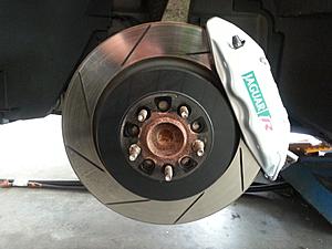

If you want a cheap/easy bolt-on Brembo solution then the front brakes from a 2003-2005 XJR or S-Type R will fit. 4-piston, slightly bigger 365mm rotors
You need to swap the vertical link / knuckle over from the XJR/STR, but aside from that it's more or less a straight swap.

^^^^^^ Won't help me, I have the 380mm brakes already.

Originally Posted by Cee Jay
^^^^^^ Won't help me, I have the 385mm brakes already.
Well I wasn't talking to you specifically The OP has an XK with 355mm fronts.
And actually your fronts are 380mm, if we are going to be precise.
