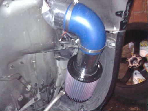

The filter system is from Mina Galleries and this picture represents what it looks like with one feeding the left and the other feeding the right. The MAF sensors that I installed were Jaguar OEM. Thanks for your interest. Ron

In your mina intake setup were is maf positioned
? Is it in the same tube as oem or is
it now sitting in a wider tube? If its the later that will screw up the readings
I think that is the situation which will hopefully be resolved by installing a stock system. Thanks, Ron
There is nothing wrong with aftermarket systems but when you mess with maf housing tubing diameter by enlarging it , that will cause ecu to read less air than is actually what maf is scaled for.
