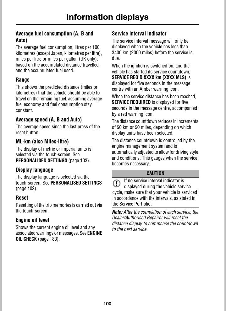

Got a service required message today in the center of my dash. Two years ago and 2,000 miles ago I had all the fluids replaced, oil and filter air filters, brake fluid replaced, power steering fluid flushed. So why am I getting a service engine message? Do I really need to change my oil and filter after 2,000 miles? The message is amber so far. Owners manual says it will turn red after 2000 more miles. I could understand it if I had 8,000 miles since the last service but 2,000 miles!! So what am I to do? I'll call the dealer next week and ask them. Should be interesting.

The service required message is based on miles, and lights up when there's less than 2,000 miles to go before the next service is due. Some services should be done at specific time intervals, such as brake fluid changes every 2 years.

My Service Required light comes on every year, one year after I reset it. Therefore I do service every year.

A hard reset does NOT reset the counter.
This is not a difficult thing to do, once you practice a few times.
The Service reminder will display one year after last reset, or at a specific mileage if less than one year, I can't remember the figure.
