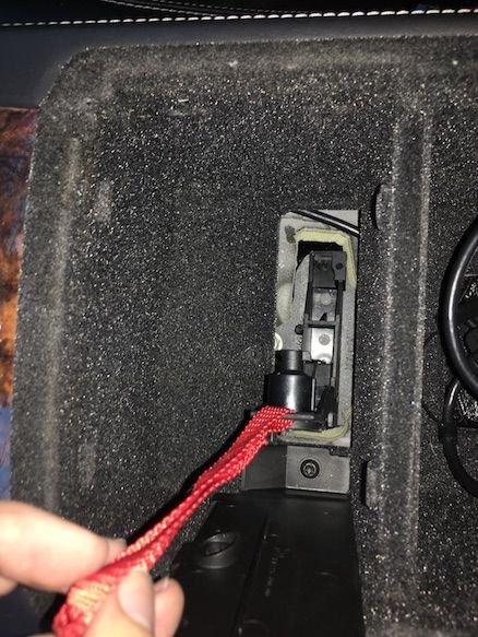

So I pulled the lever! Luckily I never leave home without my T-20 Torx bit and ratchet set, because God knows how many times I've been stuck in the wilderness with freezing toes thinking, "If only I had a T-20 Torx bit and ratchet set with me." Jaguar thoughtfully picked just such a screw to secure the panel under the cupholder--yes, the one you're only going to need in an emergency. My advice: take that screw out and throw it away--unless you really do carry around a T-20 Torx bit and ratchet set. Beyond that, the big orange strap was hard to miss and the lever came up easily and gently. It secured itself in an upright position and the car was free to roll. After I pushed it out of the garage, the lever was easy to push back into place, firmly and securely.

With all the hype about the T-20, I surely thought I'd see a picture of where it is, at least.

CeeJay, My first thought was to photojournal the whole, overdramatized story, but I spared you the pain! Here's a shameless pic of the beloved T-20.
Amen to that. It's going to happen to nearly all of us sooner or later so go ahead and take that bolt out now, or replace it with a phillips head. These cars will not allow you to electronically shift the transmission into neutral without the engine running so even with a healthy battery, a roadside emergency can still require you to pull the cord to allow the car to be moved. Ask me how I know!
