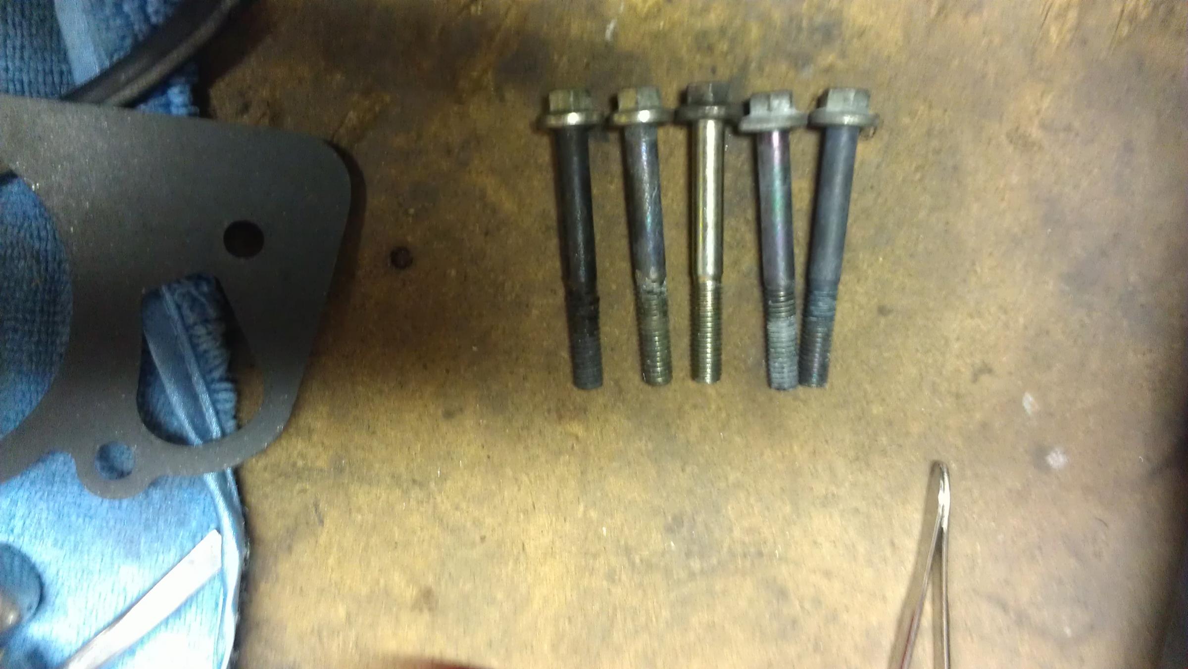

Ok I am doing my water pump on my car. The old pump has a metal gasket with the center portion having a rubber insert, if you look close at the pump a portion of the center rubber stuff on the old pump is GONE, prob my leak once under pressure.
My concern is the new pump. Looking at the new pump there is no rubber anything on the middle. Just the pump and the paper gasket, wont it LEAK with no rubber part there? Can I use some type of light tacky stuff to hold the gasket to the pump for installation. As most know it is tight quarters to work in there. Would be nice it the gasket stayed in place.
Also the bolts I pull out came out fine but all but one is discolored on the non threaded part. The color in the pics is hard to see but they are colored like chrome pipes on a motor cycle, that rainbow color right out of the motor. Does that mean they are weaker and should be replaced? Where could I find these types of bolts, hardware stores???
I have posted pics of what it all looks like.
On the front of the car where the rubber part of the old pump sat IN the opening, part of that orig gasket is on the inside of that opening. Do I need to clean it? There will not longer by any kind of seal there with the new pump, just the gasket for the facing of the pump.
Should I find the ORIG type of pump with this rubber set up on it?????

Well I do not like the newer pump set up so I got an ACDELCO version of the orig pump, just 50 bucks and comes with orig set up parts.

Yea it looks just like the one pulled from my car. Looking at my rubber oring and the rubber part around there mine was 1/4 tore up, pretty sure it was letting water get by it and until recently when I saw it dribbling down the front of the motor it was just burning off slowly.

Small note, these metal impeller pumps require a coolant with cavitation inhibitors, which the standard jaguar OAT one doesn't have (and doesn't need for the stock plastic impellers).
Not sure when issues can popup, I guess that will probably only be in the long run, so you may want to check the impellers out later.
I would just stick with the oem pump with plastic impellers!
