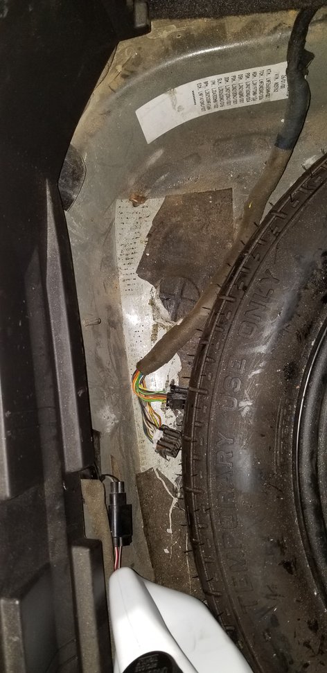

I live in Canada and own a 2000 XKR. I'm having an issue with reading codes and finding parts for it. The ABS light is on and the info centre is showing Trac not available, ASC not available and a Suspension Fault. I've tried to pull the codes but I'm getting a *1000 error(sorry, I don't remember the beginning letter of the error). Starting with the ABS issue, while driving or during a test I do not hear the pump coming on so I'm sure it's the module but again, I can't get the code. As far as the suspension fault goes, while driving the suspension is very stiff. I've found the module in the trunk that controls the shocks but there seems to be a part missing in the trunk due to the connectors I've found that seem would connect to another module or part. I have included pictures. Also, I know when you open the door the window goes down slightly then goes up when the door closes. Sometimes it goes down but not back up, what should i look for that controls this system so I can fix it. Another question I have is where to get parts for this car, preferably in Canada other than from the dealer I.e. modules, relays, window clips, door panel clips, aftermarket tail lights etc. Sorry for the long post but any information would be much appreciated.
Connector in trunk left side towards the back

I've got the windows reset and working properly now. I just cleaned both wheel sensors and I'm getting the same warnings. No change. I also can't seem to figure out the suspension fault. I've checked the wires going to the front shocks, they look fine. I'm not sure what to check in the rear. Also, in the picture I included of the harness in the trunk, is there something supposed to be plugged in?
