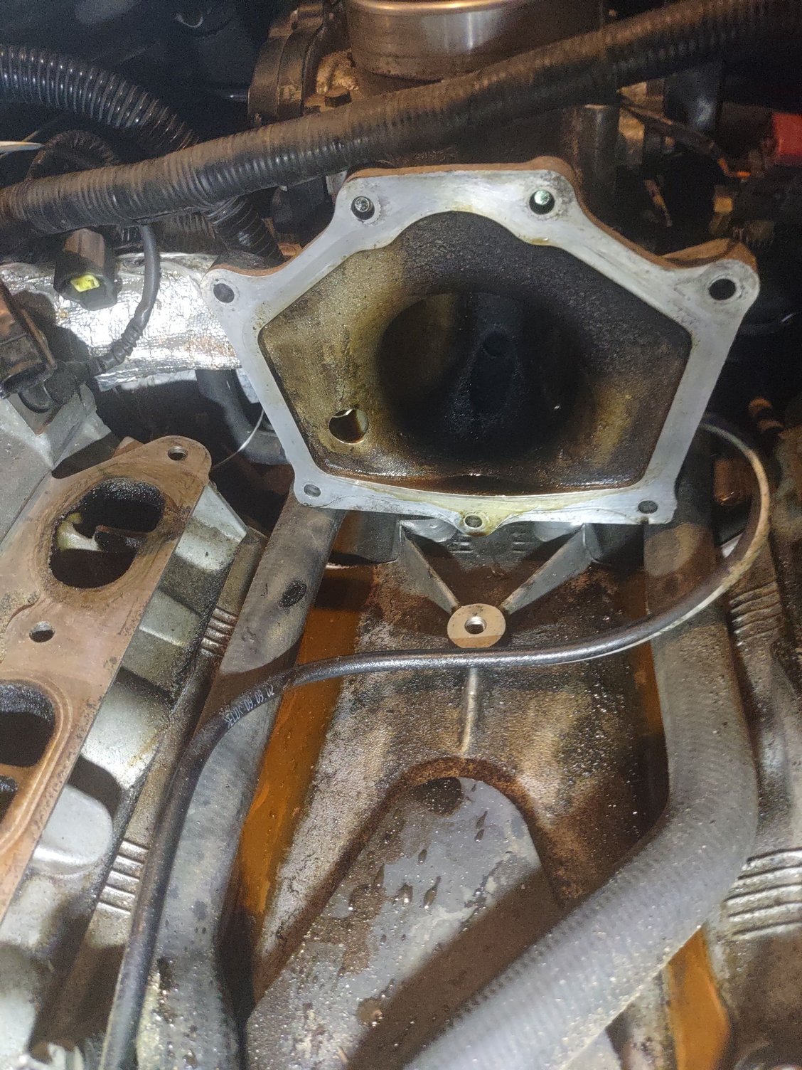

Cleaning the area some and leaving it ready for tomorrow. Hopefully I can find everything I need to put back together.

Nice job of getting that all cleaned up in a short period of time. Finding everything you need to put it back together will be a challenge but you are up to it from what I see.
Don't forget to clean the bottom of the knock sensors, they don't like getting wet.

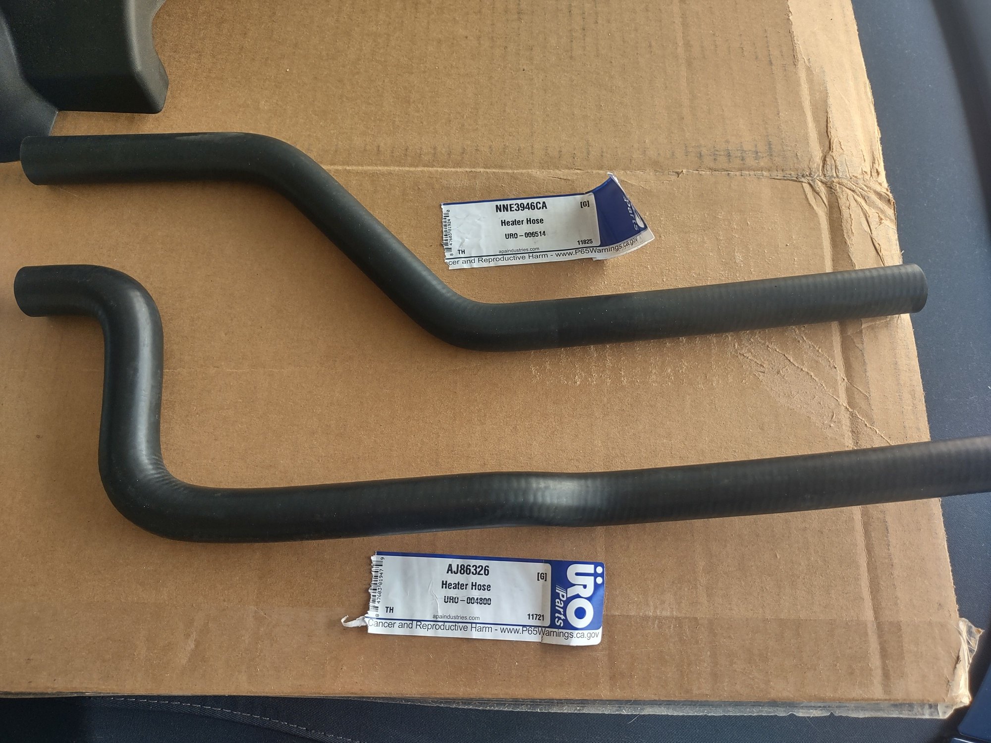

I already have one of the hoses and the intake manifold gasket set. The other hose i should be picking up by 10:30am. Hopefully the JagRag will be running again Thursday night. Plan to drive it to work Friday and to the Gathering of the Jaguars at the NC Zoo on Saturday.

Got hoses in place already & gaskets

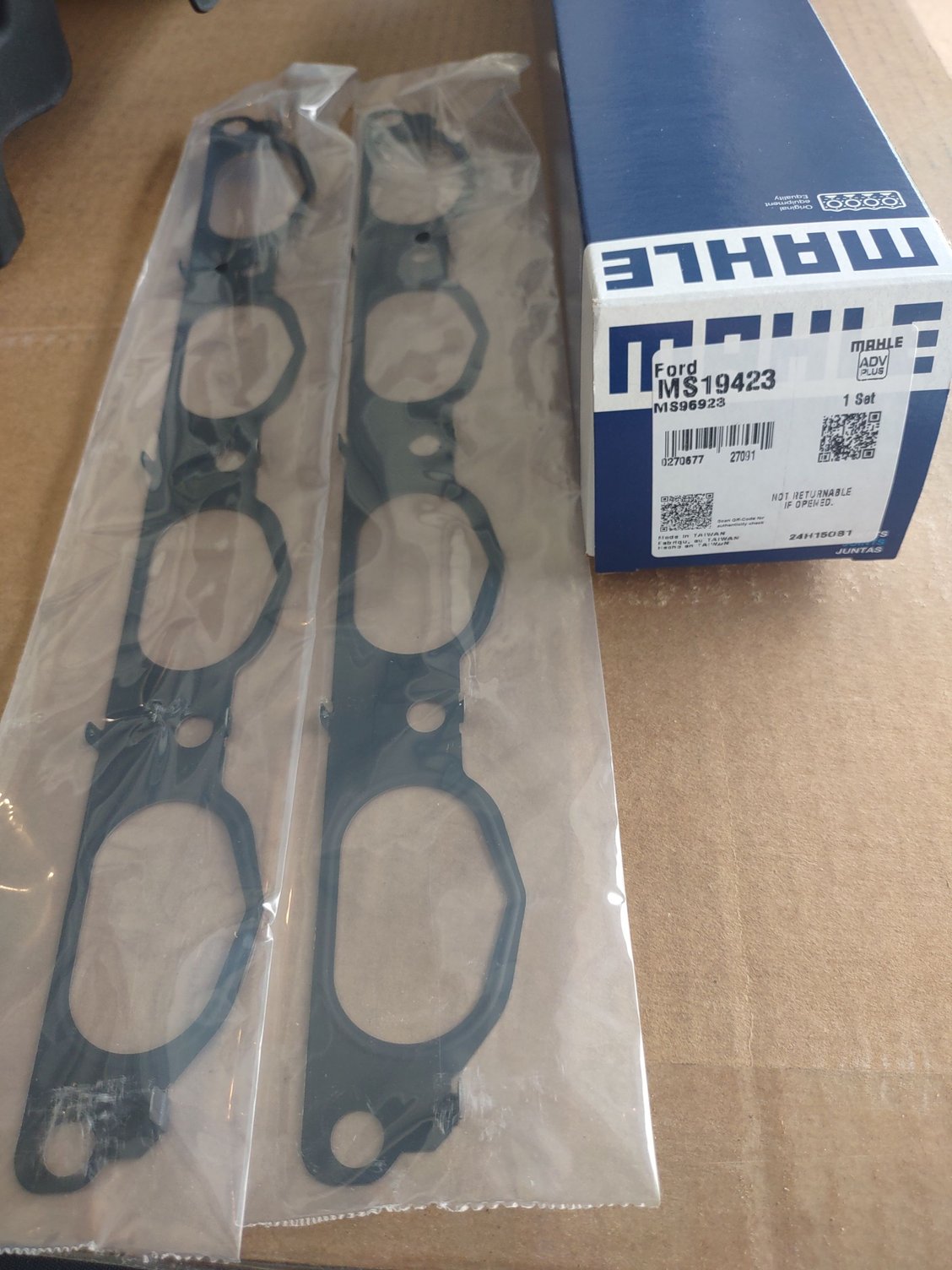

I finally finished. Had problems with the manifold bolts and the threads on the head. If you ever do this job make sure to clean the threads on the bolts and head. I almost damage the threads on one bolt hole.
Only use this type of gaskets, they clamp to the manifold, there is no way to line up a loose gasket like the one felpro makes for our car.
