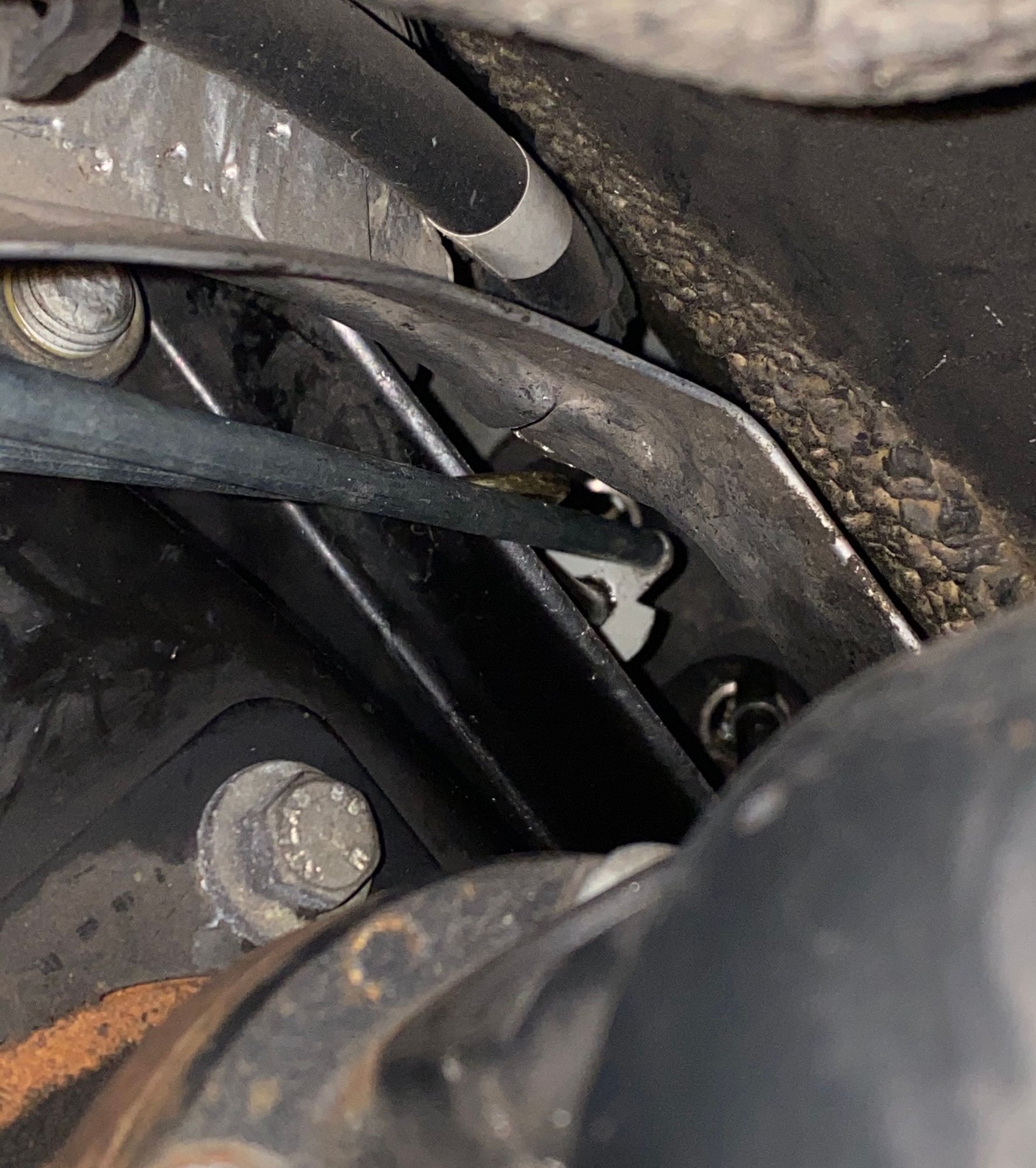

I tried to get the fuel lines out of the bottom of the fuel tank with a long screw driver and a quick-disconnect tool for a couple of days and I, personally, could not get them out. I could not get a good enough grip on the fuel lines to pull them out while still holding the disconnect tool in.
I ordered Robert Krause's XK8 Fuel Line tools ( XK8 Fuel Line Removal Tool for Replacing Fuel Pumps ) for the job and then I got both lines off in maybe 15 minutes. I did use a carpet knife to cut a slightly bigger V into the plastic disconnector tho first to help get it onto the lines. Expensive, but would recommend. Reconnecting took maybe a minute, tops, with the reconnect tool, tho I suspect that part may not have been hard anyway.

Well done. Wayne (cjd777) and I can certainly relate to battling those two fuel line disconnects underneath the car....

Well done. It is a PITA to get those fuel lines on and off.

When I replaced my fuel pump I dropped the rear suspension out of the car for access to the fuel lines at the bottom of the tank. I was afraid that if I didn't do this, something might go horribly wrong with disconnecting or reconnecting those fuel lines due to poor access. Dropping the rear suspension really wasn't a big deal, it's just bolts. I did find that I needed to get the horizontal bolts started before installing the vertical bolts.
