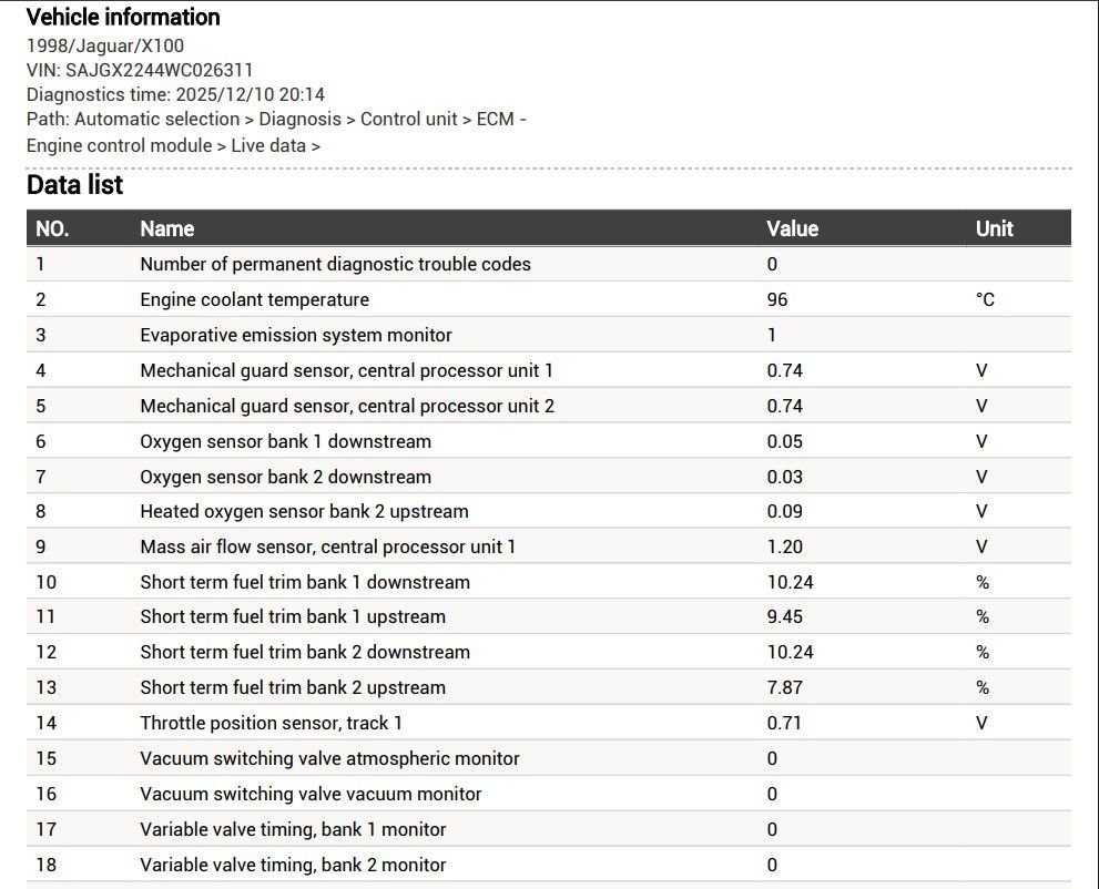

Old Dec 10, 2025 | 09:09 PM
reelthing's Avatar
Joined: Jul 2025
Posts: 27
Likes: 9
Quickshot
Quick snap shot
Old Dec 11, 2025 | 03:05 AM
dibbit's Avatar
Joined: Oct 2010
Posts: 2,063
Likes: 1,024
From: Spain
That shows around 20% extra fuel on both banks (slightly worse on Bank 1), so presumably in some conditions it hits 25% and the car can't add any more fuel hence the lean condition.
Try cleaning the MAF and look for an air leak.

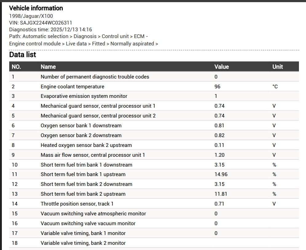

Old Dec 13, 2025 | 03:12 PM
reelthing's Avatar
Joined: Jul 2025
Posts: 27
Likes: 9
ok after a maf cleaning and all air flow paths checked for leaks nothing found - it is 10-15f warmer
than when the last test was ran - this is right after a rather sprited drive she's run great

What scan tool are you using? The way it has labelled those trim values isn't correct, which makes me wonder what else is incorrect on the live data. A cheap OBD dongle and the Torque app gives better information than that - it's hard to get a good picture of what is happening from your print out, but it looks like the O2 sensors have changed values a lot as well as the trims (or is that just because of the snapshot?).

it's a autel maxiap ap200 bluetooth dongle - after some further reading here I did the
test held it steady at 2000rpm watching live data and all the trims went to > 5%
back to idle and the 2 "upstream" (long term i assume) move 17 to 18% saying
I have a vacuum leak - looked and felt over the plastic accord pipe best I could
but a crack maybe hiding in the ridges - think about a Mina aluminum replacement
with heat shielding.
Old Dec 17, 2025 | 07:05 AM
dibbit's Avatar
Joined: Oct 2010
Posts: 2,063
Likes: 1,024
From: Spain
That could certainly explain it - as the intake pipe flexes cracks open and close.
Let us know how you get on.
