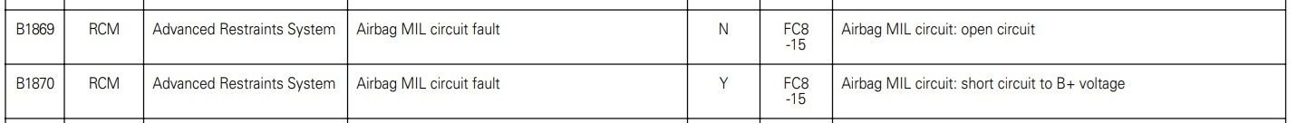

Old May 17, 2024 | 04:21 PM
astromorg's Avatar
Joined: Feb 2012
Posts: 1,114
Likes: 567
From: Portsmouth, England
There are at least two ARS faults that have no flash code - one when the light won't come on and one when it won't go out!
B1870 might be the one for you? The right scanner would confirm or deny that. My AutoEnginuity certainly reads the ARS sensors and codes.
