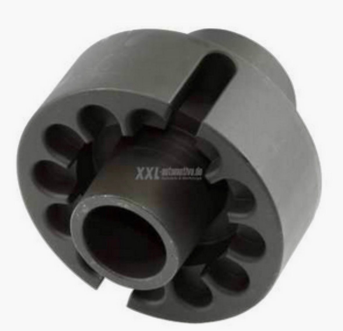

Anyone in the USA have this tool I can borrow. I値l pay for shipping it to me,

And I値l ship it back when finished. And I値l send you $20 for letting me use it.
this is a tool for removing/installing an ABS reluctor ring on my 2003 XKR. I don稚 want to buy one because they cost over $150.00 and I plan to use it exactly once.
Also, does anyone know if the reluctor rings on a 2003 XKR are regular threads, or reverse threaded?

Are you a JCNA member? They have a tool loan program. @Coventry Foundation does as well

I bought one years ago, not sure where it is but I'll search today. Others have used a twelve point socket; try doing a search of the forum to determine the size.

My zip code is 42240. If you are able to find it, and are willing to send it to me, I値l pm you my address. I値l send the shipping fee to you in advance via Apple Pay or Venmo.
I値l return the tool to you as soon as my new reluctor ring is installed. I致e already ordered the ring.

Thank you for the info. It痴 much appreciated. I値l look into the clubs you致e mentioned. We don稚 have a JCNA here in Kentucky. The nearest to me seems to be St Louis, MO. But that痴 not too terribly far away.

Be aware that the tool needs to be modified if it is the older version.

The 30mm or 2 inch socket RJ noted was ground flat on end and probably Deep Well with 1/2 or 3/4 drive and Impact Tool..

Found it, sending PM
