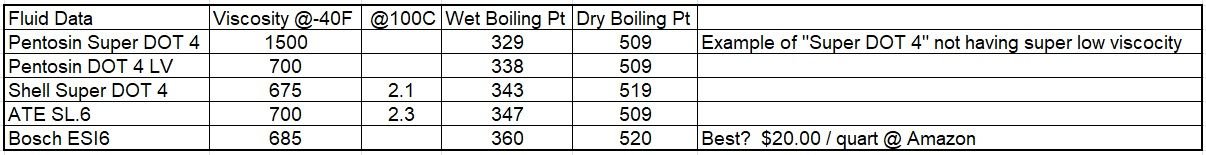

Hopefully this is non-controversial: Notes for my 2002 XK8 Convertible.
Short version: I use Bosch EI6 - Change every two years per Jaguar service interval. Requires ~ 2 quarts.
Here's why I use the Bosch fluid:
From the manual: Jaguar Super DOT 4 (ESA-M6C25-A).
The brake hydraulic fluid in the master cylinder and brake operating system uses non-mineral polyglycol based brake fluid
with a minimum standard of JAGUAR SUPER DOT 4. ONLY FLUID OF THIS TYPE AND STANDARD MAY BE USED.
Regarding "Super DOT 4":
Unfortunately "Super" can be a marketing word (i.e. not all Super DOT 4 are equal)
Sometimes "Super" refers to boiling point, sometimes viscosity. Jaguar intended the low viscosity version for the ABS
ISO 4925 Class 6 viscosity is the viscosity requirement (i.e. max 750 mm2/s @ -40F)
DOT Fluid Specs
DOT Fluid Specs
Brake Fluid Data
Brake Fluid Data

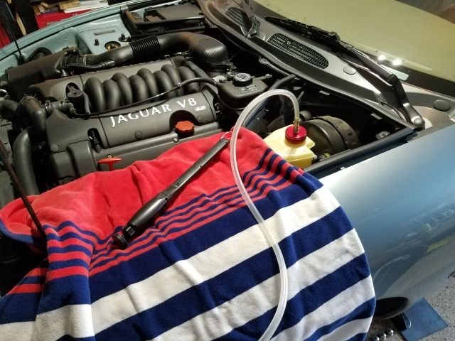

About bleeding: I use a pressure bleeder. In the past (on different vehicles) I've had problems with vacuums, problems with speed bleeders. The pressure system works great! I use gravity bleed on E-Types and XJ-S.
I do not use the pressure system to pull in new fluid from the pressure bleeder. I simply refill when the reservoir gets low. I do this to avoid any possibility of fluid splash / spray.
I empty the reservoir with a turkey baster, than fill with fresh fluid, then pressurize the system to ~6-8 psi

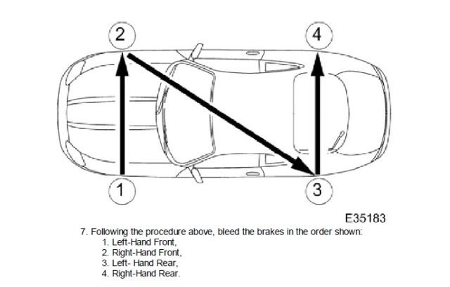

The bleed sequence is reverse of expected: Front Left first - see picture.
Reverse sequence?
Reverse sequence?

Pressure bleeder
Pressure bleeder
Showing bleed cap (cant find model #) it fits X350 and X400 also.
Showing bleed cap (can't find model #) it fits X350 and X400 also.

I needed 1.8 quarts to be totally convinced everything was changed. Call it 2 quarts. I think 1 quart might be not quite enough.
