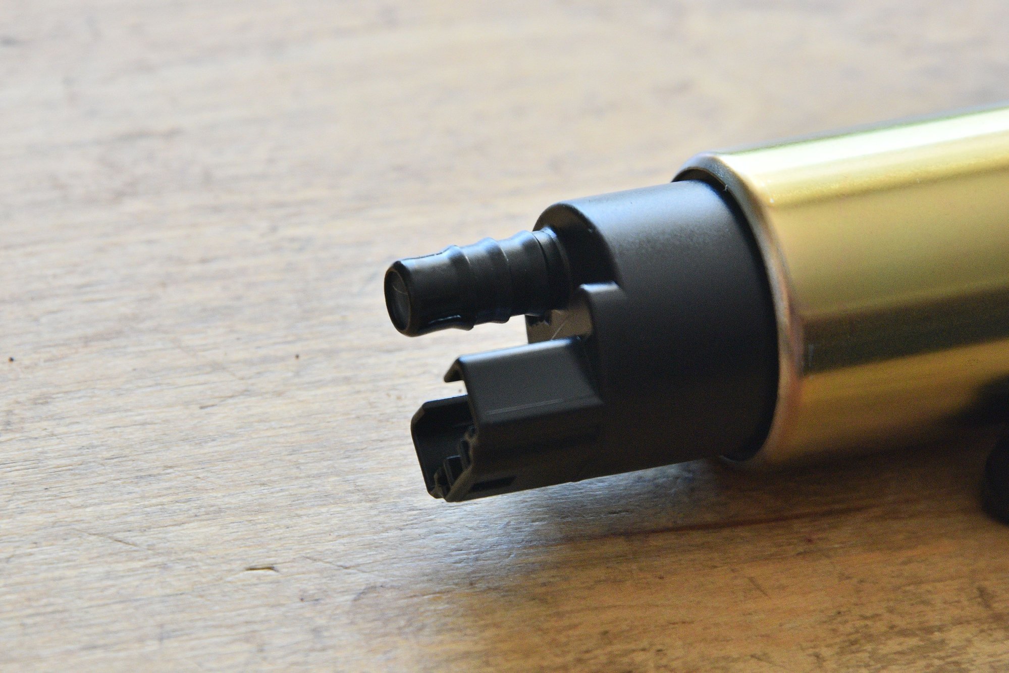

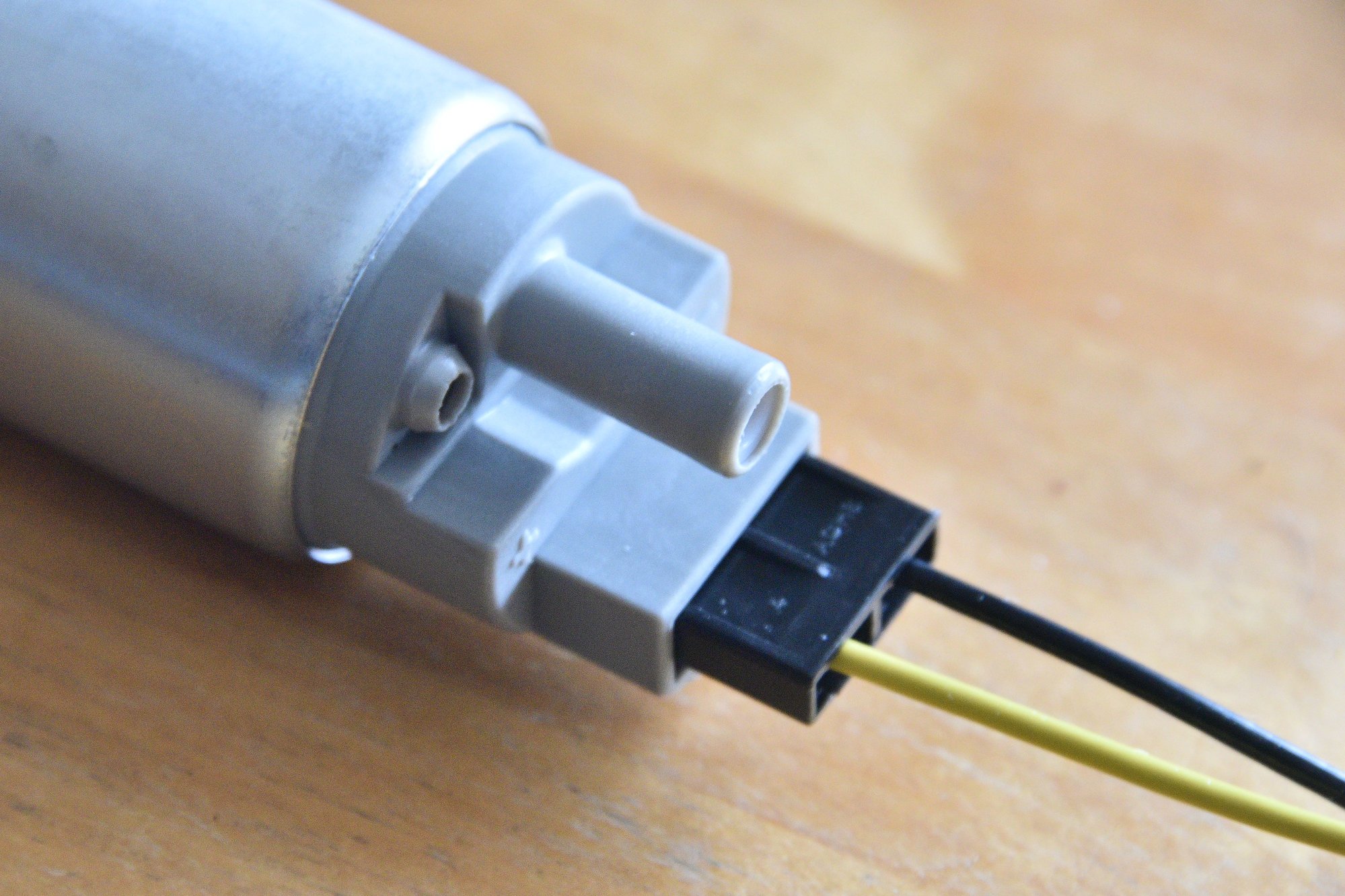

Purchased this pump "Trust Lucas" but the outlet does not have any barbs on it to hold the pipe at 45 psi
Anyone seen the original (1997) . Dont have the original out yet .

I was not happy so I sent it back and bought one with grips on the outlet to bite into the pipe .
Strange it was half the price of the one I sent back at £12 about $15.

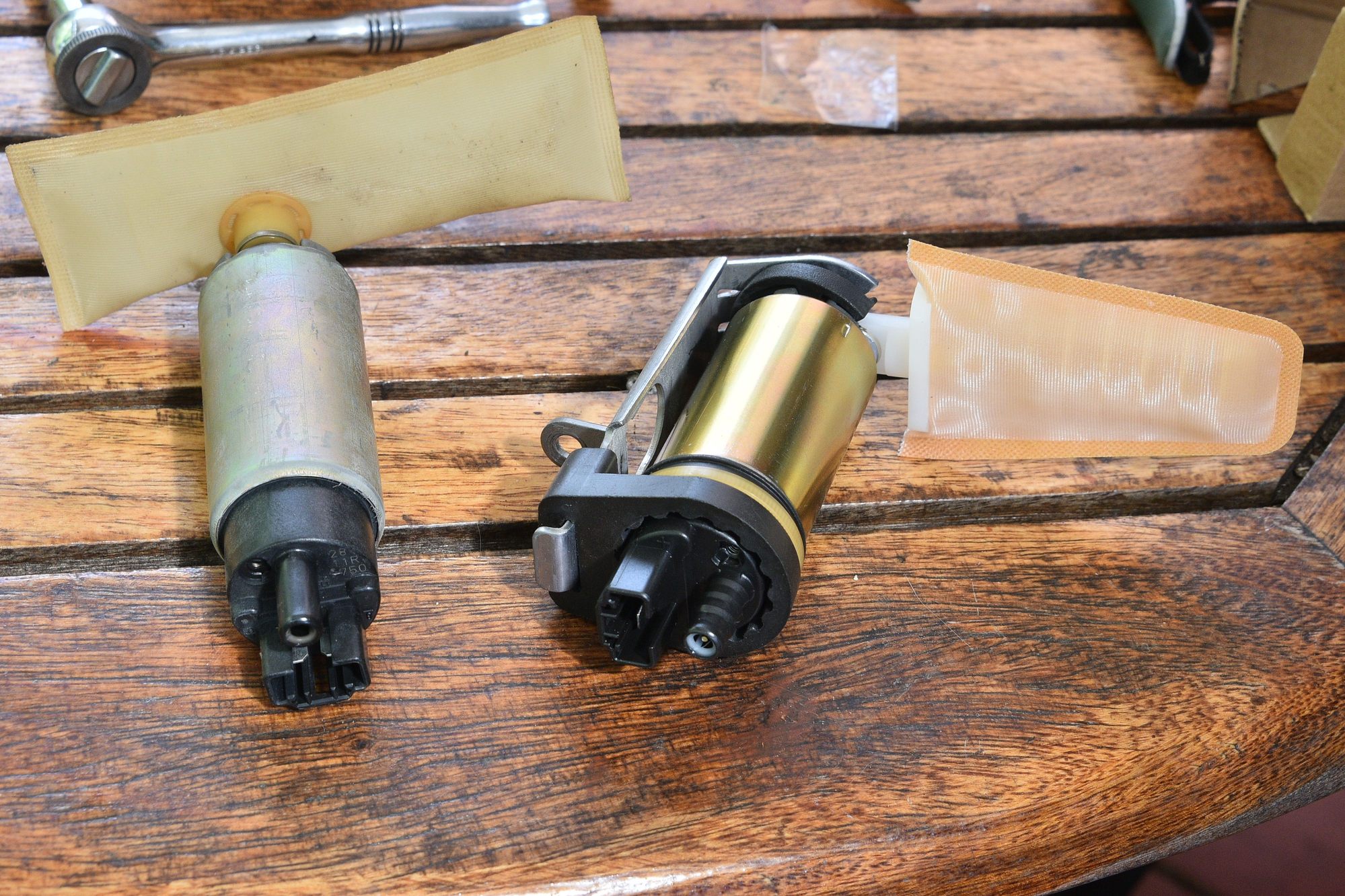

New $15 pump with correct barbed outlet .
Old Jul 9, 2022 | 01:50 AM
Pistnbroke's Avatar
Joined: Mar 2021
Posts: 2,147
Likes: 897
From: Northampton, UK
Well got the pump changed .will do a seperate post on that ..but supprised to find that the old one did not have the brass connector but was plain like the one I sent back. May have been changed previously but no markings other than Denso. Photo below ..all fitted and started first flick of the key.
left old right new
