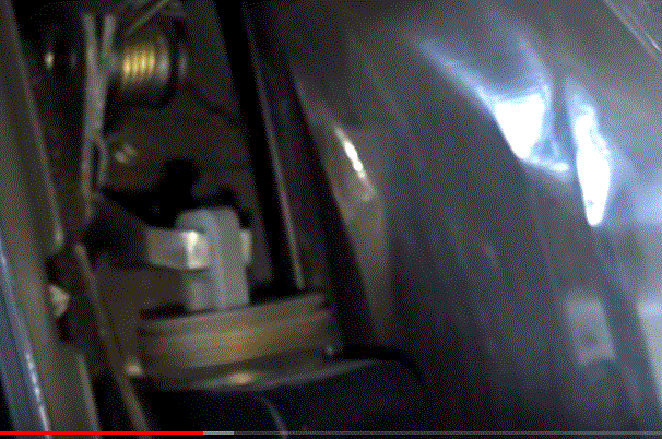

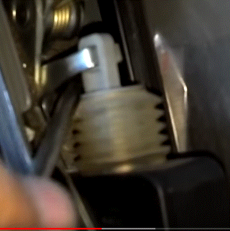

Essentially the chap uses a screwdriver to move the actuator. I'll see if I can grab a screenshot.
stuck in down position:
using long screwdriver to lift the actuator arm
actuator in up (unlocked) position
in his case there was a broken piece of plastic (surprise surprise) stopping the actuator from lifting freely

Mike, that is really handy. Thanks. We will be having a look at this tomorrow. I believe there is some kind of plastic cover over the latch motor. Presumably we will need to remove - ie break this off - to get at the actuator?

Rev. Sam spoke about some form of shield over the mechanism which may be what you've encountered? I think he didn't bother replacing it.

The shield comes off by prying some plastic **** up inside with a screwdriver. Don't think you can get to them without removing the latch from the door.
What ever it takes to break it in pieces will be the correct procedure. Sorry for your problem. The above my help you get the door open, I hope so.
Can you see if the cable is having any effect on the door cam. If the cable is broken, which I can not believe, a whole different story.
Good luck in the morning.

Resolved, using the techniques given in this thread. Rather than use a screwdriver, though, we raised the deadlock bolt using a strong metal strip with a notch cut near the end. This worked as an effective hook. We removed the actuator and refitted everything (and will put the new unit in when it arrives - can’t lock the door right now) so really happy to be on the road again, and so quickly.
