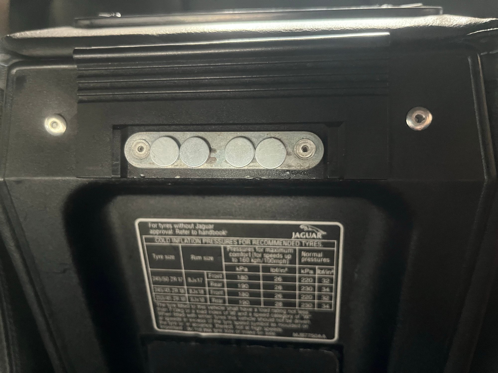

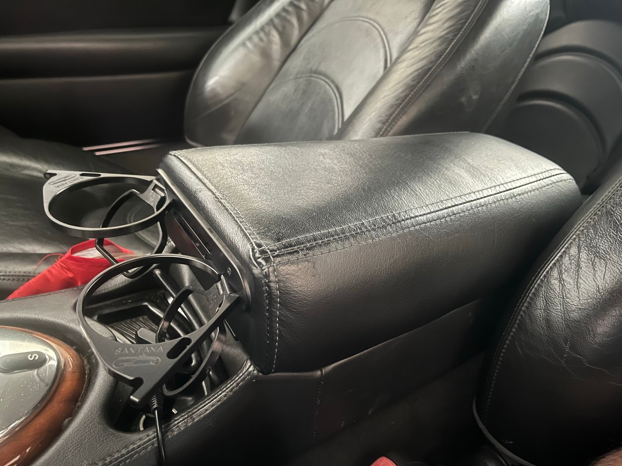

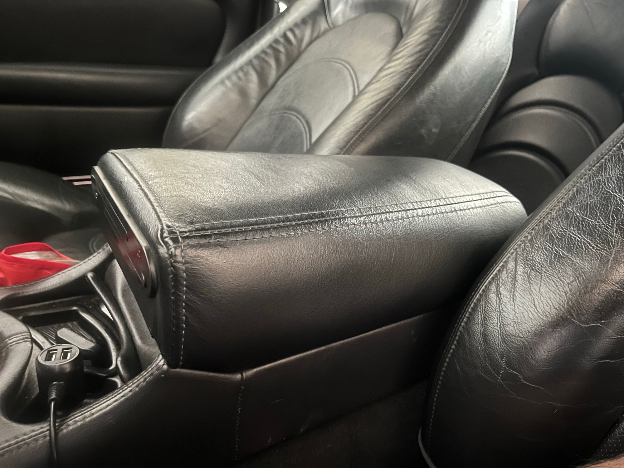

The first is the armrest. I've always detested the solution Jaguar came up with for the cup-holder and latch problem. Concerning the cup holder. It's fragile and breaks easily. Even when it's working as intended, it doesn't hold any drinks effectively. As for the armrest latch, they had a much more elegant and reliable solution in the late 80s and early 90s with the I think XJ40's armrest. A magnetic latch. The good news is that the parts are compatible with our cars. You only need the magnetic latch and the XJ40 armrest. My cupholder had broken a year or two ago, which prompted me to remove the mechanism from my armrest because it was annoyingly noisy while driving. Especially if you put your arm on the armrest near the cupholders.
Then I found a unicorn on eBay. An XJ40-style magnetic armrest that had been modified with metal cupholders that hide inside the armrest. That solves both problems. I no longer have to deal with drinks that fly into the backseat as I accelerate, nor do I have to put up with the noisy armrest. I did find that this modified armrest does have one issue. The leather at the corner is folded in such a way that the magnets don't contact each other to provide "latching" action. No problem, I added some smaller magnets I had lying around. Eventually, I plan to remove those rivets and add some washers to shim the metal bar just enough to allow the magnets to contact each other without the auxiliary magnets.

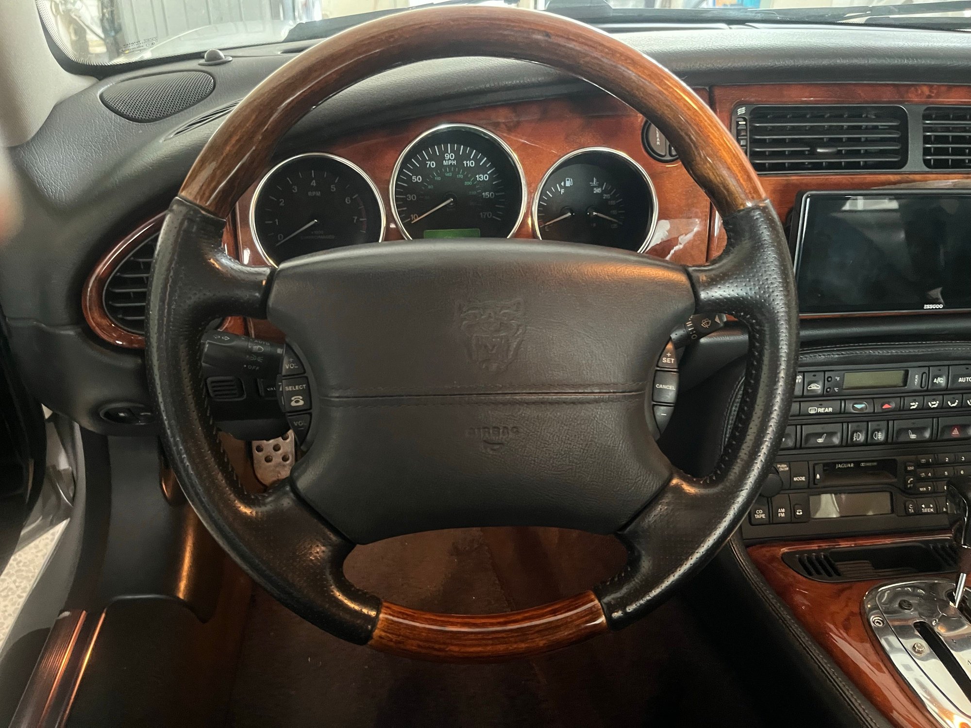

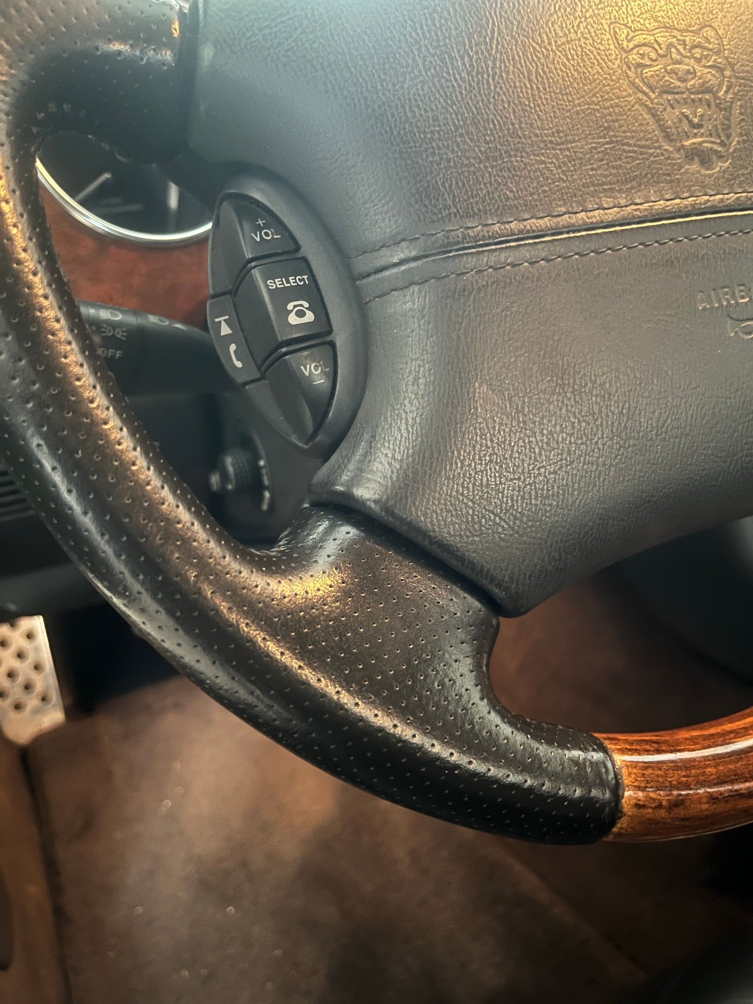

My other issue was my steering wheel. The original steering wheel suffered at the hands of the COVID pandemic. All that constant use of hand sanitizer wrought havoc on the leather. It wore away the protective coating and then the leather itself until it started falling off. I was driving around with a late-stage cancerous steering wheel. Graciously, fellow forum member Sam sent me his old steering wheel, which was originally cashmere colored, and he had painted it over with a wine red color. I was able to strip out the red back to the cashmere, and over that, I painted it in black. The color wasn't a match for my charcoal interior, but it served its purpose. It seems I laid the paint a little too thick. Over time, the leather cracked, but also the stitching was coming undone.
Well, it was serendipity that the same night I found the armrest on eBay, I also found a perforated leather and wood steering wheel in charcoal, which does match my interior. Since perforated leather wood steering wheels are uncommon, I didn't waste any time and bought that too. It is surprisingly a huge upgrade over my previous two steering wheels. It's pleasant to the touch, and I find that it is a lot less slippery.
Do these two items look out of place in my interior? I find that the armrest, although an upgrade in many ways, is taking some getting used to. My arm sits a bit higher because of it, and it does make the interior feel a tiny bit smaller. Despite that, it's not uncomfortable.

I think I would deal with the cracks in the seat leather before they open up and become impossible to repair.

You're right. What's the best way to do that?

I dig the steering wheel! Looks factory.

It is a factory steering wheel, it's just that I think it's from an XJR or an XJ8. The XKRs that had the perforated leather steering wheels, I think, didn't have any wood on them.

Yeah, I’m going yo have to research that. Ideally I would swap for the ultra rare Recaro seats that the Victory editions came with in order to have more lateral support. I slip and slide so easily out of my stock seats. Having said that, whenever those seats do pop up for sale in eBay, they are priced at a between $1500 and $2000, st which point I would rather spend that money elsewhere.
After researching, it’s possible to apply a leather filler and then dye it to cover the cracks. If it’s too far gone for that, then you would have to re-upholster them.
My front seat leather has always been firm whilst the rarely used rears are supple. I’ve tried many different leather conditioners and have not achieved any results. At least the cracks haven’t progressed at all in the 8 years I’ve owned this car.
What’s a good leather conditioner that I can use to prevent further cracking and soften up the leather?
I figure, if I ever find myself having to re-upholster the seats, I could take that opportunity to add padding to the bolsters to improve lateral support. I do know some companies sell leather replacements for our seats which would make this easier to DIY.

I like the arm rest...a lot. I love the steering wheel...a whole lot!
As for the seats: Seats Restore: Stuff is unreal. I used it on my 01 and have since used it on two other non Jaguars.
This is the only way I've been able to get it:
JAGUAR - CHARCOAL Leather Color TOUCH UP KITS - XJ8/XK8/X-TYPE Models - code LEG | eBay
Give him your interior color code...and splurge for the matte finish second application. Really made a huge difference.

First thing to do is get the leather hydrated. I like Leatherique products for leather recovery and refinishing. It takes time and a lot of rejuvenator oil. If they don't already have the appropriate dye color for you interior, they can color match to a sample. I've done a number of baked out Lotus Esprit interiors with some pretty amazing results.

I will strongly second what “the great garbanzo” stated in #15 above about SeatsRestore. I have used the products and they work great!
Definitely use the low gloss top coat over your filling and coloring. Follow their directions and you should be good.

Agree the SeatsRestore products work very well. There are a lot of before/after pics here along with some DIY advice that is worth looking thru.
