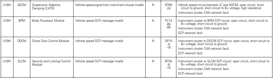

After clearing OBD codes the following recurred:
U1135
U1041
B1595
B2334

Originally Posted by sls-101
U1135 U1041 B1595 B2334
Codes are from the 2003 MY docs, so YMMV. It looks like multiple modules can complain with the same code, so you might have to find out which one did. The immediate concern is the ignition switch, but I don't believe it is a common problem. Instead, it looks like the SCP network is not operating, which prevents the car from authenticating the crypto chip in the key. I would focus on the SLCM and BPM. The letter/number references specific spots on the harness and are documented in the electrical guide. You also need to check the TSBs on jagrepair.com related to the instrument cluster and bad soldering, which is apparently easily fixable with basic soldering skills.
Best of luck, keep us posted.
