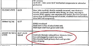

Have a look at the attached picture with some interesting info regarding the 2002 model year 4.0 engines.

Posts: 121,069
Likes: 6,652
You might be on to something there. Strange it doesn't show up in the parts catalogue.

Posts: 121,069
Likes: 6,652
See post #6 here, I guess the answer is to measure the bearing diameter.

BobRoy's Avatar
Joined: Jul 2015
Posts: 1,536
Likes: 790
From: Sacramento, CA
I had the same situation when I need a rod bearing for a 2000 XK8. I ordered the replacement bearing as you did and it was too big. What I discovered was I had 4.2L block. The 4.2L uses the same piston as the 4.0L. The way they get the increased displacement is by lengthening the rod thus they made the rod bearing smaller.
I ordered parts here in CA that came from the warehouse is San Franisco through the local Jaguar dealer. I kept getting the larger bearing for the 4.0L
I got hold of a sales rep from Jaguar of Long Beach in Florida. He ordered it from Jaguar in Britain. After another couple of weeks I finally got the correct bearing.
Check the engine number on the side of the block, it's on the left side towards the back half of the engine, that will confirm that you have a 4.2L.
It's a pain in the rear and will take a bit of time but that is what I went through.
