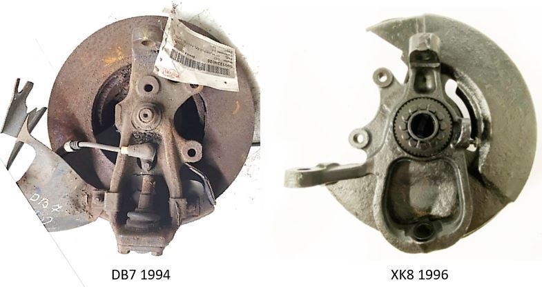

Clearly, neither model was ever going to be 4WD, but it is interesting that;
The X100 steering knuckle uprights are ‘thru-axle’ design which can support mounting of a CV joint.
The DB7 steering knuckle uprights are ‘stub axle’ design which cannot provide mount for a CV joint.
Any design alteration to the uprights was expensive (handed drop-forge tooling) so maybe this is why Jaguar stayed with the available components it had committed to.

Every time I do any work on my front hubs. I look at the design and think how obvious it is that they were designed to take a drive shaft and have often pointed it out to anyone who happens to be in the garage with me.
Unfortunately, this led to the two bearings being positioned such that the force exerted by the weight of the car through the wheel is not distributed optimally through both the bearings and the outer one can wear out far too quickly. Back in the early 2000's, the Jaguar dealer told me that some owners were only getting 20k miles out of them!
I think Jaguar might have beefed up the bearing in later models to give them a reasonable life span.
Although I didn't know it before your post, Aston clearly had the right idea and could see the issue so redesigned the hubs. Thanks.

This is interesting. Aside from the weak wheel bearings in the early cars, are there any other disadvantages to this design from a weight, or suspension geometry perspective? Why did Jaguar ultimately choose to forgo AWD. Could, with enough money being thrown at it, our cars be converted to AWD? Is there any advantage other than tooling costs, of the actual design?

I'm sure that it would not be possible to convert the XK8 to AWD even if you fitted a different engine with drive outputs at the front. There are no parts available such as the shafts etc as these never went into production. I'm sure that the AWD option was never pursued because Jaguar was presumably virtually bankrupt which is why Ford got involved. I believe that it was Ford who decided that Jaguar should proceed with the replacement for the XJS but it had to be a modest cost project rather than continuing with the expensive XJ41 prototype so a cut-down version of the XJ41 was inevitable as there was nothing else in development. Aston proved that it could be done.
If you think about the design, without a shaft on the engine side of the front wheels, all the force from the wheel is being amplified through the hub axle and acting on the bearing from one side only. With a shaft in place, there are forces acting across the width of the entire hub from the wheel on one side and the drive shaft/engine on the other side. Removing the shaft without the redesign that Aston clearly implemented was always going to leave an imbalance in the design.

Ok, this makes sense. However, there’s one thing that is still a mystery to me. The DB7 came out before the XK8 and had the superior knuckle design. Why didn’t Jaguar use Aston’s parts instead?
