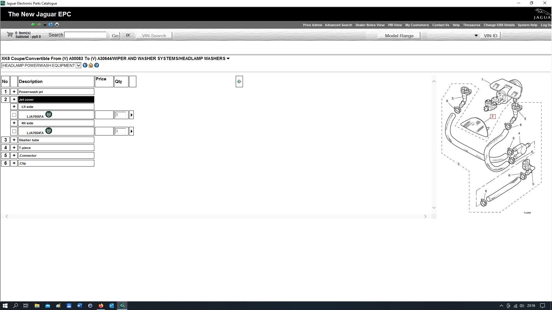

YES - it snaps on. See item 2:

It's a simple ball on the mirror that snaps onto the motor which is held onto the jetwasher unit. GGG gave the schematic diag, and I attach a Pic below of what I have.
Two possibilities, the plastic ball recess in the mirror cover is too big, and just needs filling to help "snap on" or 2. the power washer ball tip is too small and just needs enlarging. Lots of ways to do this - duct tape!
I would also check that the power washer unit is securely fitted to the bottom of the headlamp unit.
